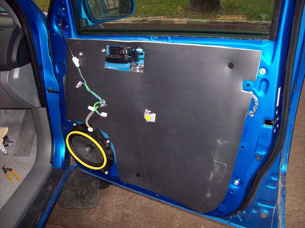

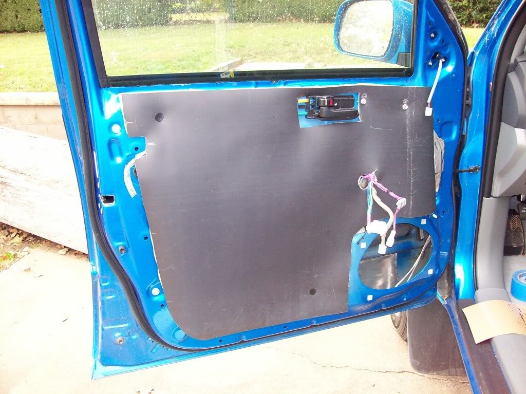

    when I put raamat in my x-runner.
    one roll was enough to do both front and rear doors ( a layer on the outer door skin, and a layer on the inner door skin) and one layer on the back wall.
    Another roll would have done the floor

    Similar for me. One roll for all four doors, inside and out, and 1/2 of the back wall.

    QFT. If you add MLV, do what Italyn says. You'll have to trim the MLV alot anyway to make it fit, so just ballpark it w/o taking the door panel off.

    Raammat on the floor, then CCF (or ensolite) to isolate the MLV, then MLV on top. If you put the MLV directly on top of the deadner it's not nearly as affective, if at all.
    On teh doors, do rammaat on the bare door panels, then mlv on top of that on out inside panel. then put ensolite on the backside of the door trim cover to minimize any rattling and buzzing from the mids in your doors.

    I hang it with just a few plastic pop rivets. Drill a small hole in the door (be careful not to hit the window) and pop it in. Easy as cake. It just sort of hangs there. You'll need to trim out some of your door panel I'd imagine. The door panel has little areas that contact the door metal for support. Since you're adding layers you'll need to trim/sand off the amount you're adding for it to sit flush.
    I also used the stock tweeter mounting holes as a way to secure the MLV as well. I figured they were there so why not use them.

    you need about 5 square feet per door, for a single layer, i went double layer in my truck and have three layers over all the holes i sealed. Maybe a little overkill, but i have zero rattles and can crank my speakers as loud as i want to.
