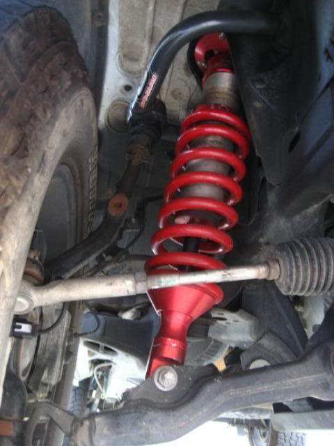

    I have SAW 2.5" coilovers and i love them! I was looking at Icons and Kings but found a great deal on some used SAW's on Racedezert. They ride great and give me about 2.5" of lift. I dont have after market UCA's and my truck rides and tracks great on the street and highway. If you get SAW's you will be happy with them, i dont have any complaints yet.

    I do a bit of everything really, some higher speed roads and trails to some moderate climbing and hills. I dont push it to its limits though by any means, i respect my truck too much. Had i not found the deal on the SAW's i most likely would have saved up for a pair of Kings. I would have gone with King because they have a solid reputation, great customer service (i hear), and because i see alot of people running them so i assume they are pleased with them. Through my research i find that icon, racerunner, king are all so similar you will be fine picking any of them though.

    Not exactly sure how they compare to ICON's, but I picked up these 2.5 SAWS for only $450. My truck is the 3rd Tacoma they've been on, and after DSM rebuilt them they rode great. They're from 2005 but completely blew out my bilstein 5100's and I don't baby these shocks. So they might be 6 years old with a little rust but no big deal, they perform great for the money I spent. A king extended travel shock w/ an external resi and 700# spring will obviously outperform any other coilover with an internal reservoir. That's the difference between spending $500 or $1500
