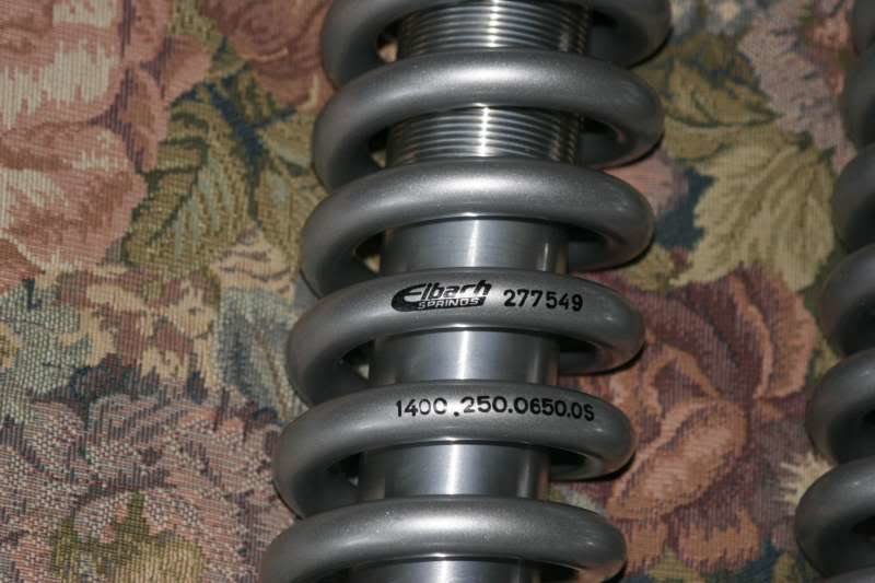

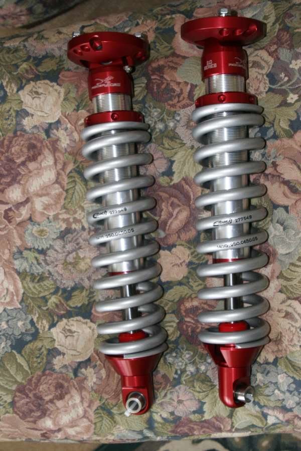

    I have the older red coils that came standard on the older coilovers. They are starting to sag too much and I plan on rebuilding them and replacing the coils soon. Where can I find the newer silver Eibach coils that come on the newer models? I believe they are still a 13"x650lb coil but they might use a different rate spring now. I've emailed swayaway and eibach to no avail.

    I just rebuilt my SAW racerunners on my 2nd gen. I replaced the 13 x 650lb with eibach 14 x 650lb and it worked great. Have way less preload now, you will have to slightly compress the spring to get it on the shock since it is 1" longer.
    I bought my eibach springs from down south motorsports.
