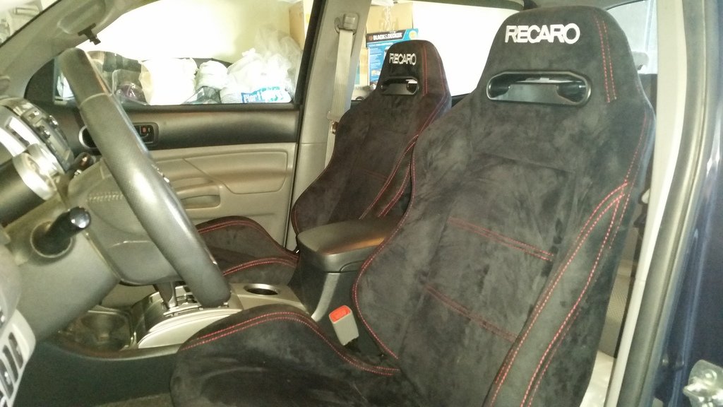

    This pending issue has been resolved and the seats in my truck are in. No SRS airbag light is illuminated and all is well. :thumbsup:

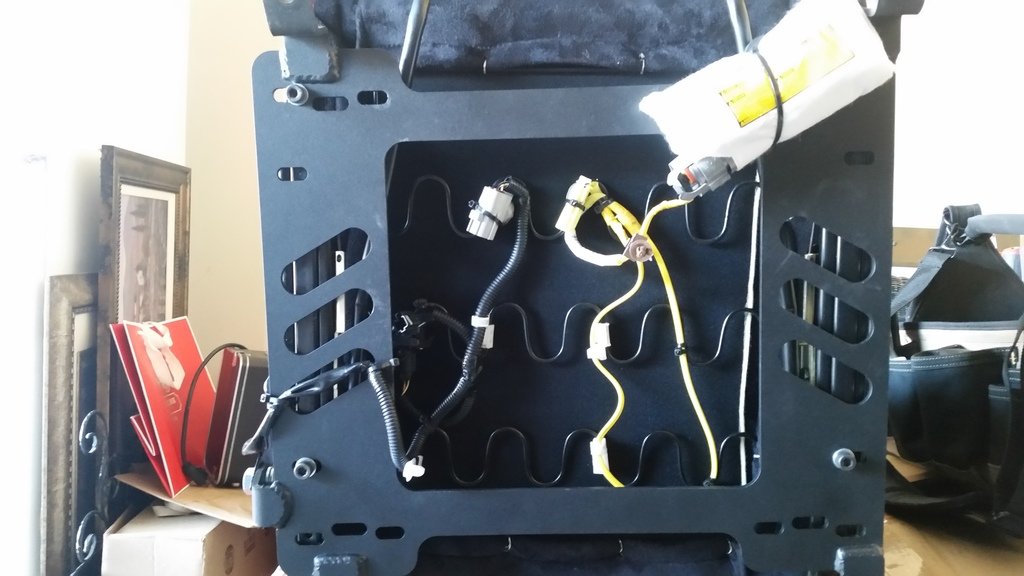

    It's not hard, just time consuming, and make sure you wear some latex or nitrile gloves.
    This project turned my hands into prunes.
    All you have to do is simply remove the airbag wiring and transfer it to the underside of the seat via zip ties and using some of the old clips if you are careful enough to not break them. Transfer them over similar to stock and all will be well.
    If you use the planted brackets you can also bolt up some of the old stuff to the bracket itself.

    I didn't even buy any modules. I just transferred over the old SRS wiring and equipment to under the new seat brackets just like stock and ran it.
    The tough part was making sure that non of the wiring got pulled on as the seat slid back.
    Each seat and wiring took half an afternoon. Two days. The stock seats were weird to pull apart but I was able to get it done no problem with a bit of patience to avoid ripping and tearin gthem apart. I could still run them if I choose to go back to stock one day, but that day will probably never come.
    Day three involved fine tuning and tweaking the wiring and bolt up locations of stuff to make 100% there would be zero issues. They have full range of motion front and back, and everything plugs up as it should.

    This just isn't jiving with my experiences, in that photo of the bottom of your new seat I don't see that you transferred the seat position sensors over to your new seats ? So how did you get away without using the bypass module ? Are you 100% sure that your airbag system is still armed ?

    My concern is making sure it doesn't trip the light on not necessarily bypassing it.
    Also. That shot is of the drivers seat, not the passenger. The position sensor on the driver seat was tied somewhere close to the rail. It's such a small sensor that you can't see it in that shot is all.
