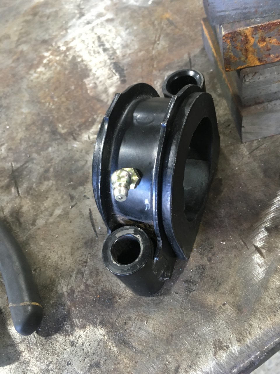

    I went ahead and added a grease zerk. A hole is allready there just drill and tap. Poly is known to be squeaky

    Auto store sells them. There is a pre existing hole that needs to be tapped. Depending on the size of the jerk, you may have to enlarge the tool. I did it because I had them on hand and hole was allready there

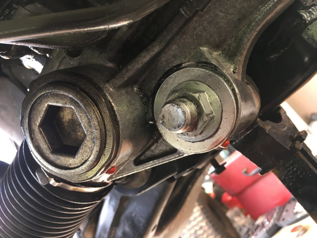

    The bolts that hold the rack into place when reinstalling. There are a few. Zipping is referring to torqueing them down. Others might not tighten to spec but it’s

    Is there a guide for doing this job with a 4WD Tacoma? I'm not finding much info on my own. I already started taking the bushings out, but putting new ones in will be a pain with that bolt in the way.
