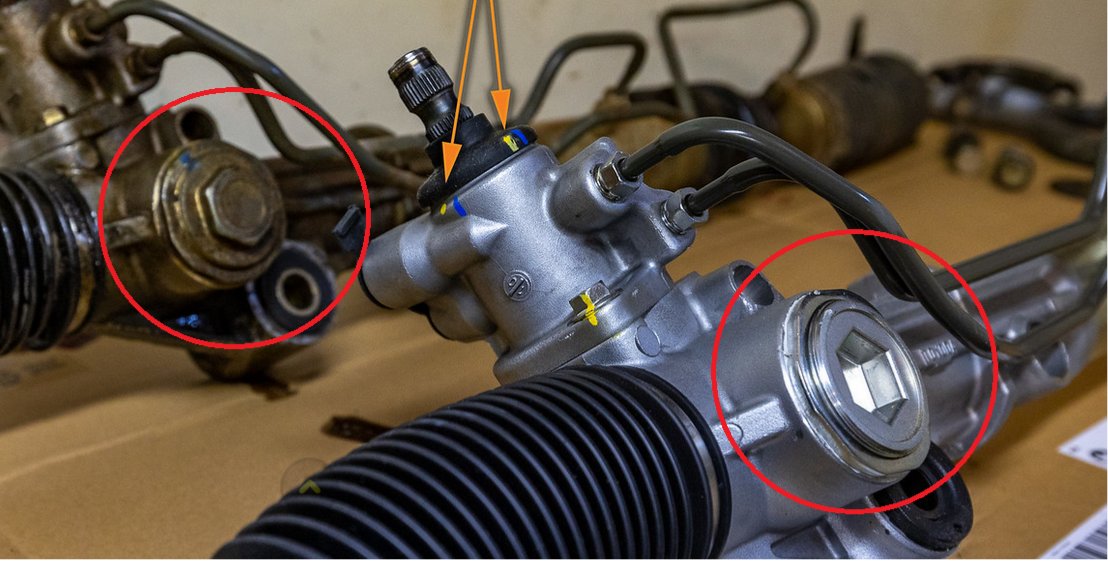

    Not sure why you'd opt for an aftermarket if you had an OEM, sure you had your reasons. The short answer is you can disconnect/slide the rag joint up the steering shaft and move the rack shaft a tooth or two one way or the other, if the wheels are in proper alignment. If they're not, an alignment can take care of it.
    There should be "witness marks" on the top shaft of the steering gear/rack. Can't speak for an aftermarket rack, but I'd think they would have them too. I would start here, make sure they are aligned.
    Before starting any work, get it on jackstands and make sure your steering wheel is dead center - this doesn't mean lock it with a key, as that is almost never perfectly centered. Unlock the column with the key. I used ratchet straps around the steering wheel to the seat frames, both sides, so the wheel is perfectly centered, that sucker's not moving anywhere.
    Crawl under the truck and see if the witness marks are aligned. If they are, this is possibly an alignment issue.
    If not, disconnect the rag joint by the top and bottom pinch bolts (don't separate the joint,) slide it up the steering shaft out of the way. Align the witness marks on the rack, slide the rag joint back down and torque to spec. You may or may not find it easier to twist the wheels one way or the other to align the marks rather than risk damaging the splines by twisting the rack shaft.
    Timmy the Toolman has an excellent video that includes this procedure (below the pic.) I have it linked toward the end of the video, where the owner sees it's not quite centered, but everything in the video is absolute gold.

    Pic below is from this epic thread on replacing a rack.

    Sounds to me like what the OP is saying is that when he turns the wheel to make a turn it stays put unless he turns it back straight himself. I would suspect that the friction adjustment on the rack may be too tight. That would be adjusted by that big nut that I've circled in the pic. I'm fairly sure if that is too tight it places excessive drag on the rack
