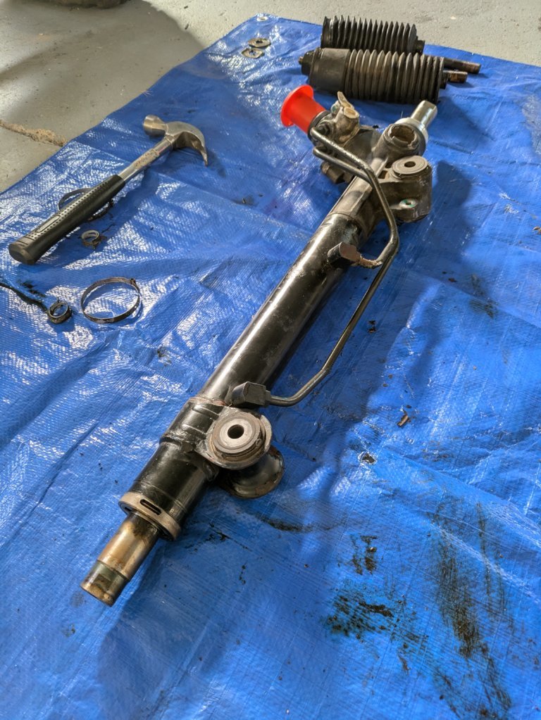

    Owner confirmed it is leaking steering fluid at the seals and visually can see as well. The reason I did this instead of taking my original rack off is because I didn't want any downtime as this vehicle is my main daily driver. Owner was kind enough to work with me and provided their VIN, he had a different truck configuration from mine. I used the following website to confirm our trucks use the same OEM rack and pinion part number:
    https://partsouq.com/
    Stripping down the rack and pinion is pretty straight forward.
    NOTE: I recommend giving the rack and pinion and nice clean before removing anything. Also, recommend getting a universal tie rod removal tool to make the removal easier:
    Amazon.com: Performance Tool W83027 Universal 3/8 Inch Low Profile Tool for Inner Tie Rod Removal and Installation : Automotive

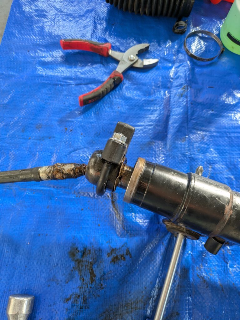

    Just take a hammer and bang at the tool to get the inner tie rod loose. Drove a long flat head through the rack and pinion bushing to act as a counter leverage. I recommend having the inner shaft as close to the rack housing to decrease any chance of damage.
    R&P is stripped and cleaned (as the best I could) and ready for shipment

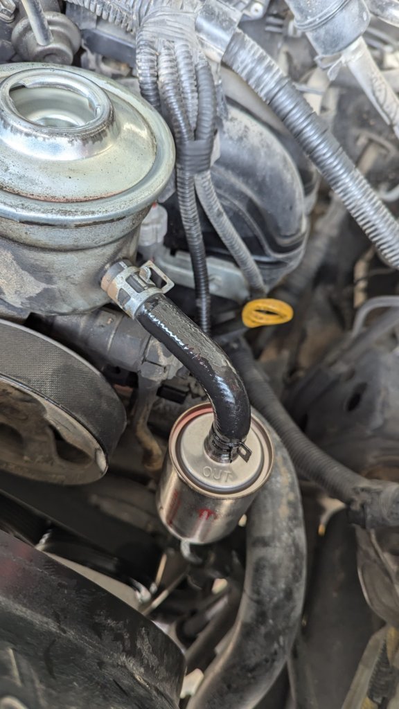

    after you get the rebuilt rack in, of course, you'll need one of these magnafine PS fluid filters too...
