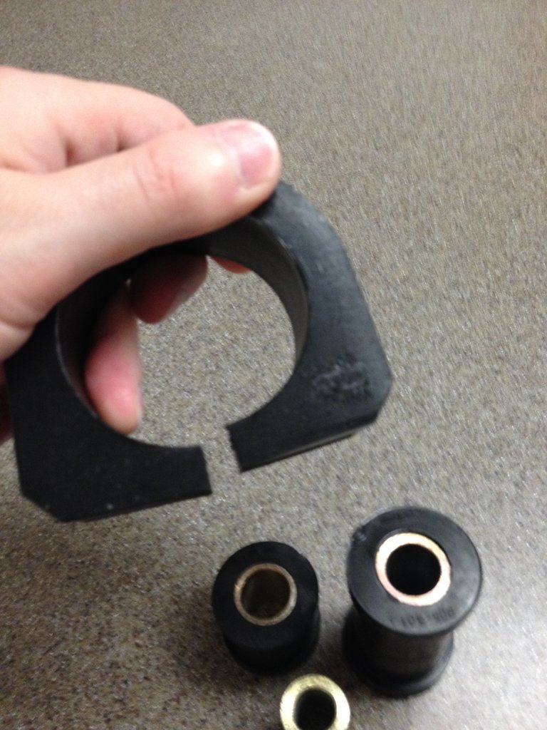

    I live 4 miles from asphalt on a dirt road and after only 200+thousand miles, the bushings in the front of my 1995 Tacoma are shot. I replaced the swaybar links, and that was easy, so I thought I'd tackle the rack and pinion. I dropped it and removed the bushings, and now I'm in trouble because NOBODY has bushings for a 1995 SR5 extended cab 2WD pickup with a V6 and manual transmission. I can get that driver's side bushing anywhere for a 4WD or Prerunner, but not for a 2WD. I've tried Energy Suspension, Whiteside, Moog (for a start). Toyota will only sell me the entire Rack and Pinion. Surely Toyota put that Rack and Pinion in more than one vehicle. If I know that information I might find the bushing listed under the other vehicle. The bushing I need is 19 mm long, 11.1 mm wide and with a .56 mm bolt hole. (All measurements were taken with a Vernier caliper by a foot-and-inches girl, so are approximate). Any help or suggestions will be greatly appreciated. My old "green submarine" (It runs on land and also under water) just flew through the smog check again and I don't want to give up on it.

    I was looking at the diagram in the repair manual and I see now that the bushing is like a bushing on some control arms where a bolt goes through it. Toyota usually just sells the whole control arm but sometimes you can still find a part number on the rubber bushing, then do a google search and see what comes up.
    Look carefully at the bushing and see if there is a tiny part number molded into it.

    You're lucky. When I changed my bushings on my 04 Tacoma 4x4 DC. I had to replace all this. Then the rack went out 2 - 3 years later.

    Blessings upon all of you!! I took some Fantastic kitchen cleaner to the one remaining flange. One end of the bushing (looks like the larger of the smaller bushings in the picture posted by Sicyota04) and the numbers clearly read 5522-35030. On the other side of the flange is a large #6. I'll see what I can find tomorrow. I'm also going to see if my neighbor, Jon Kinney, will give me a lesson on this Vernier caliper tomorrow. My readings do not match the computer conversion into inches or fractions thereof. Jon owns the Jonny Lightning shop and I'll guarantee he can read a caliper.

    Dorman says, "Sorry, not a fit". Thank you for trying. The problem is about 1/8" over in the diameter. It's got to be an exact fit or it just doesn't work. I used to tell my students, "Casi, casi, pero no cigarro" (almost, almost, but you don't win the cigar") when their English was close, but not correct. I presume Toyota just made those 4-runners a little heavier assuming tough off-road guys beating them up. Pin or bushings too long? I'll just cut them down. Bushings too short? The pin should make up for that. Bushings too wide? That one just shoots me out of the saddle.:annoyed:
