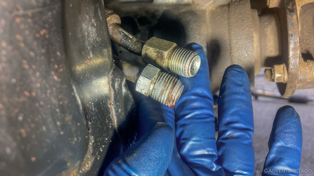

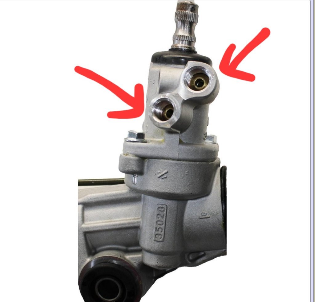

    Hello Everyone,
    I am trying to get help in determining which hose goes to the two ports on the Rack and Pinion. Please see image. Truck is a 2000 Tacoma v6 3.4l 4wd.
    So, the thing is I got a new rack and pinion installed but I fluid is still leaking. And I suspect it's leaking from those port. It could be crossed threading. But wanted to make sure the mechanic guy connect the hose to the correct port.
    I also want to know if it's okay to wrap the hose with Teflon tape.
    I appreciate any response. Thanks

    Those are a double flare fitting....tape wont do nothing....the seal is on the nipple
    ultimately if you cant get to seal ......you can use seal savers

    Which is the Return and pressure port?

    THere's no orings.....these are flare fittings just like brake lines....and HVAC
    O-ring would not stand up to 1500psi +
    its not a scuba fitting
    you have to be careful and squarely seat that tube perfect at 90 degrees
    or it'll be crooked when you wench down the bushing....
    if mar that end....you'd have to cut a little off and reflair
    ...which is not easy on 20yr metal

    Lower inside appears to be HP

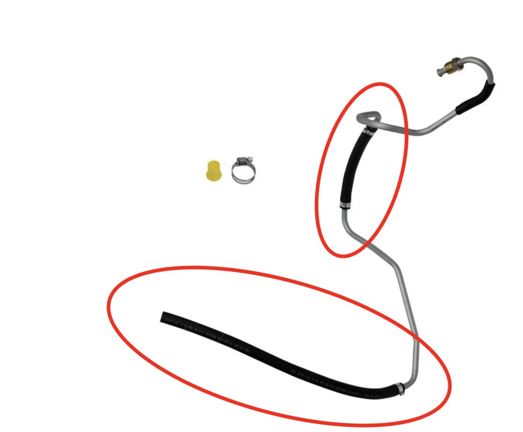

    Return line is the one without the crimped line and that has the constant tension clamps holding the hose onto the sections of hardline. Make sure it’s not leaking from the return line at the clamp closest to the rack. It drips down and can look like it’s dripping from something else.
    Did the shop give you a warranty on the parts and their work? I’d be talking to them if it was done recently even if there wasn’t a warranty.

    You know hydraulic hoses delaminate after time, pressure, heat, swelling
    all hidden from view.....
    considering how much a new rack is......most of you dont seem to understand
    to me a new rack would necessitate new hoses too....especially HP one
    kinda like ignoring high blood pressure.....hidden accumulating damage

    In my case it was the low pressure line that failed - it's easily rebuildable by getting some power steering hose and cutting lengths to fit with the sections of hardline.

    Any generic 3/8" steering hose will work to replace these two sections. It's usually about $20 a foot at a parts house and I bought 3' of Gates hose for $30 on Amazon. You only need about 2 feet roughly. The oem tube nut will be higher quality than the modern aftermarket stuff.

    For extra $20 I'd just buy the complete unit.....
    one and done......its a PIA to get that hose out of there.....might as well be 4 certain
    if you already had hose on hand, that maybe a different deal
    and you'd end up with a brandnew double flare....instead of some 25yr old that may already have some damage.....

    And for the die hard DIY.....you can actually make the HP side ones too...
    finding crimpable/bendable tube butts would be the hardest part
