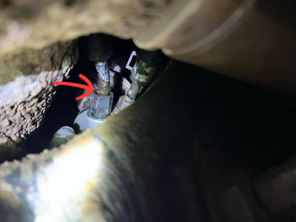

    The low pressure hose is the one with the constant pressure clamp on it.
