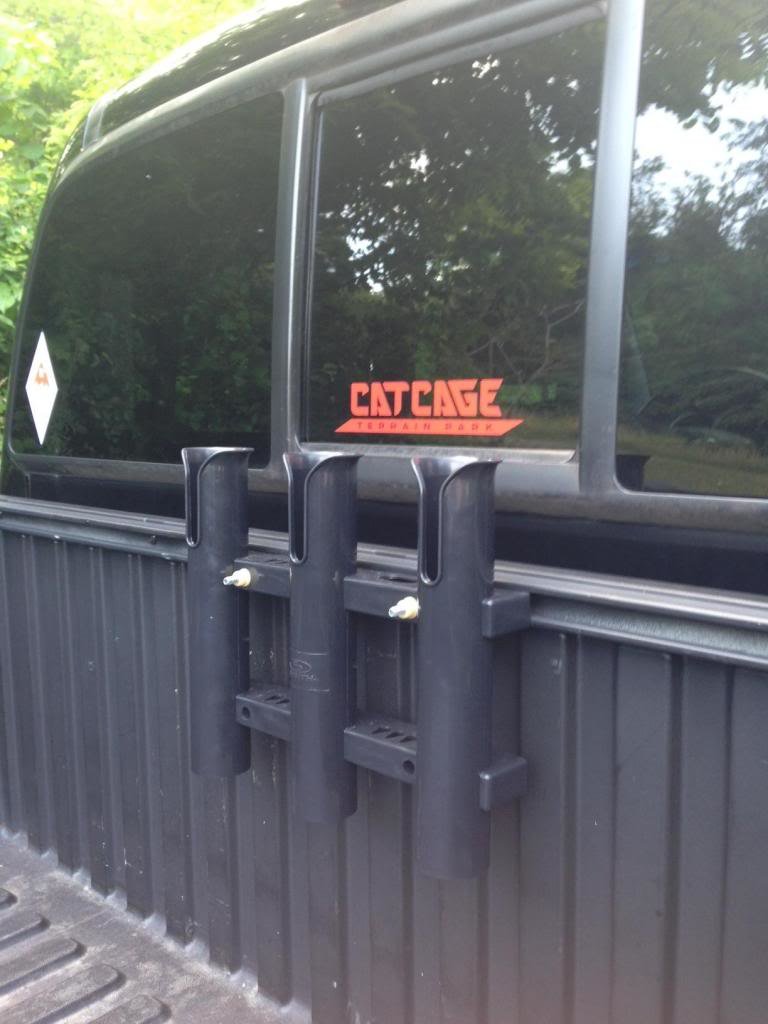

    They have the ones that go on the side rails. No space taken at all

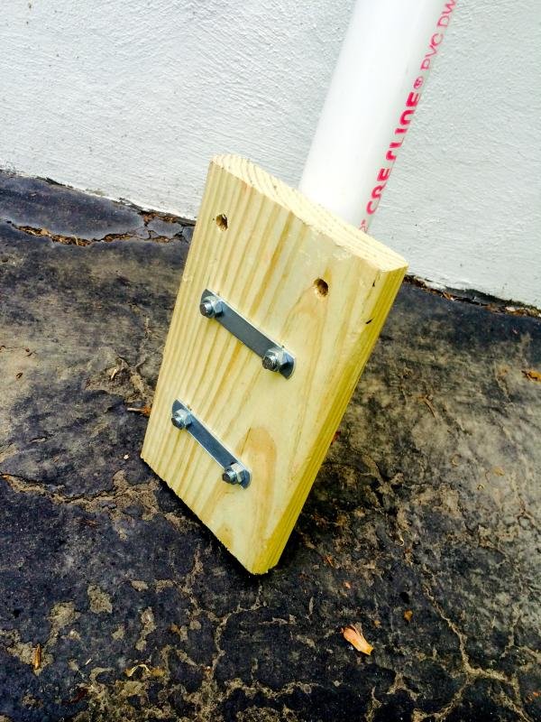

    [​IMG] :bananadance:Ahhh, now we're getting somewhere! Thanks D Derek! That's perfect and looks easy to build. I'm curious how he attached the PVC to the wood? Super glue?:confused: I'll figure it out. :cool:

    From the holes in the PVC , I'd say it was screwed or bolted on.

    Then how do the rod handles pass through?:notsure:
    Oh wait, I see. There's a screw on the inside wall! The 2nd hole is probably to pass a screwdriver through. Nice.

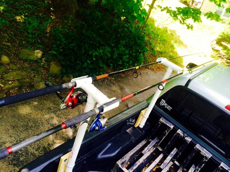

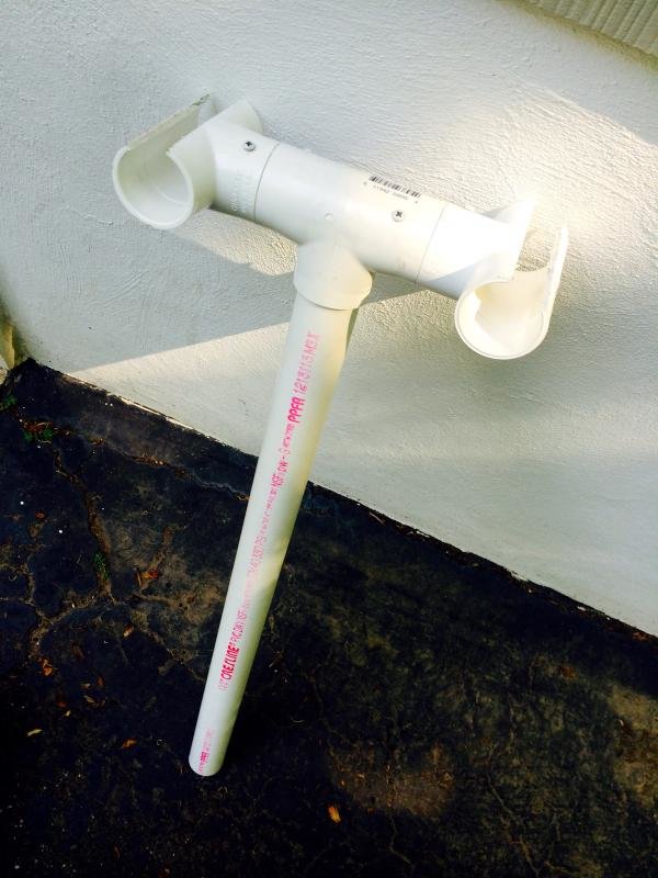

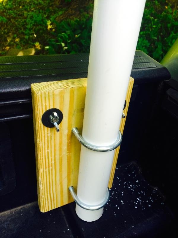

    Good point. I decided to take matters into my own hands and build my own. Below is the (almost) finished product. Had some 1.5" PVC lying around so took a trip to HomeDepot and picked up the rest of the hardware. Whole project cost me $25 including the black spray paint, which I haven't put on yet. This one holds 2 rods but add a cross coupling and two slip Ts and you got one that holds 4 rods.

  17. Jun 28, 2014 at 11:18 AM
    #17
    vjherrera
    vjherrera Well-Known Member
    Feb 24, 2013
    #98346
    172
    Vince
    Chicopee,MA
    Now that is slick OP....:thumbsup:
    a second one on the other side would great for is kayakers and our paddles.

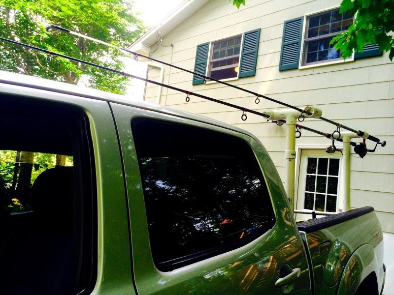

    This is my current set up cost me about 25 bucks, really pleased with it so far!

    Thanks. Paddles sure, but I wouldn't hang a kayak on this. The arms aren't secure enough for anything that heavy.
