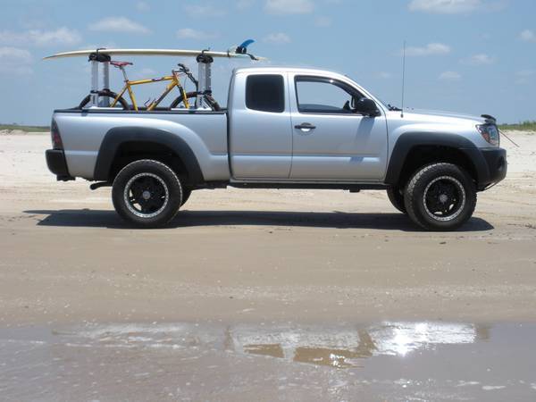

    I've used Thule for my rack needs throughout the years, but I'm faced with a small problem for my Tacoma...
    I want to carry 10+ longboards on my shortbed so I was thinking of installing a Thule Xsporter rack to allow me to put the boards high enough so that hover over the cabin.
    For those unfamiliar, the Xsporter looks like this (photo found right here on TW):
    The problem is, with this setup you cannot install a bed cover because the rack comes up from the bottom of the bed itself.

    I have the same rack on its way to me, I also stopped a order for a tonneau cover with the same issue in mind, I'm looking into a direct mount into the side rail myself once it arrives if the slider mount is not available, but then the second issue is will the covers fold without interfering with the rack itself.
