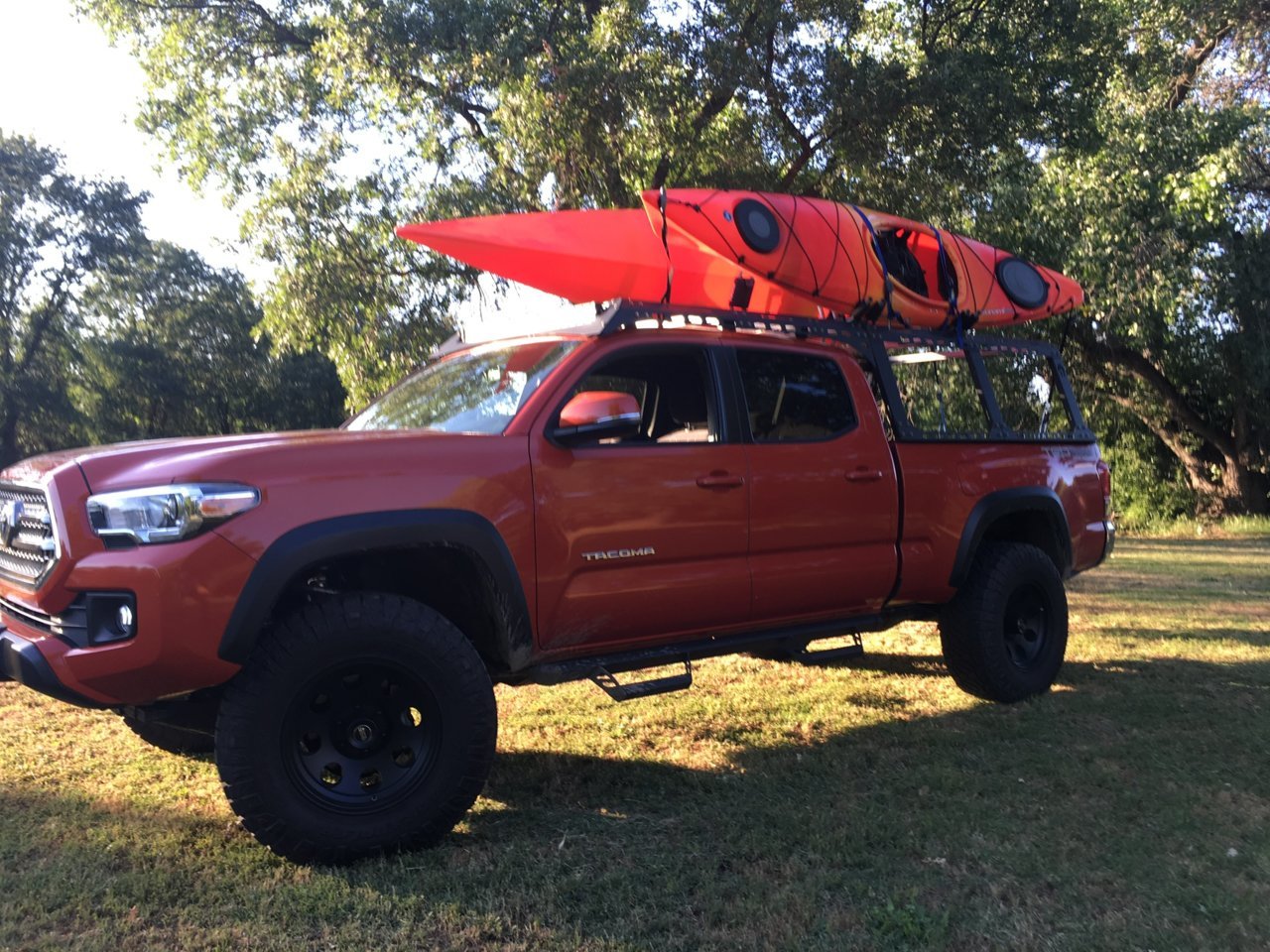

    Not my truck but I have one of these and love it.

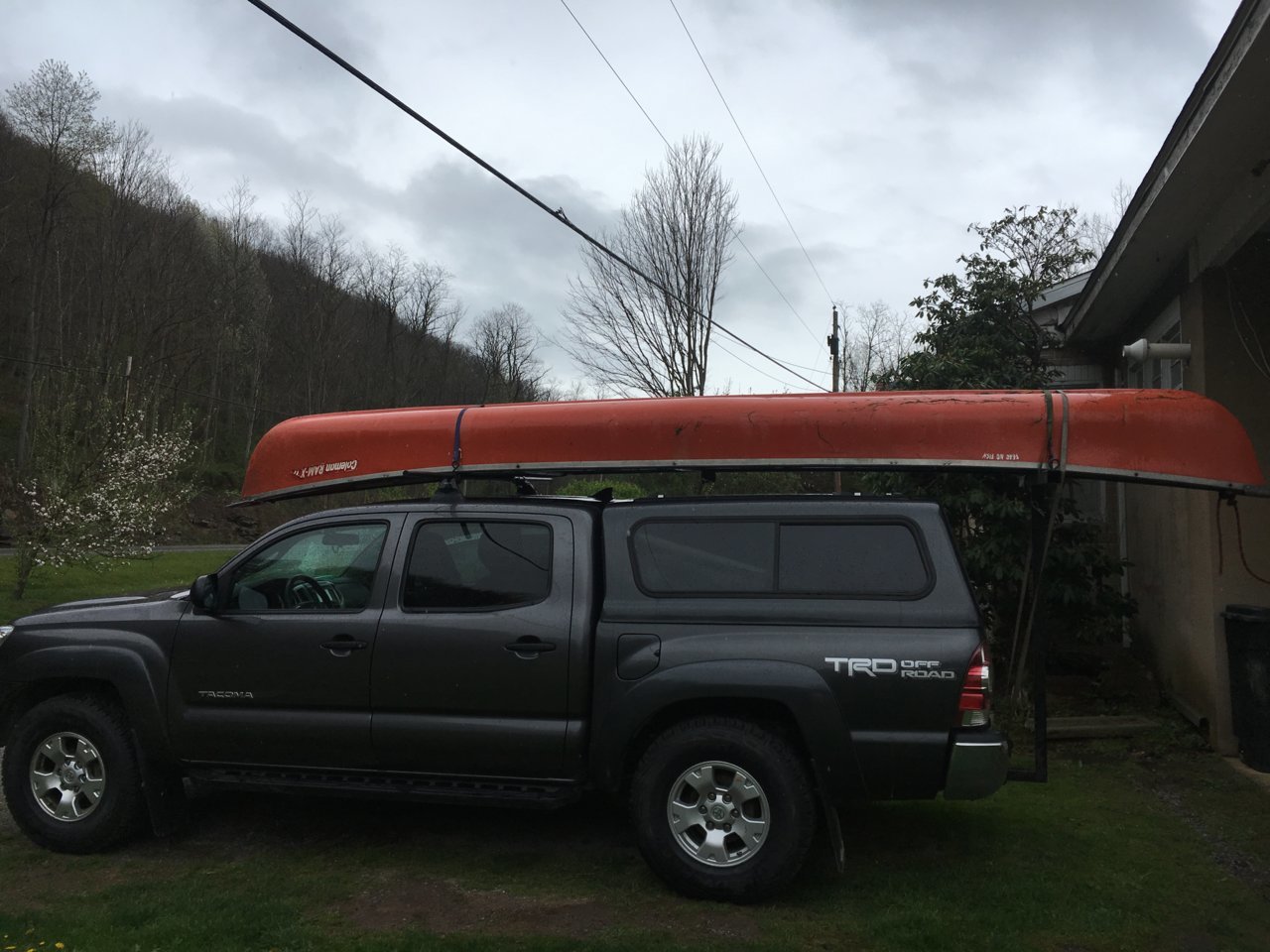

    17’ canoe
    Yakima landing pad 11 bolts right into factory rack hardpoint, even includes hardware but you’ll want to rtv the holes lol
    Add Yakima control towers and a round bar
    A hitch bed extender for the rear, you’ll want the hitch tightener to lock it all together

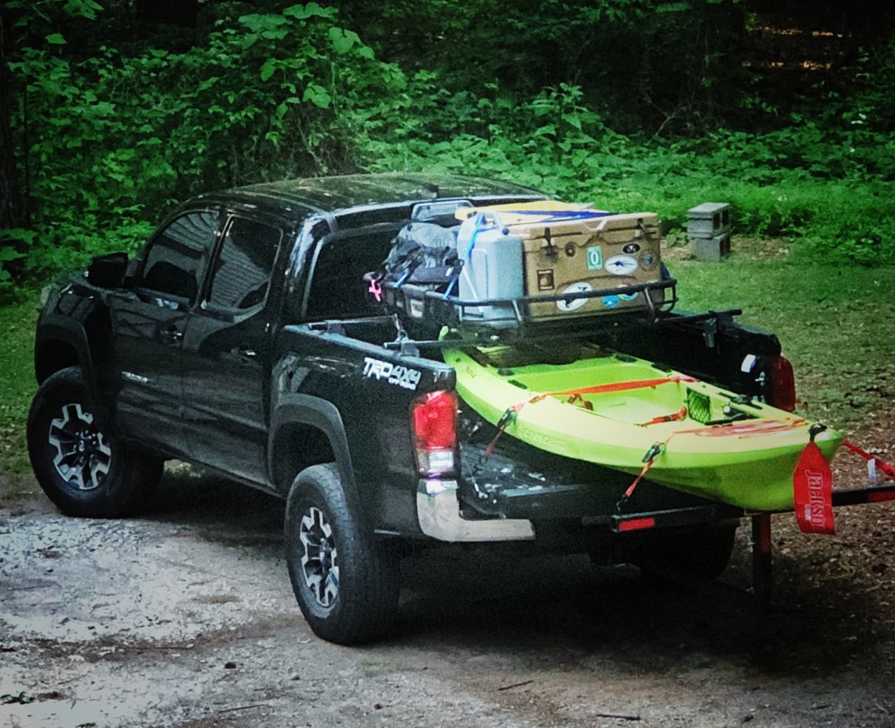

    I have a 11.5 ft that I just strap in my 5 ft bed. Fold my trifold cover back. No bed extender and I don't think necessary unless you are traveling long distance. Just put a flag on the back.

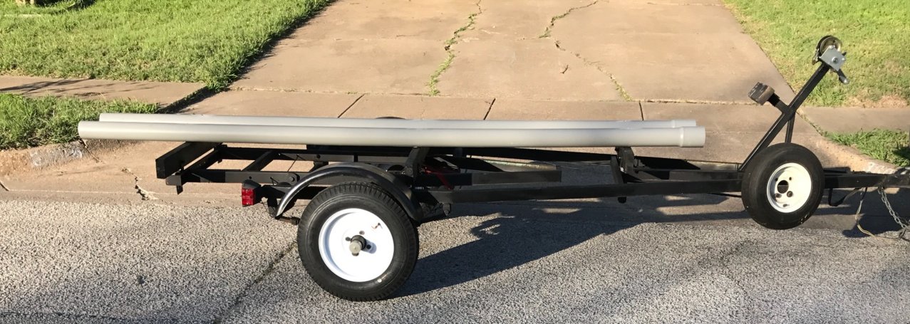

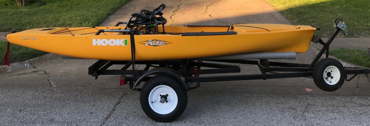

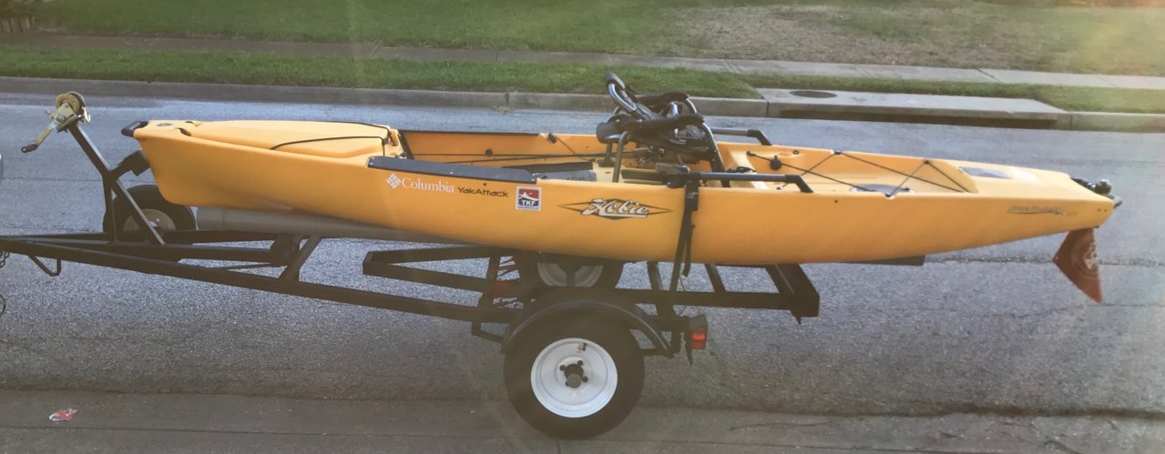

    I've been carrying fishing kayaks in truck beds for a long time. I think the truck bed extender like in the above posts are one of the best ways unless you want to get/mod a trailer. I've seen folks build a "rack/stand" that they put in their beds to stack them.
    Now I have customized a cheap john boat trailer so I can just use a boat ramp and do not need to carry it at all.
    I replaced the spare with the correct size since the pics.

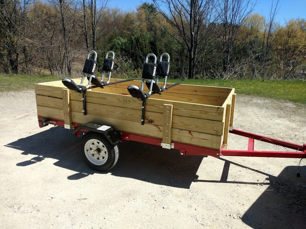

    Reserected from the dead.
    The Harbor Freight trailers work great for 'yak trailers. I've built several.mv02_pZvy6qlsae_L-O89lB9-uyskFpengcMuQ5u_b9c00a111373d2013b4501cde0c8803b7723461b.jpg

    How much did your rack system run ya?:spending:
    Looks killer man, huge fan of your setup!

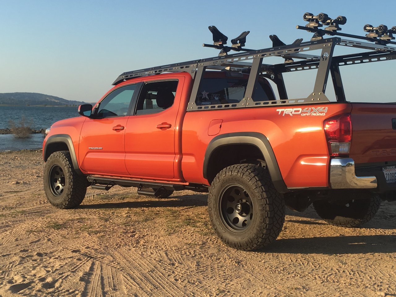

    I switched over from the J hooks, the saddles and rollers make loading a Breeze .

    Ya what rac
    What rack are you running? Is it all connected or do you have a separate one on the roof?

    Looks like a prinsu on the roof and I’m unsure of what’s on the rear. Two separate pieces.

    Dissent offroad @Dissent86
    Roof rack and bed rack. They are aluminum and very well built, yet extremely light.
    The kayak equipment is Yakima.
    Landing pads, saddles and rollers.
    The crossbars click off in less then two minutes .

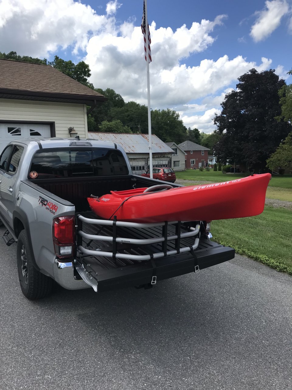

    For my 10' Dagger, I simply put the tailgate down, flip the bed extender onto the tailgate, and throw the kayak in the bed resting on the extender. A couple of bungees from the tiedown just behind the cockpit to the factory bed tiedowns and its not going anywhere. If I need to, I can pack gear in around the yak in the bed.
