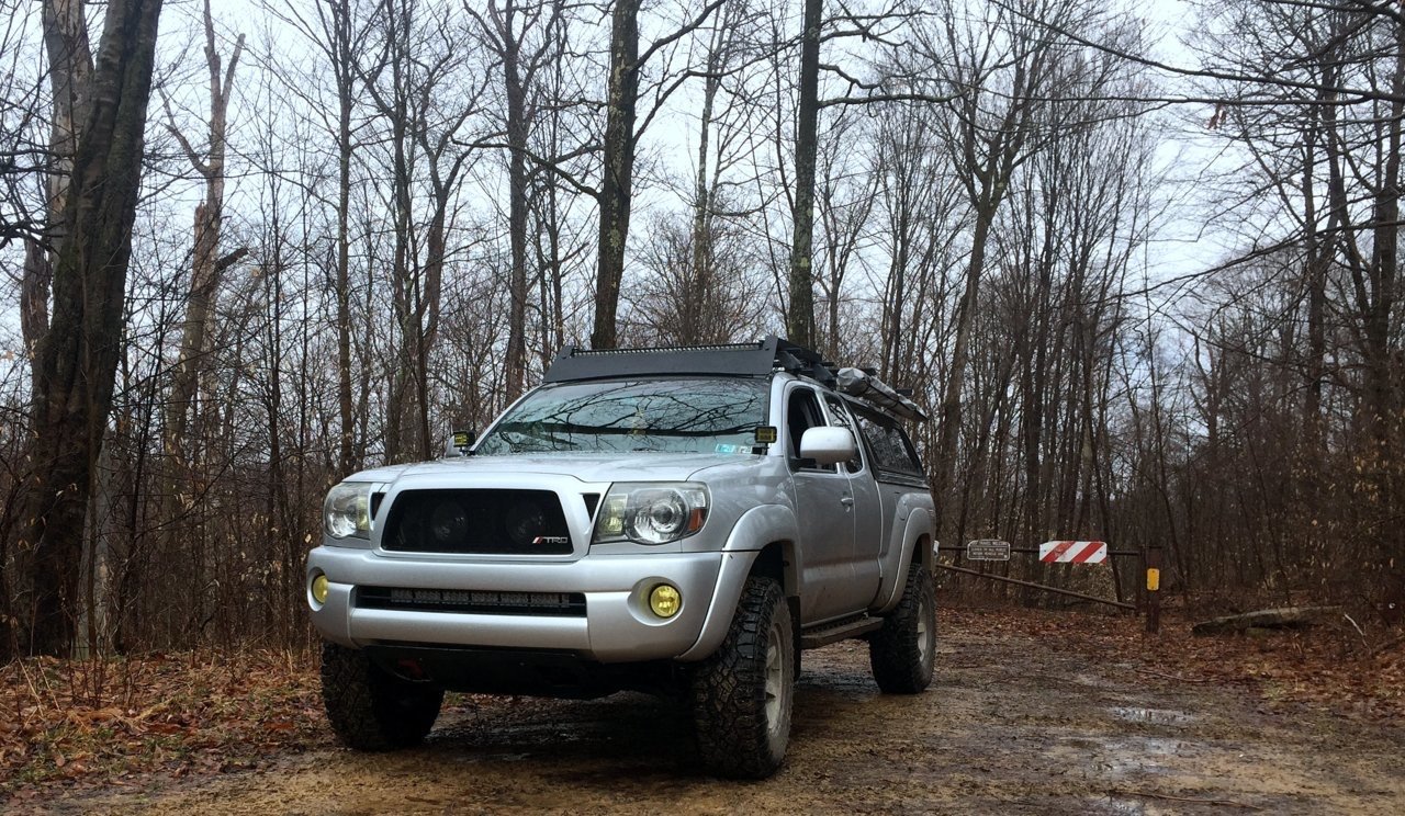

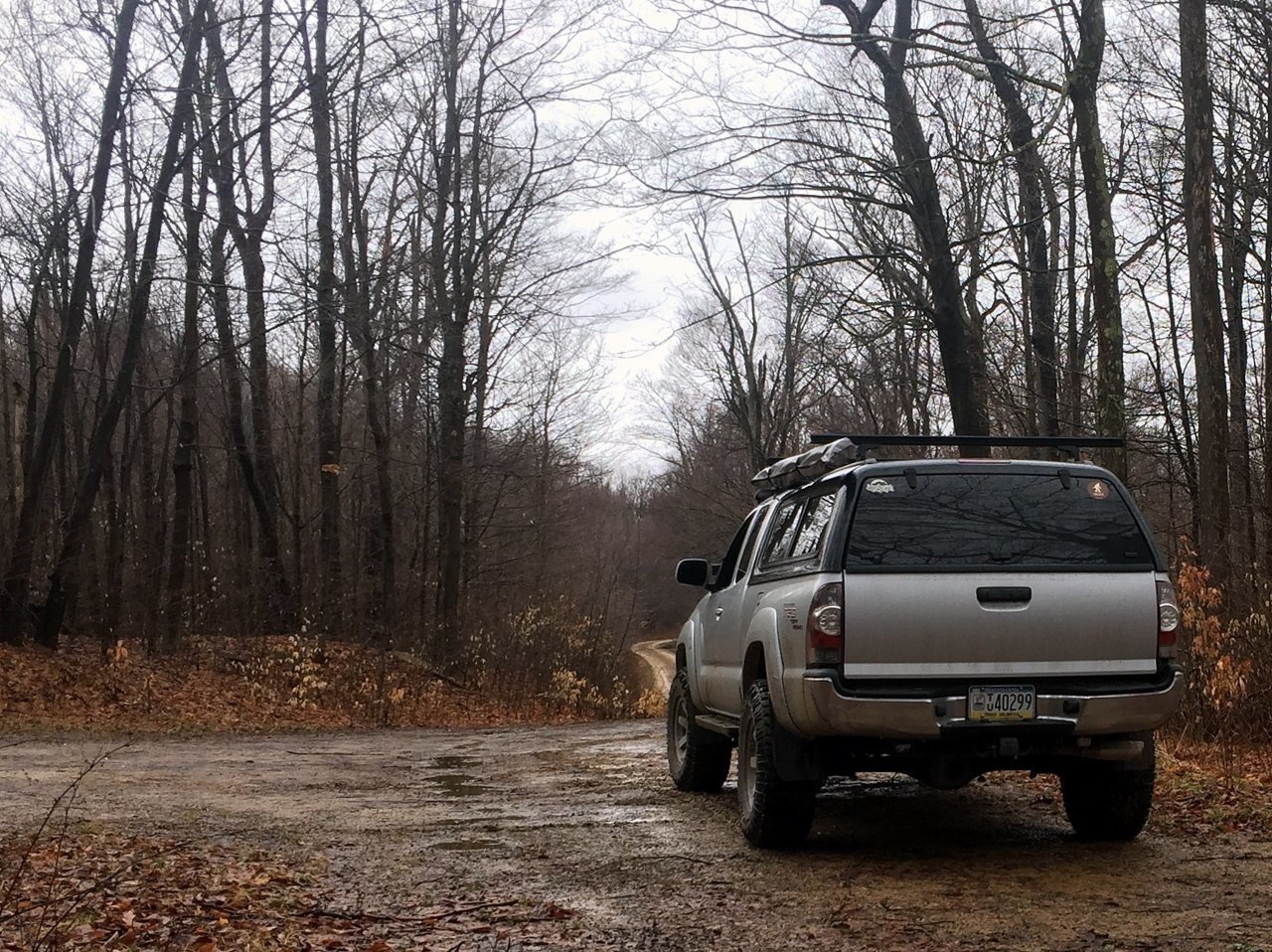

    The same shit everyone else has.
    8” et -10 on a 285/75
    No rubbing on the UCAs.
