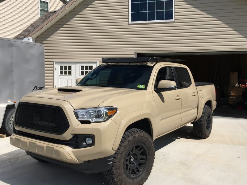

    i went with a Baja Flat rack. Mainly because I was looking for a sleek clean look. Had same setup on my 4 runner and was extremely happy. never had a problem with not having a basket style was able to support anything I stored on top. will be using rack most for overland tent. I had a bed rack on my F150 and it got a pain removing it when I need to haul something larger in the back. (i make alot of homedepot trips!)

    I like that rack. Can it support a roof tent with people in it? I was looking into getting a roof rack like that for the same purpose but all the racks are like a 200lb weight capacity..

    Make sure you know the difference between static and dynamic ratings on roof racks..

    The weight capacity for the rack is 200 pounds, but that is rated for working weight. (while driving). roof tents run from 120-150 pounds, so that is not an issue. Static weight rating is typically 1/3 of working, so you should be around 600 pounds support when static. I had same set up on my 4runner and we use to put 3 people in lawn chairs on top of runner.

    Oh sweet! That is good to know. I might be picking up one of those roof racks here soon then. Thanks!
