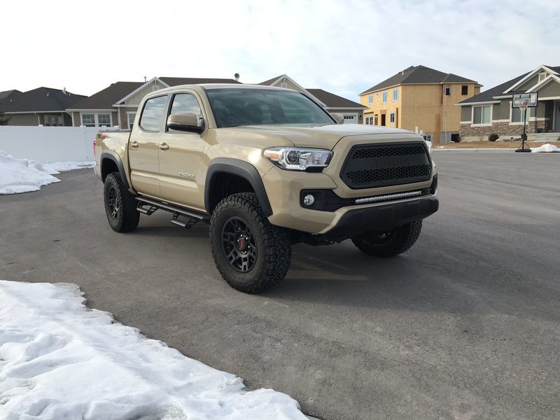

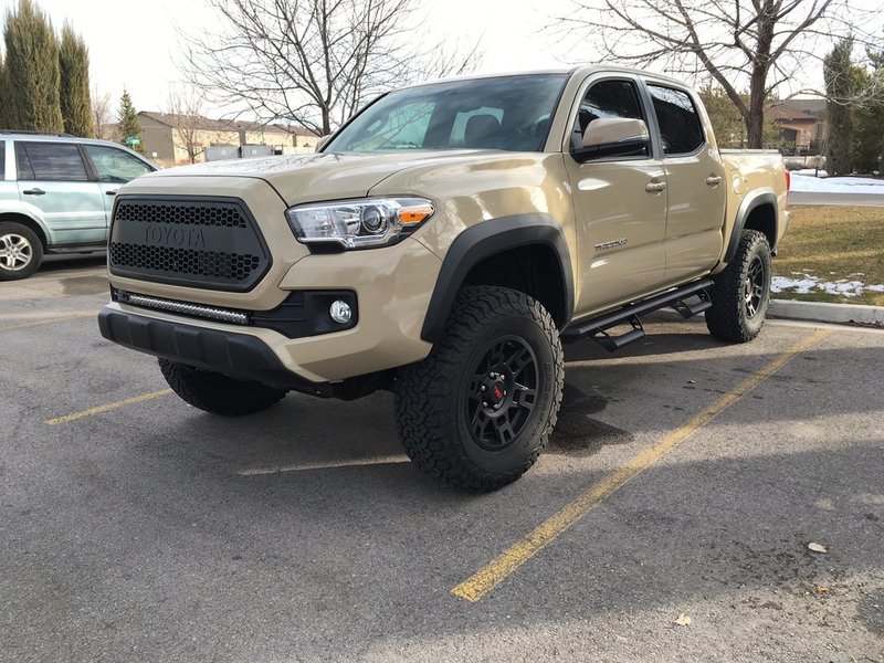

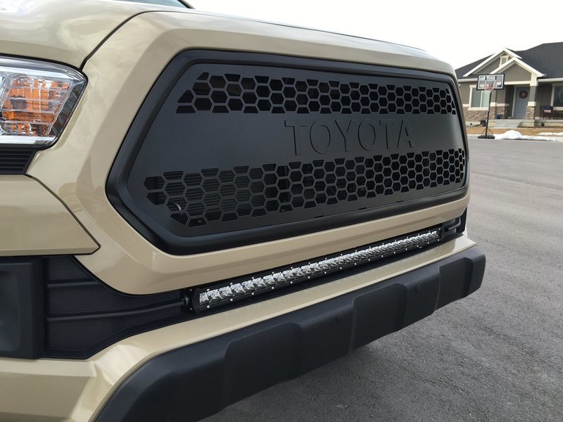

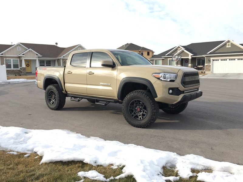

    Mine came in today and I got it mounted up. Installed pretty easy but as someone commented before, I was unable to get rid of the 3 small gaps from the cutouts next the bezel on the bottom. I messed with it for 30 min before locking it in place and there is no way to hide those, absolutely no way. The cutouts are too large and/or the grill is too skinny for the opening - it can't slide down far enough due to the welded tabs in the way on the bottom. They don't bother me as bad as I thought they would and everything else fit really nice. Good instructions and good hardware. For reference I also ordered the SR bezel from Toyota as opposed to painting my chrome one. I may also try find a way to paint the TOYOTA emblem in Quicksand in the future. See pics:

    Truck looks great man, grill really adds a nice touch!

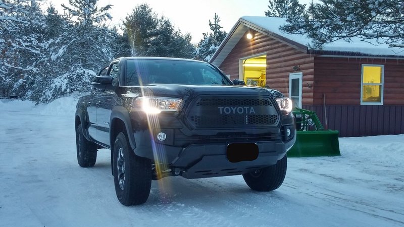

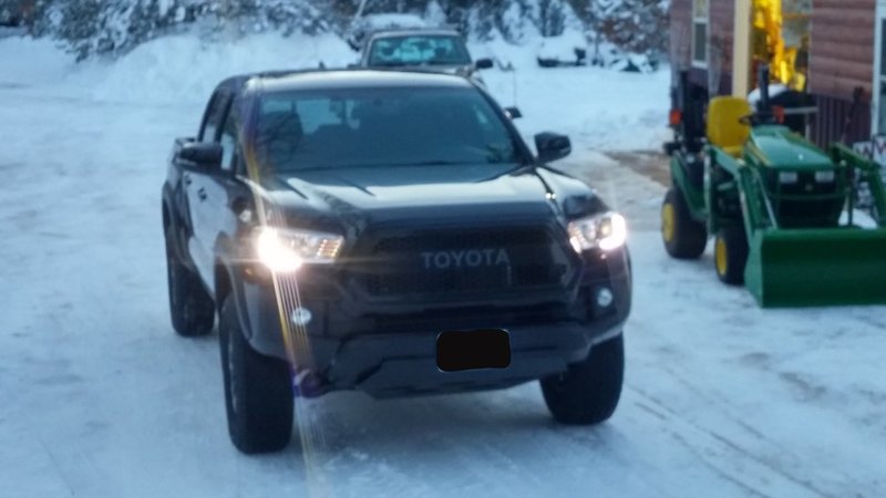

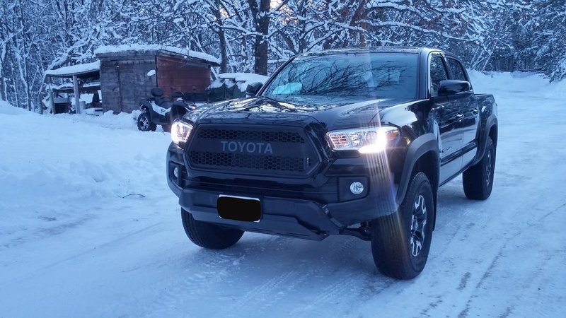

    Installed my skid plate and grill and Plasti dipped the letters grey.

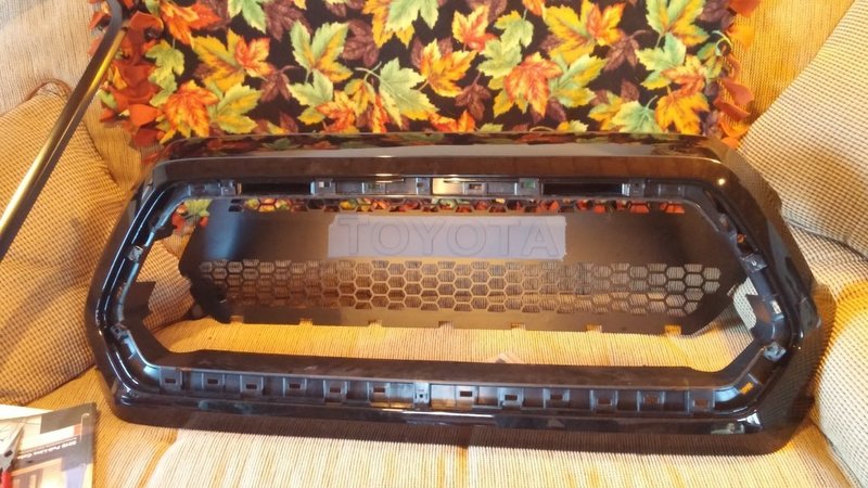

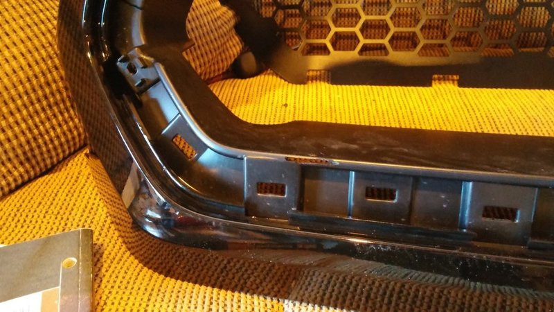

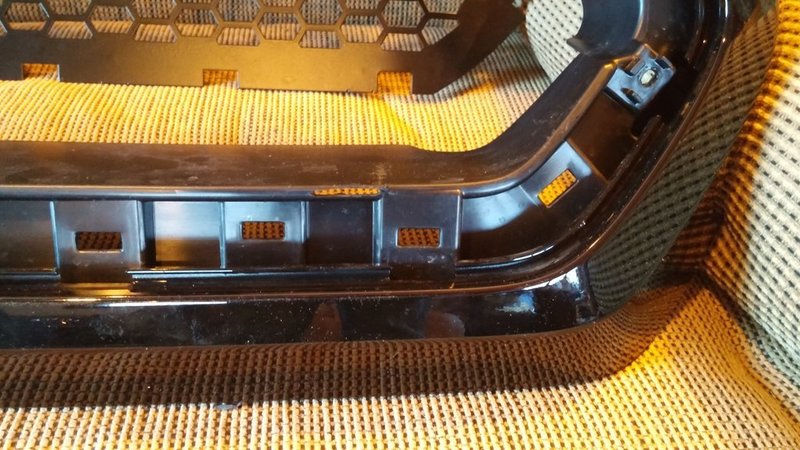

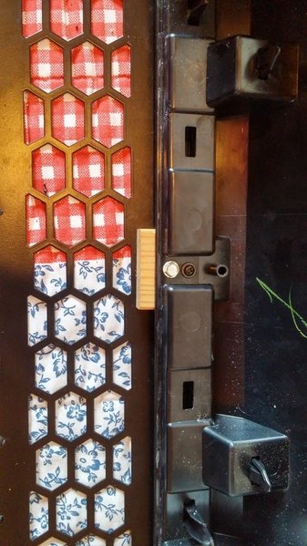

    If any of you have issues with the top of the grill not fitting tight I took a block of wood wrapped it in electrical tape so it didn't split and wedged it in and drilled it. I also cut some slots in the bottom to put the two bottom outer tabs in and eliminate the slots from showing. Here are some photos.

    Nice! I might do the same.

    Yah, nice job. I stuck some thick foam weather strip on top of mine to force the grill to fit tight and it worked well. Wish I had thought of your slit idea to help the grille move lower and hide the slots. Also love your grey plasti-dip logo - looks really good.

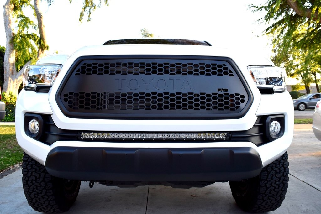

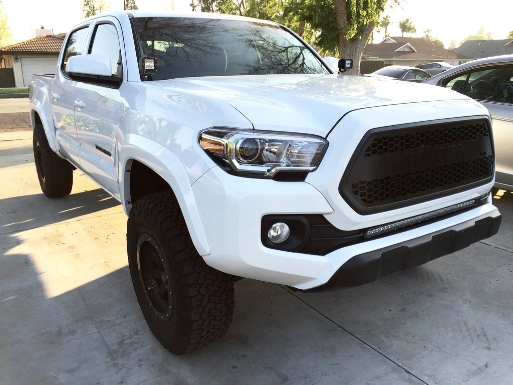

    Grill installed and love the fit and finish. Looks like the gaps on the bottom have now been addressed as they were not present when I installed. Great product!

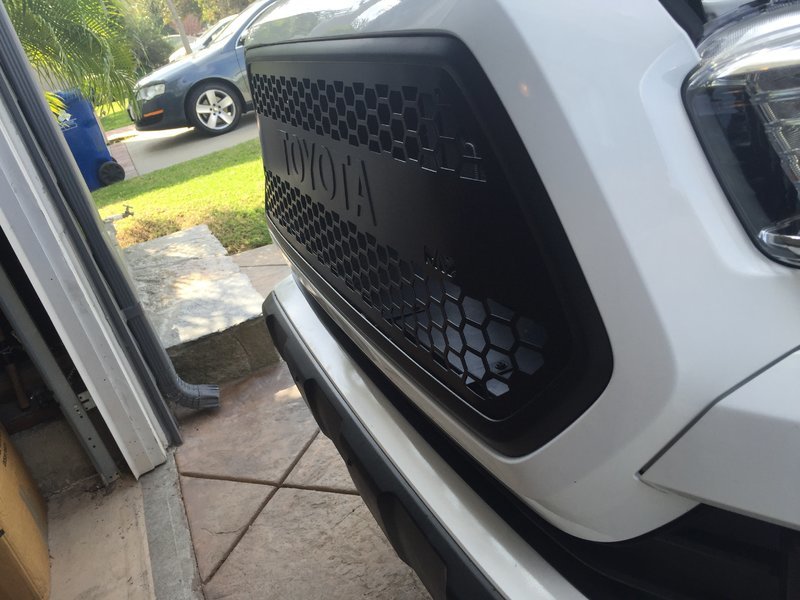

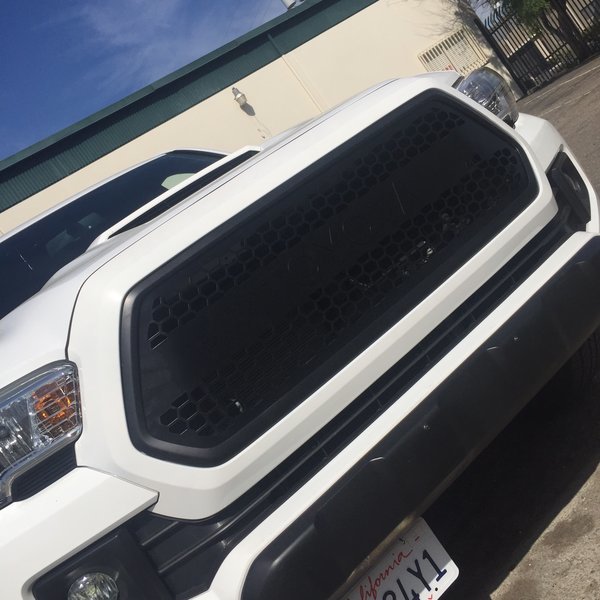

    Finally got my hands on a grill of my own! Super happy how it looks and will love it even more once I paint the TOYOTA white. The fitment is perfect! The gap issue that happened to a few of the first grills has been addressed and is now fixed! Haven't had time to take some good pictures but here is one I snapped the other day

    Looks nice!
    Did RAD industries cut in their logo into the front of the grill, or is that a decal? I like their grill, but that would be a deal breaker for me.

    Thank you. Yes the RAD log is laser etched into the grill, but I don't mind it at all. In person, you barely notice it's there and hardly stands out.
