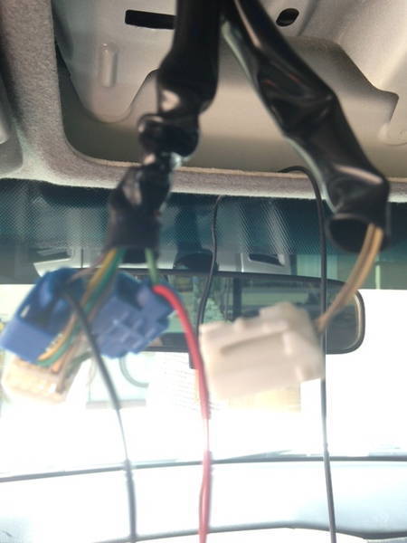

    Im trying to hardwire my Valentine V1 to my temperature gauge in my 06, I read that the thicker light green wire was hot(+) and the purple with the white stripe was ground(-). I tried quick splicing but it wont turn the radar on. No fuses are blown and the inline fuse on the hardwire kit is still good. Need help.

    :( Those vampire wire taps do not always work. You need to use a test light or a volt/ohm meter ans see if you have power coming out of your spliced wires. If you have power at the connector, it should work Good luck

    Agree with this, sometimes you have to use a little extra force to close them so the internal blade can close, the snap or pop doesn't always do the trick.

    I opened up the factory wires just enough to have a full connection without the splices and it still won't work, I think I'm going to run it down to another set of wires

    :) You may want to keep your positive wire hooked up like you have it and take your ground wire and ground it to the body of the Taco and see if it works. You may have power, but I think you have a ground wire problem. I would use a test light or a volt/ohm meter and see if you have power going to the power wire or if you may have blown a fuse accidently while hooking your wires up. Good luck.

    Well i would try to keep splicing and then hook the temp gauge back up and it still works fine so that fuse isnt blown. The inline fuse for the hardwire kit is still fine, i dont have a volt meter so im going to go to the local audio shop and have the install guys look at it and test it out. They are good buddies so I will figure it out by monday afternoon. I'll keep let you guys know what the problem was. thanks for the input!

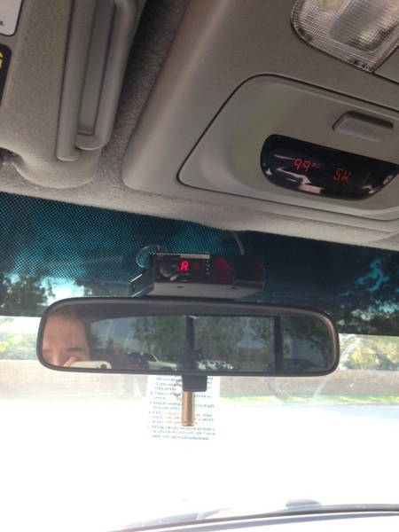

    So its the light green wire (+) and white wire with the black line (-), also those who have a problem with the radar sticking to the dots, if you set the detector on top of the mirror and slide it to the window, it will stick to the dots because the mirror takes most of the weight off of them, havent had it drop once. hope this helps
