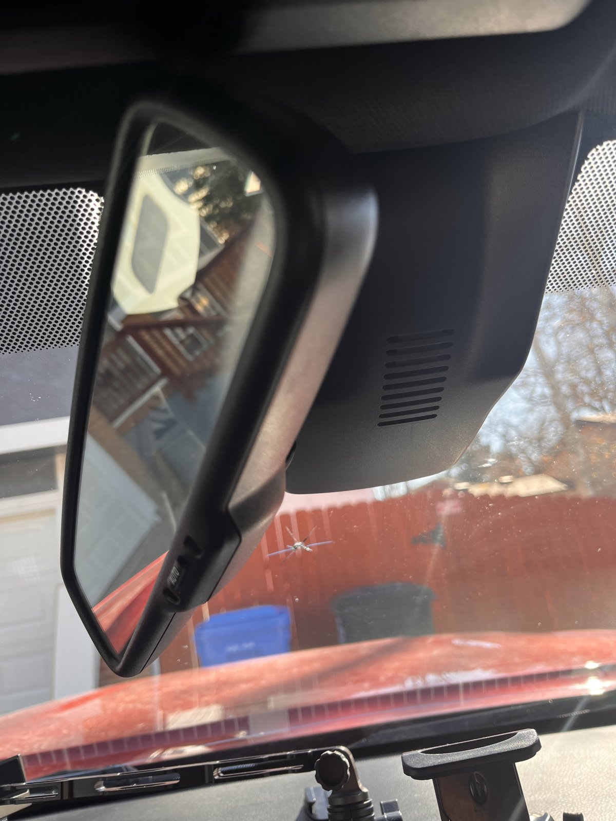

    Hi all I’ve been having issues with my cruise control radar at night, it works during the day, but it seems to work intermittently at night. Looking at the black box behind the mirror from the front view there appears to be something blocking the camera. Is there a way to open this black box up and try to move whatever it is?

    Hard to tell from the photo .. but taking it apart is not an option u will need to recalibrate it if u do that .

    was this truck in an accident? you might have to take that route, IF the window needs pulled (which it's broken anyways) and/or the camera needs replaced or repaired and calibrated.
    It looks like something might have broke, or become dislodged and slid forward.

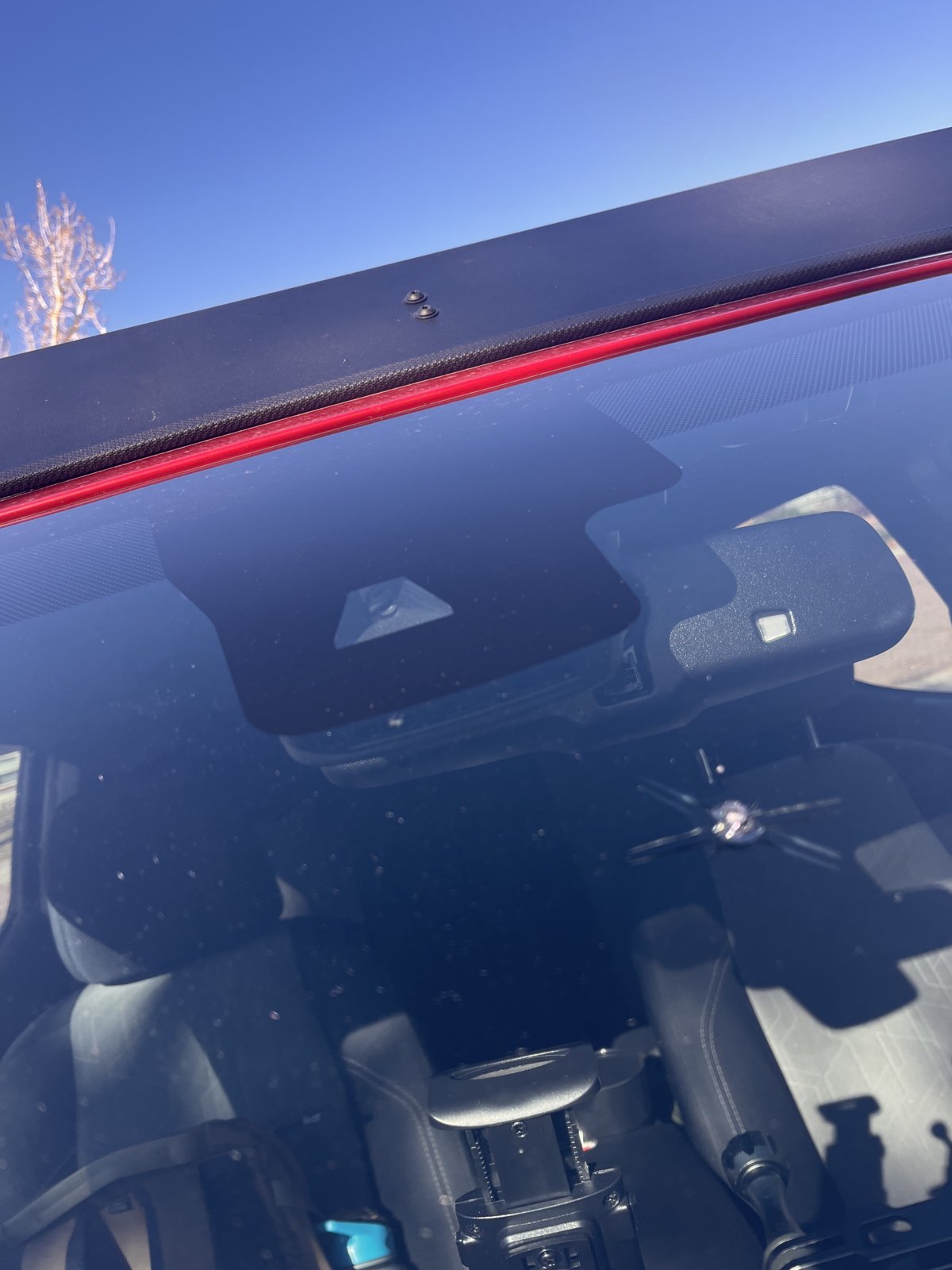

    I noticed the star in the windshield, has it been there all along or just recently?

    The star on the windshield happened a while ago. Now all I’m wondering if there is a way to take the black box off to try to move what is in front of the camera?

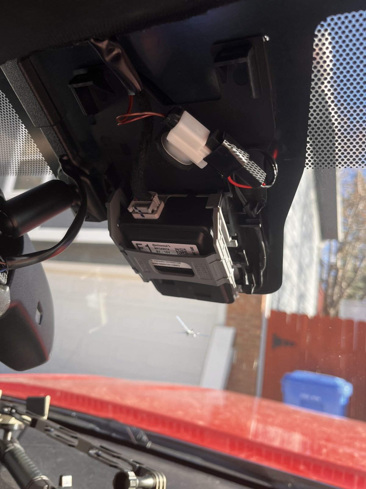

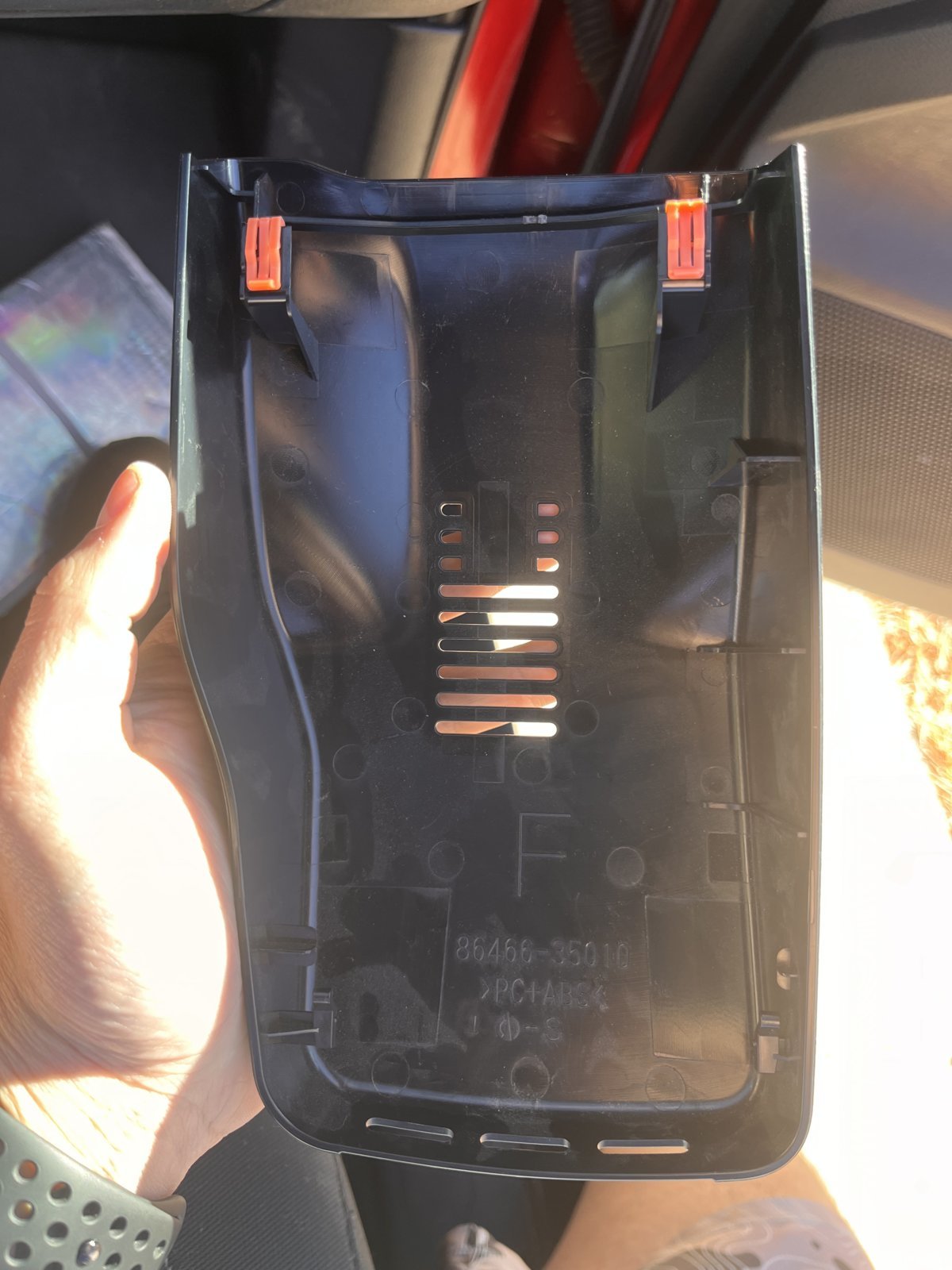

    Solved my own issue
    the box slides down, and sure enough the electric cable to it was in front of it. I’ll hav

    The photos show how he removed the camera enclosure to allow access to the wire or what was crossing in front of the camera lens.
    Good job.
