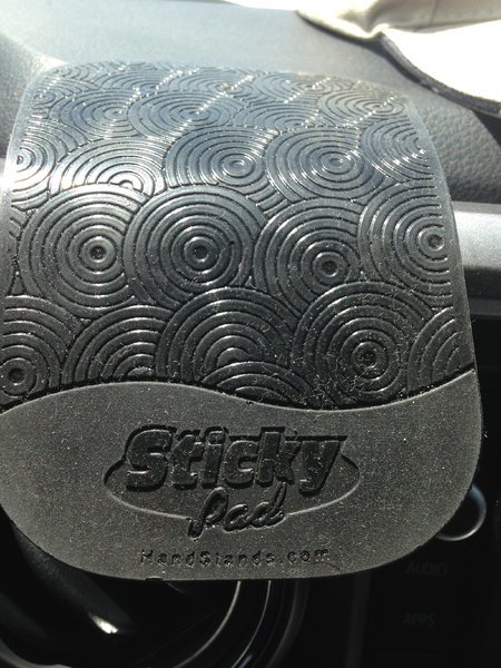

    @The hammer what dash sticky pad are you using on the dash?

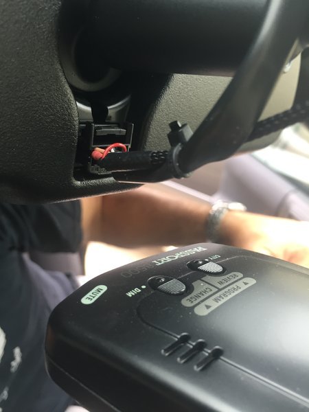

    Does anyone have a pinout diagram or pics of the mirror connections that were used?

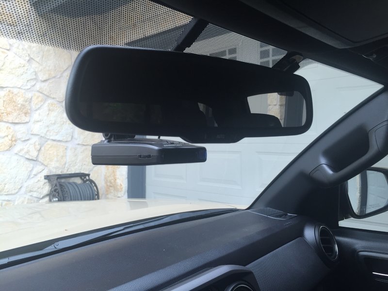

    Can you take a pic of the hook and loops that you used please ?

    Should only be 3. Black for ground and I think the others are orange and purple. Orange should be ignition power and purple is constant power. Truck is at the dealer getting an oil change I will look at my Valentine 1 setup when I get it back later today.
    Mine is hooked up to ignition power so it turns on when the truck turns on.

    It's a sticky Pad I picked up @autozone or PepBoys one lol!

    Orange = Ignition power
    Blue = Constant power
    White/Black = Ground
    My Valentine 1 is pinned
    Red - Orange
    Black - White/Black

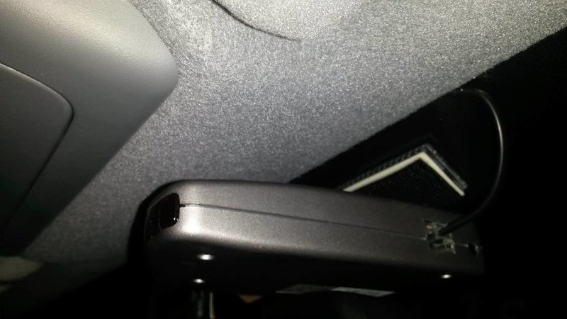

    A little Velcro strip and sit it on top of the rear view mirror. Then tapped the power using a mirror tap cable. I've always done this on my previous Tundras. It stays tucked up out of sight and does not move at all.

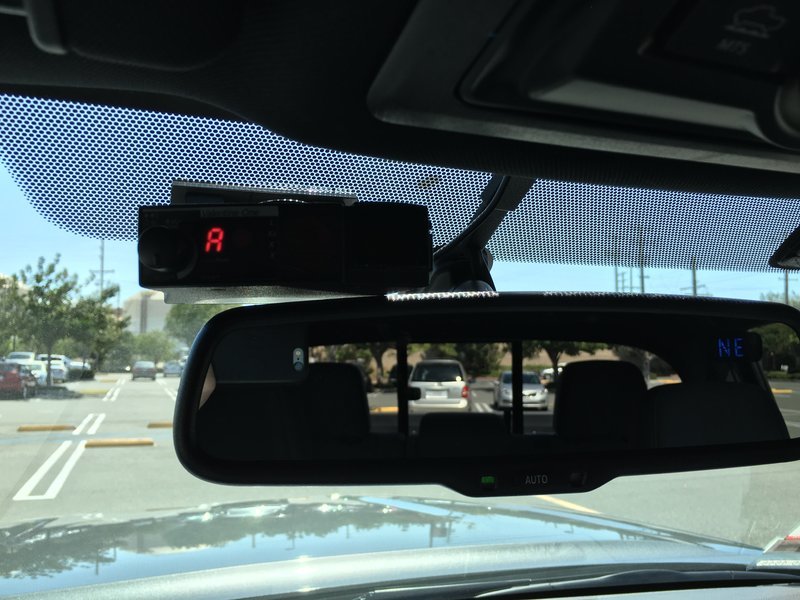

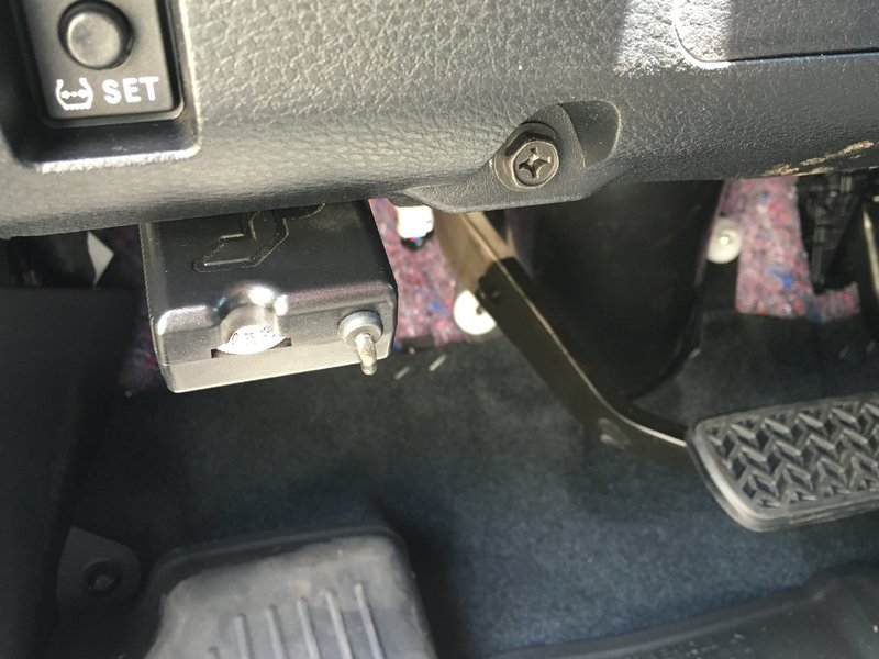

    Here is my V1 + savvy installed. Took about 5 minutes, antenna horn is below the metallic black dots. Stuffed the wire into the headliner and ran it down the driver side A pillar. Also a pic of the savvy in the OBDII port. Stuffed the hub that comes off it behind the kick panel to the left.

    Snugtop Rebel with some options Body Armor Rock Steps Rhino Mats Weathertech Mudflaps Radar detector hardwired to rear view mirror. Stereo upgrade: Amp: Arc Audio XDI805 LOC: AudioConnect LC7i Front Speakers: Hybrid Audio Technologies Claris 6.5 Rear Speakers: Hybrid Audio Technologies Mirus 5.25 Sub: Pioneer TS-SW2502S4 Box: Pioneer Ud-SW250T Bilstein 5100s OME 885 Springs Single Add-A-Leaf BFG KO2 265/75/16
