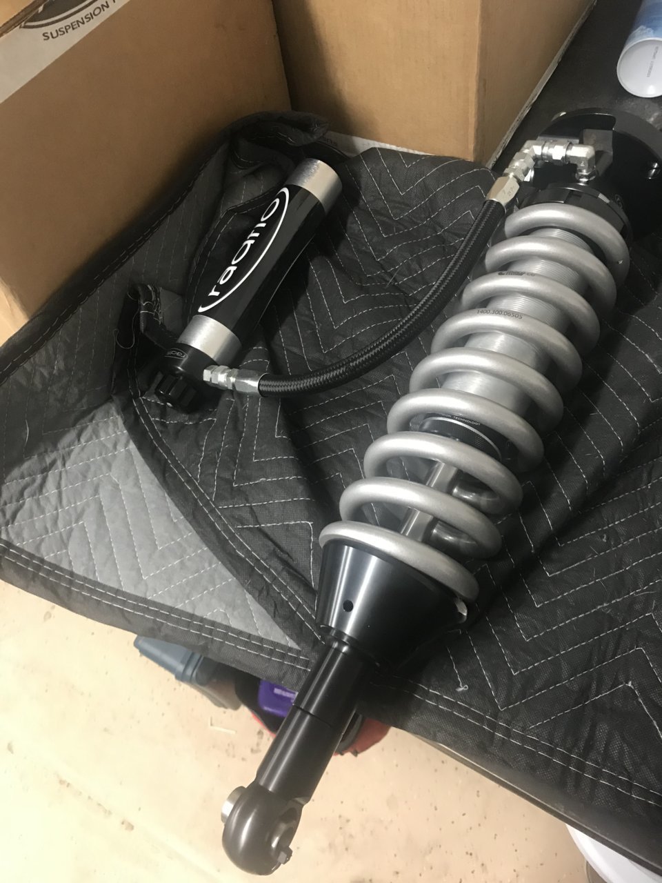

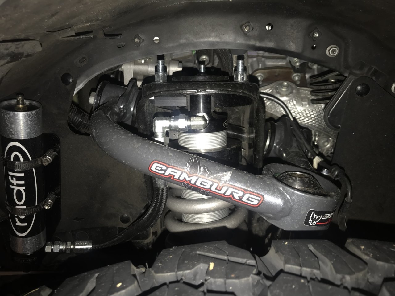

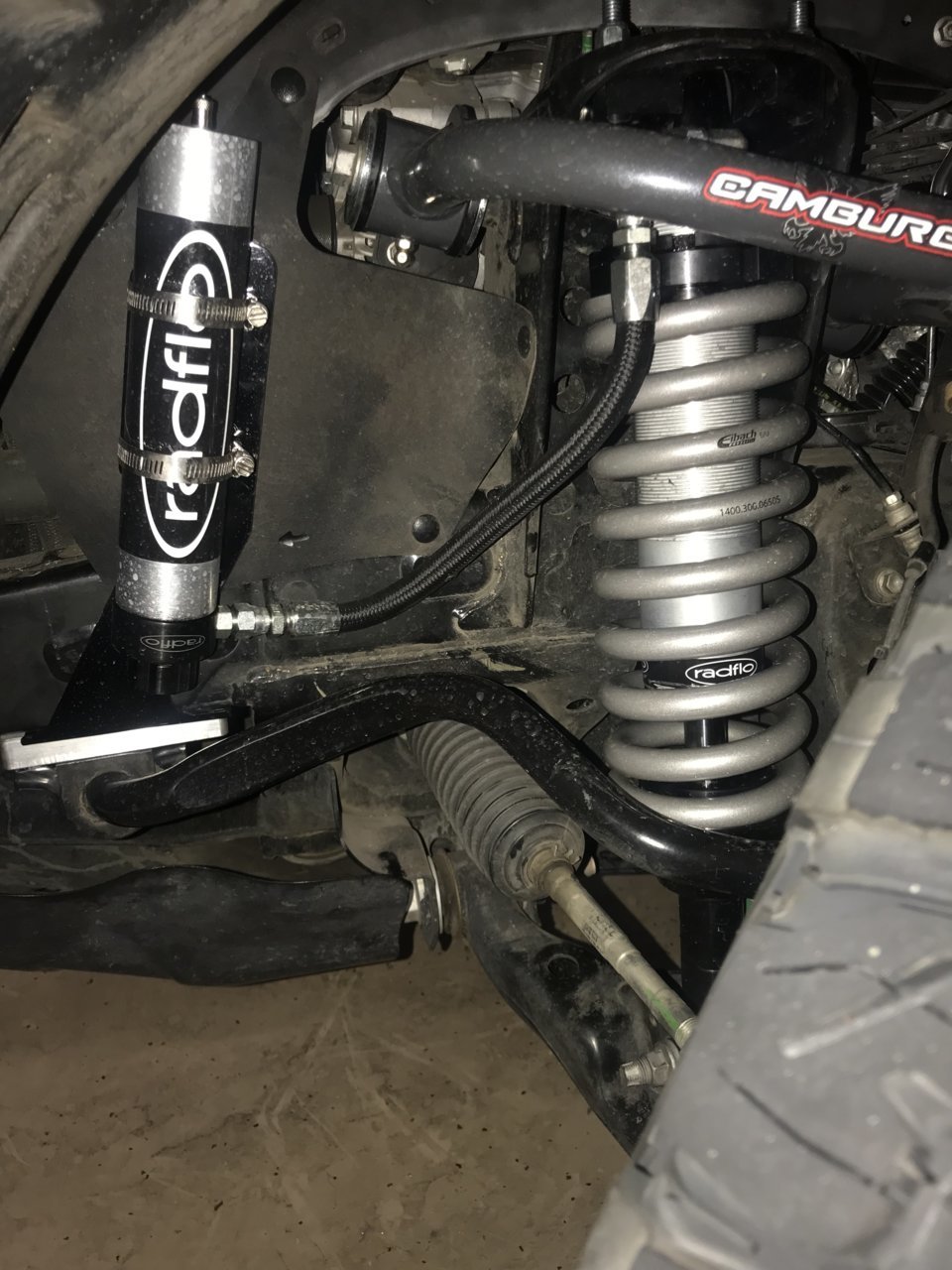

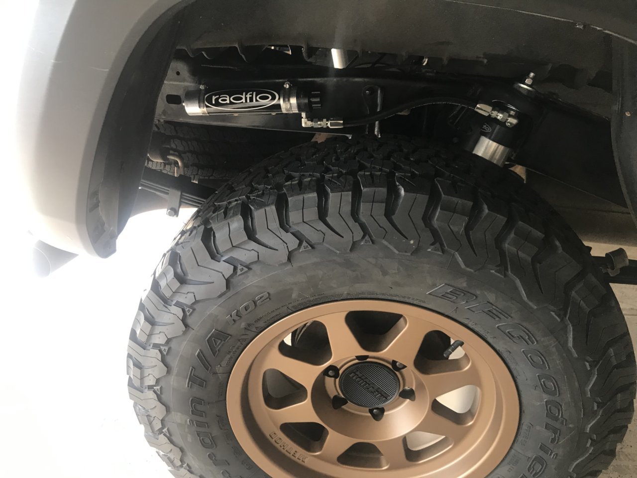

    Here’s a few pictures- will upload more tomorrow. Just finished install.

    Yes, please upload some side profile and how much preload you have. Thanks

    650# Springs in front
    Icon RXT Leafpack in rear set at option 2
    2-1/2" difference front to back unloaded (rake)

    There are 1" of threads showing- I left them how the factory set them.

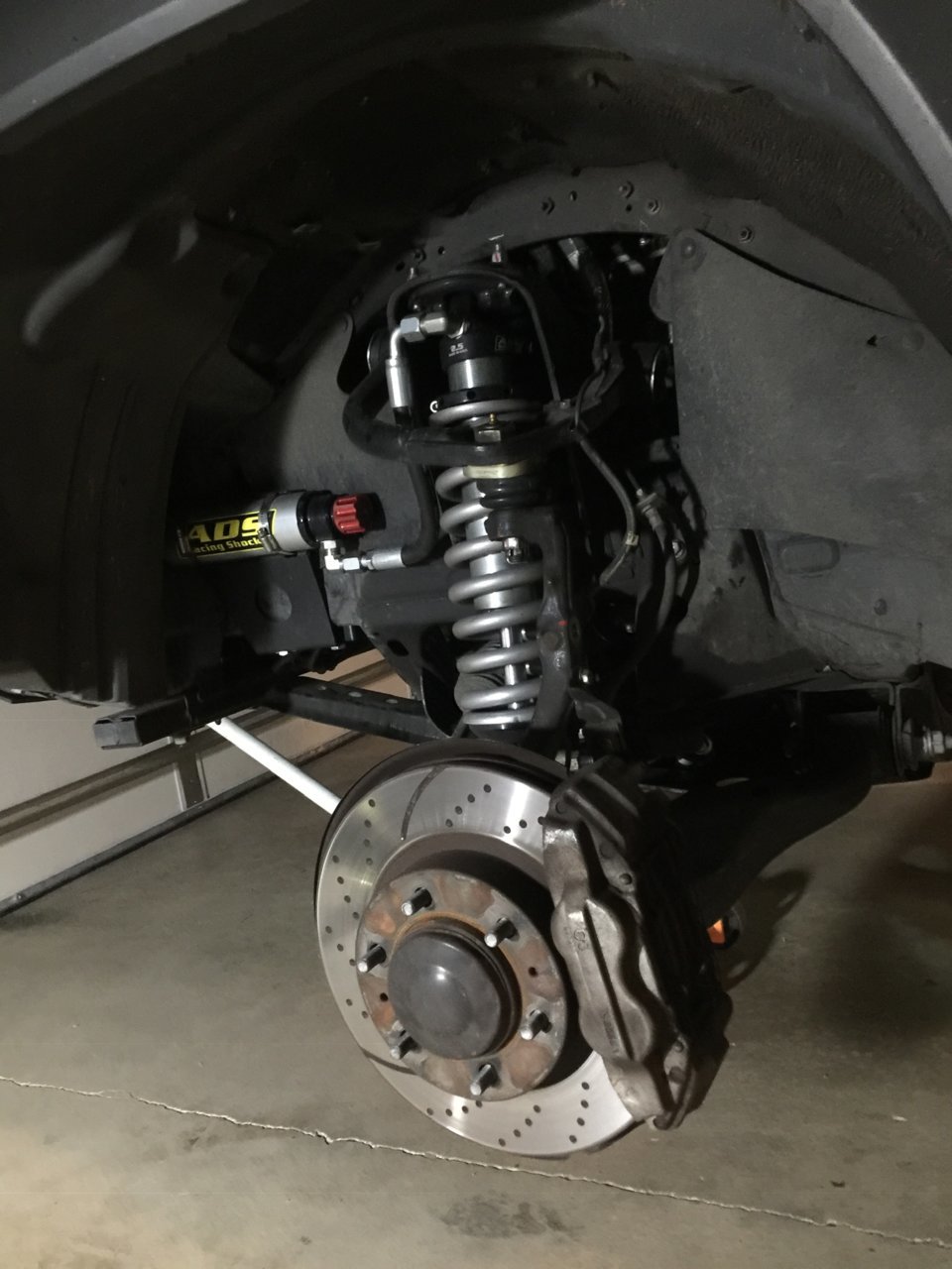

    Have you considered ADS shocks at headstrongoffroad.com?
    They have unique progressive dampening and digressive rebound. Drive nice on the street and float well doing 75mph+ in the desert or trails

    I just adjusted the coil overs and it is now 2.5” higher than stock. Every full turn of the collar is about .25”. With the 650lb springs it feels firm but that might be more of the valving of the shocks. I haven’t gone off road but I did hit some speed humps and it absorbs them very well. No problem on the questions that’s what we are all here for - if you have any more feel free to keep asking.
