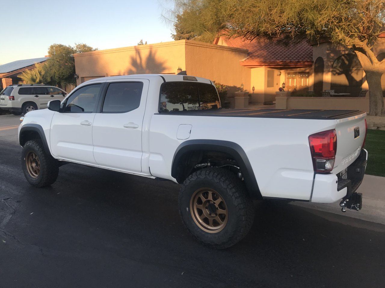

  8. Feb 23, 2019 at 5:04 PM
    #48
    LONGWHITELINE
    LONGWHITELINE Well-Known Member
    Aug 23, 2017
    #227822
    94
    Martin
    2017 White Tacoma TRD Off Road DCLB
    Stock
  9. Feb 23, 2019 at 5:11 PM
    #49
    charlieyankee88
    charlieyankee88 Well-Known Member
    Jul 22, 2017
    #224770
    337
    2017 TRD OR DCSB MT
    RADFLO Suspension, JBA HD UCAs, Mobtown low pro bumper, Mobtown bolt-on sliders, Engo SR10s, SCS Stealth 6, AFE CAI, URD Spec U, OV Tuned, Gobi Rack, Softopper, CMC
    Looks great! Preload is not bad at all. What size tires you running?

  12. Feb 23, 2019 at 6:11 PM
    #52
    LONGWHITELINE
    Aug 23, 2017
    #227822
    94
    Martin
    Stock
    285/70/17 C load

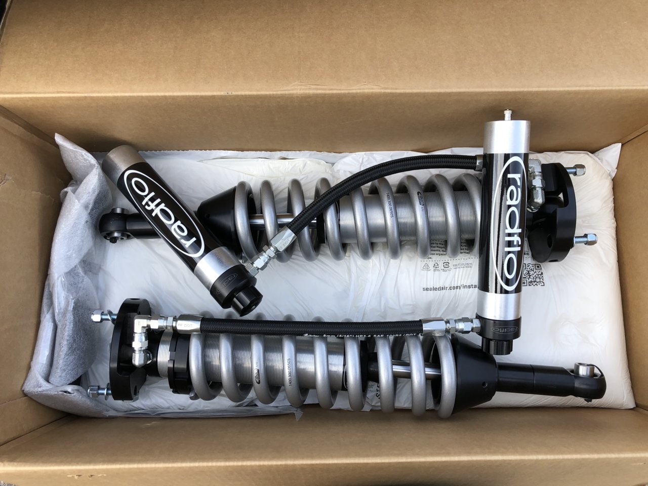

  18. Feb 26, 2019 at 4:48 PM
    #58
    charlieyankee88
    Jul 22, 2017
    #224770
    337
    2017 TRD OR DCSB MT
    Fronts came in today. Will install with icon rxt leafs tomorrow. Rears should be in on by Friday and I’ll put those on last. Thank God for base auto hobby shop. #DIYAF
