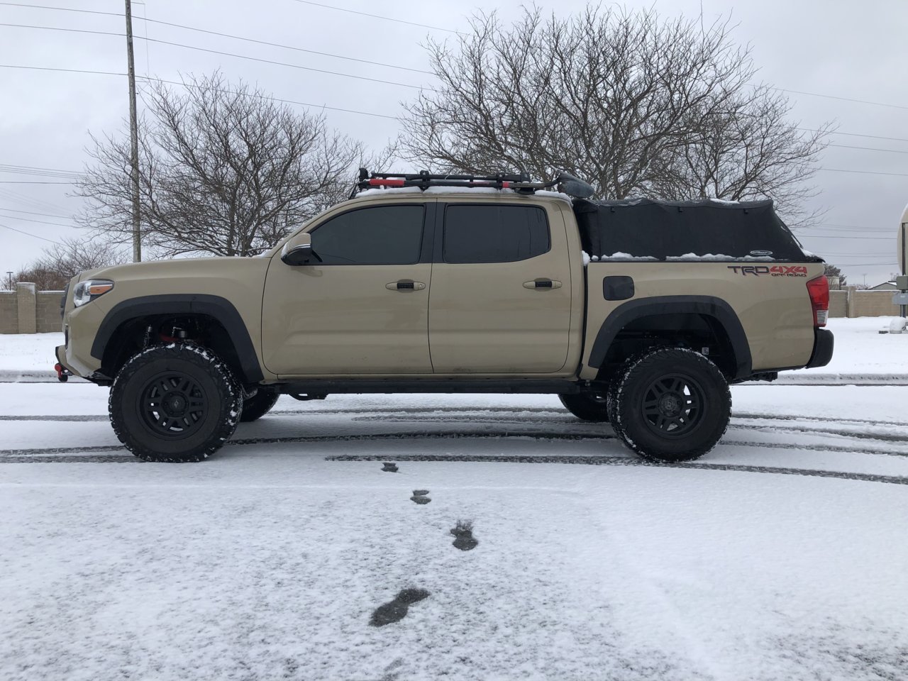

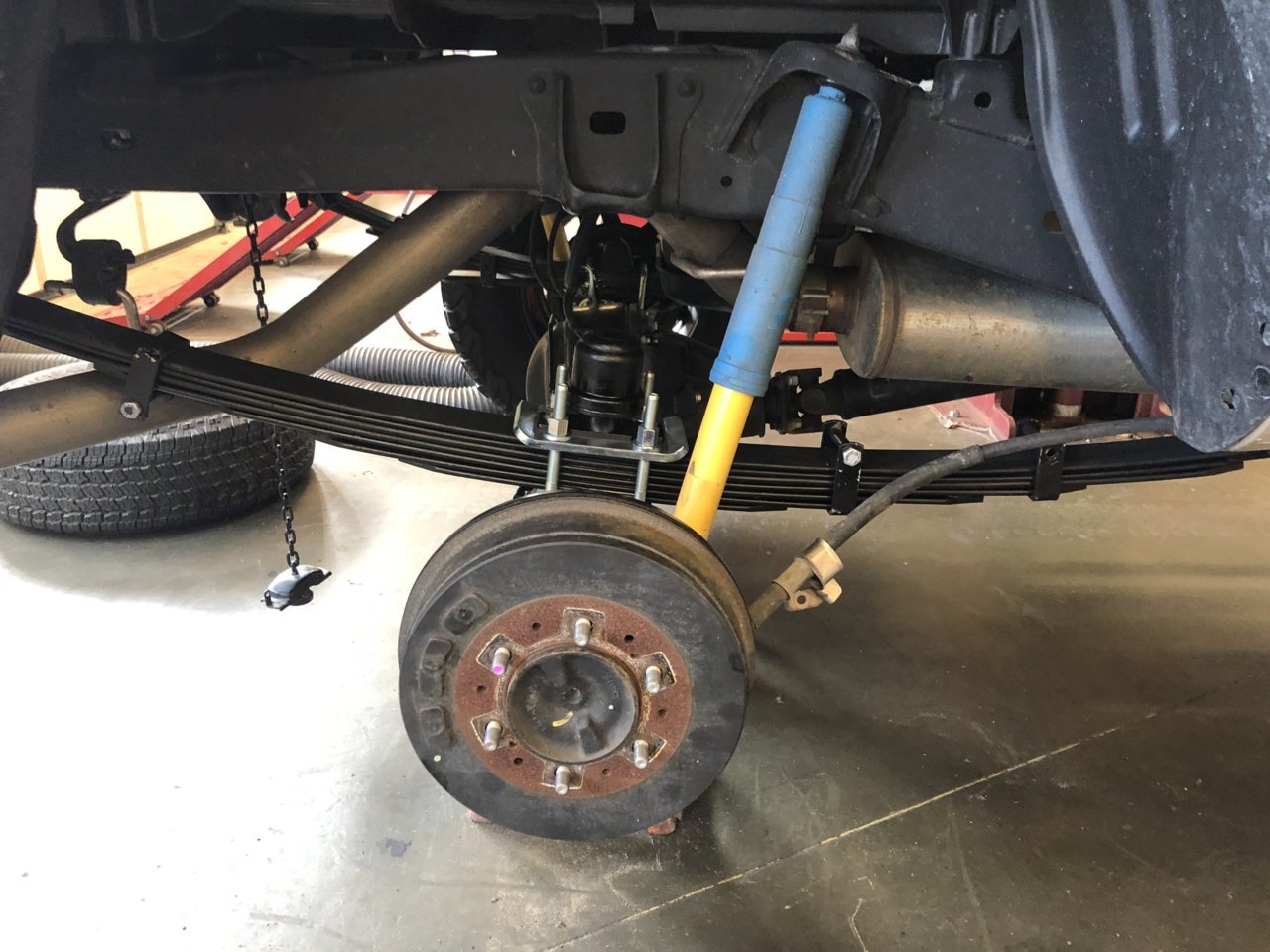

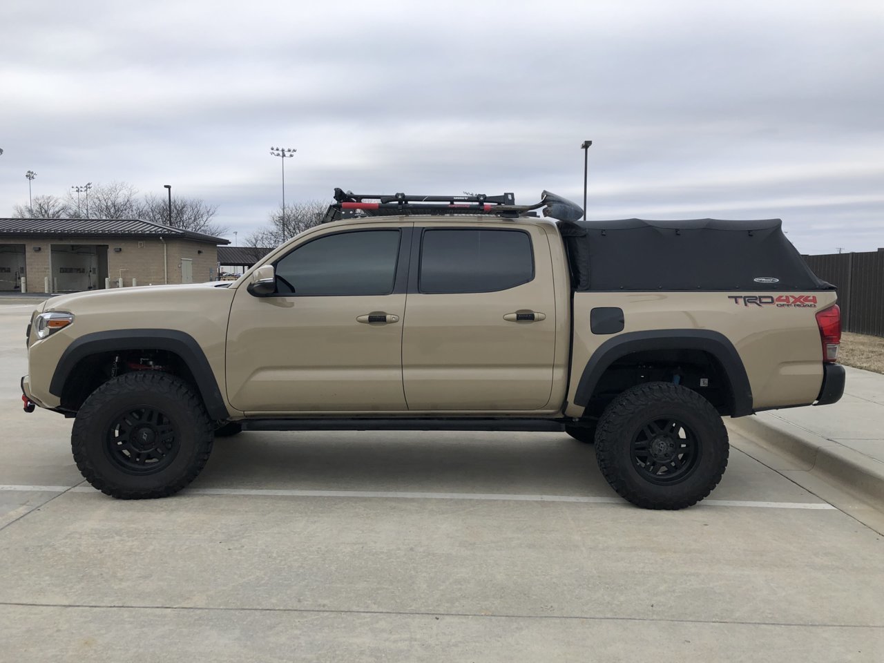

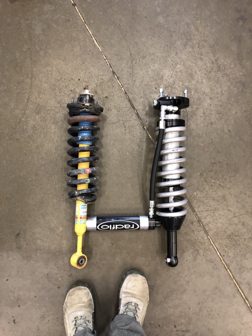

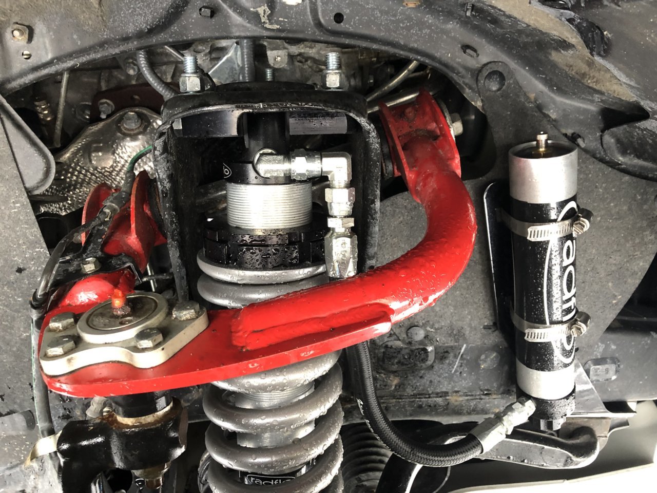

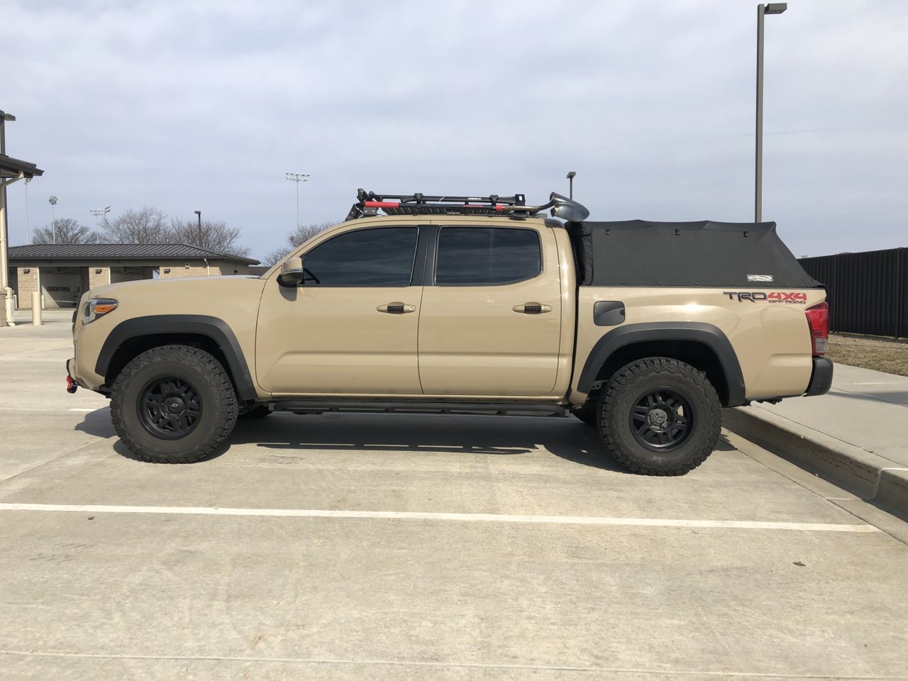

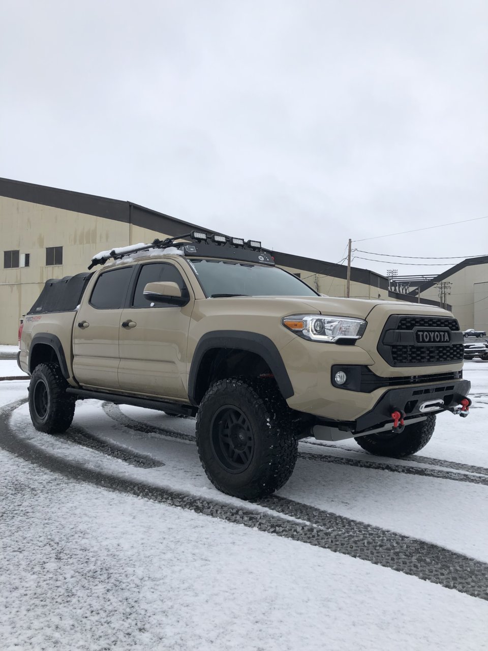

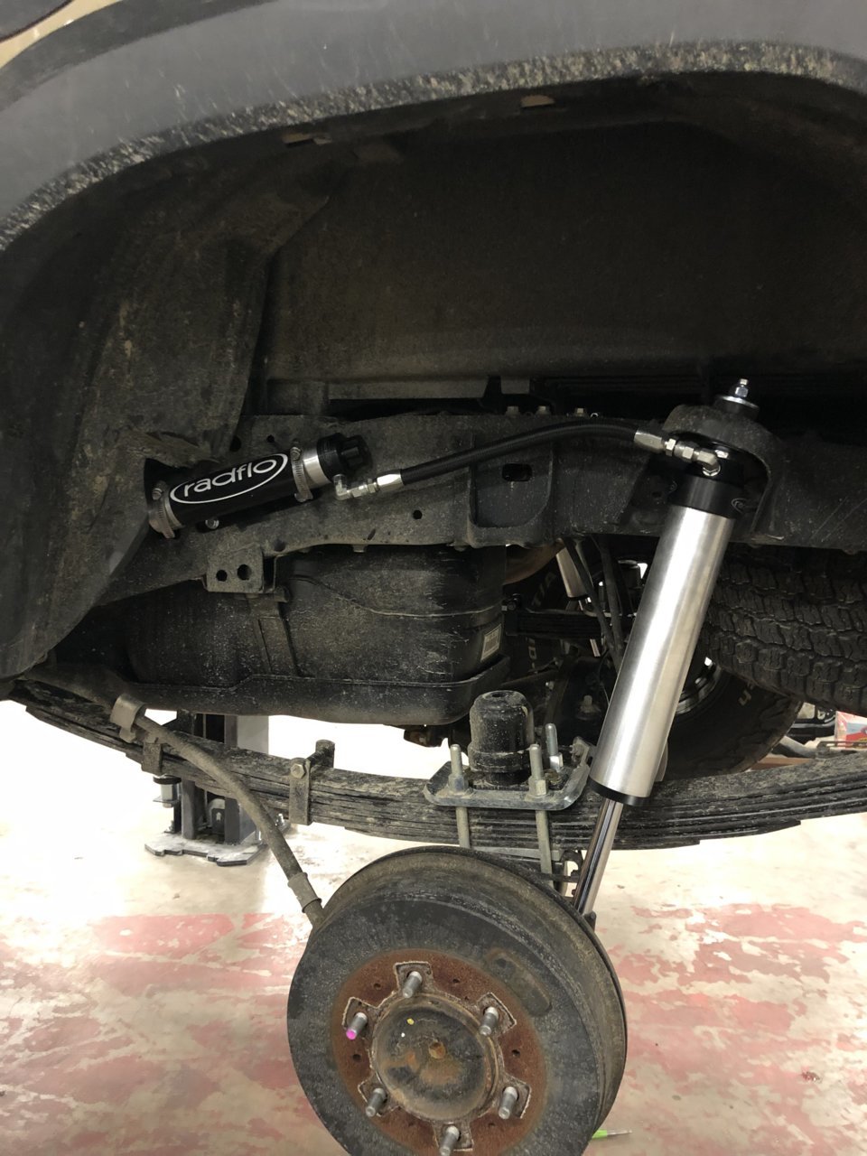

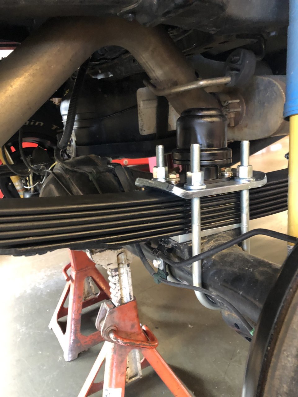

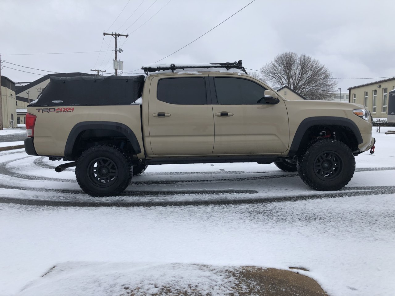

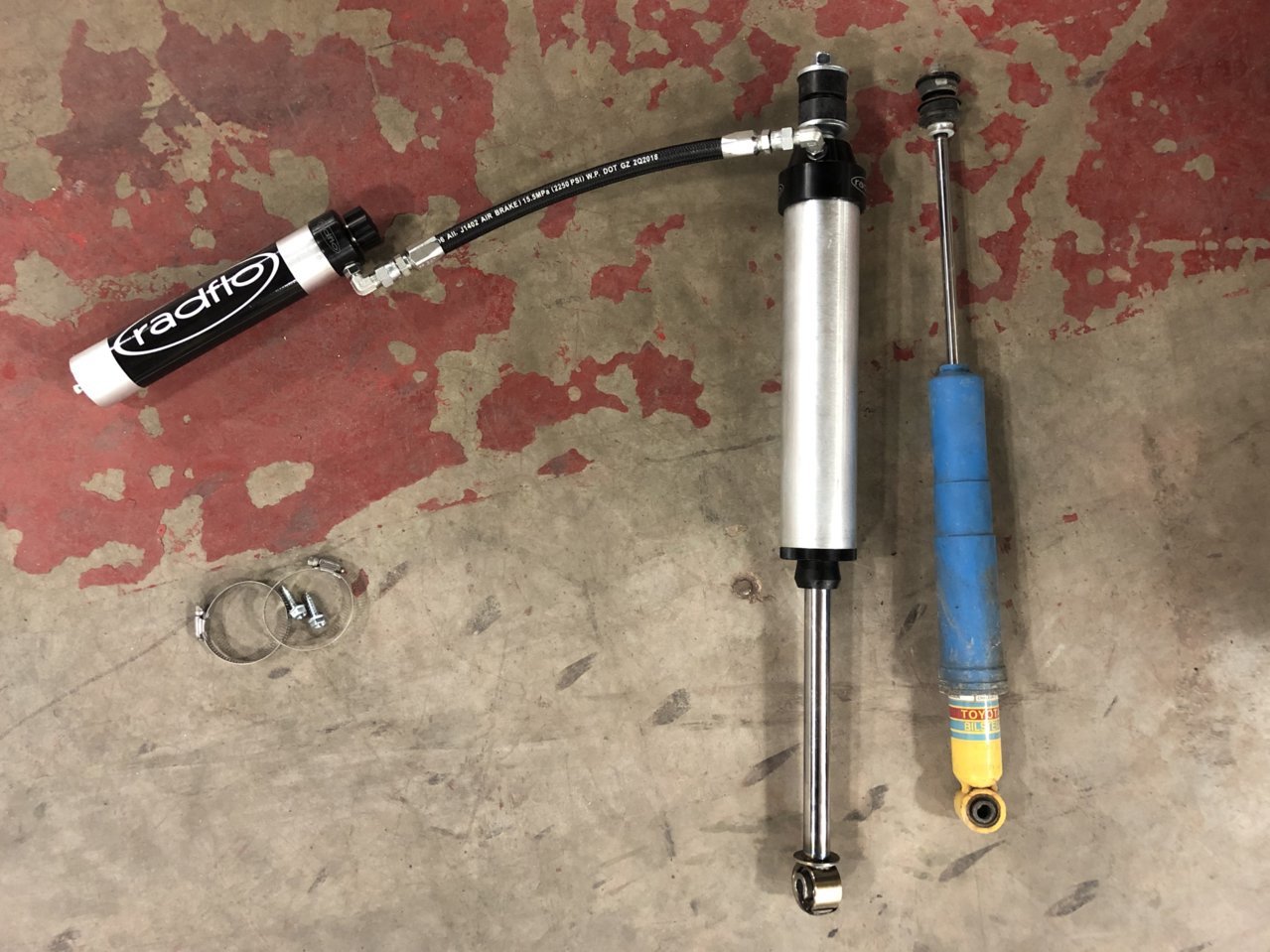

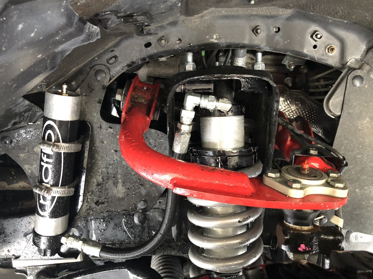

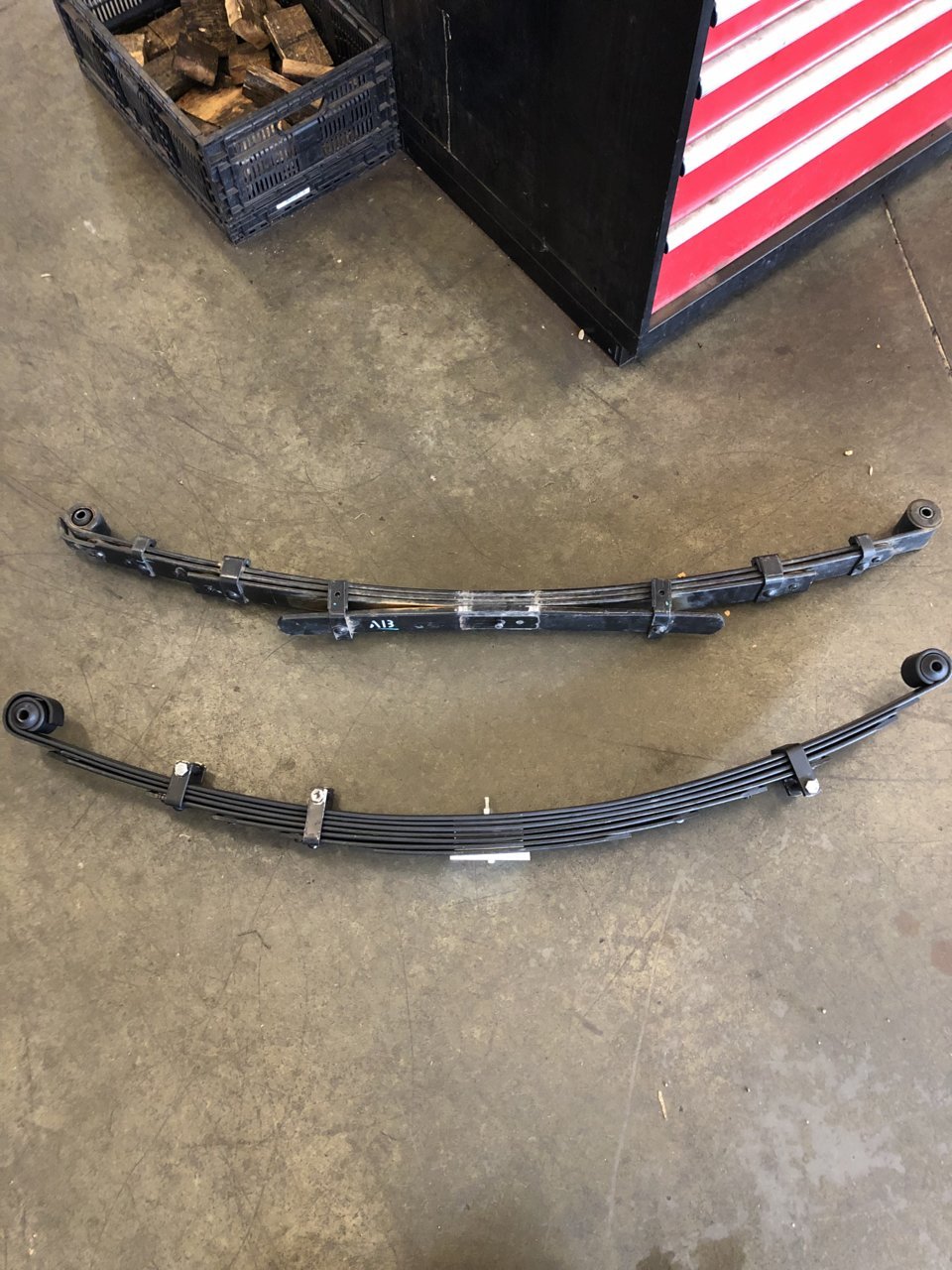

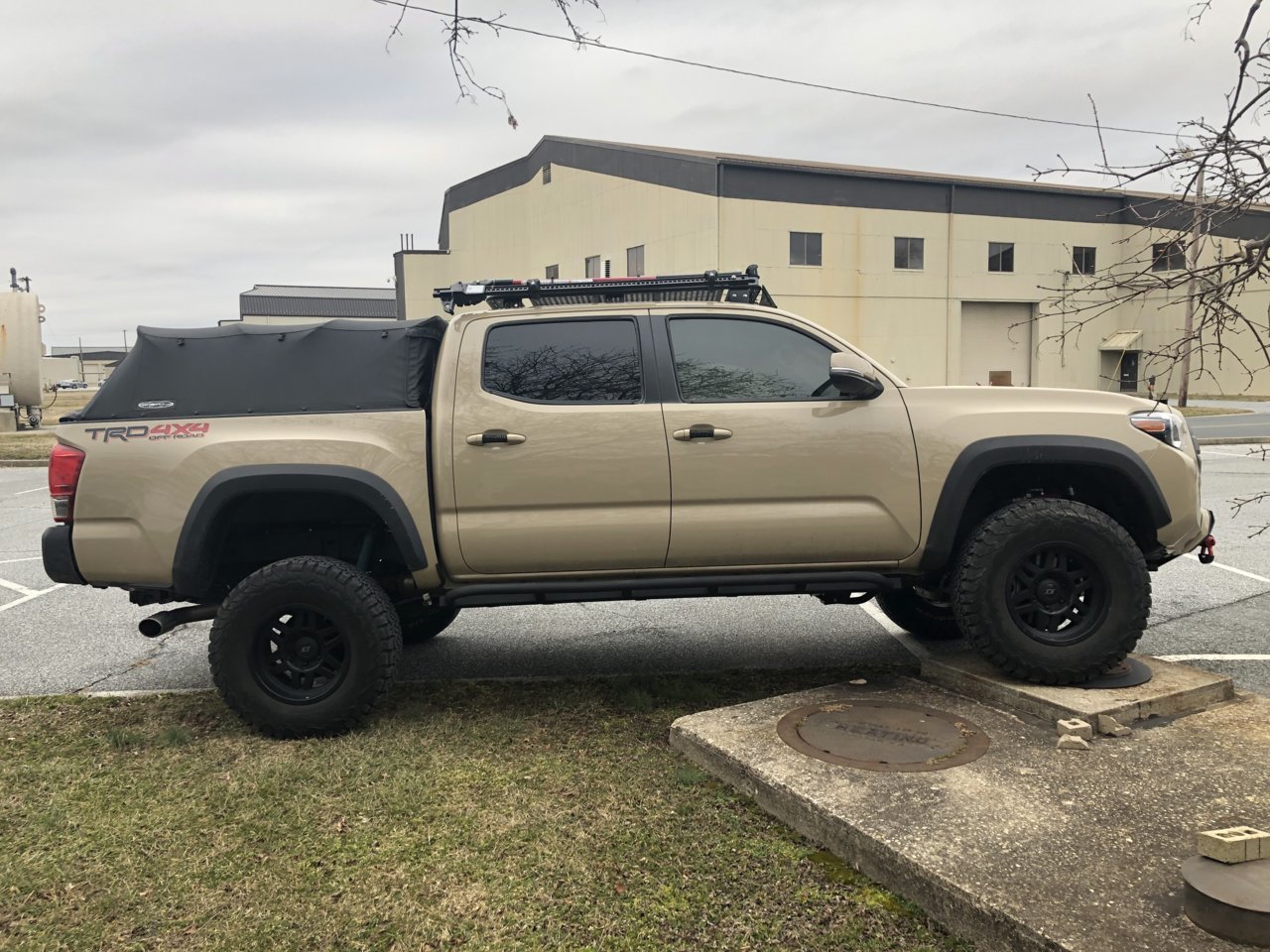

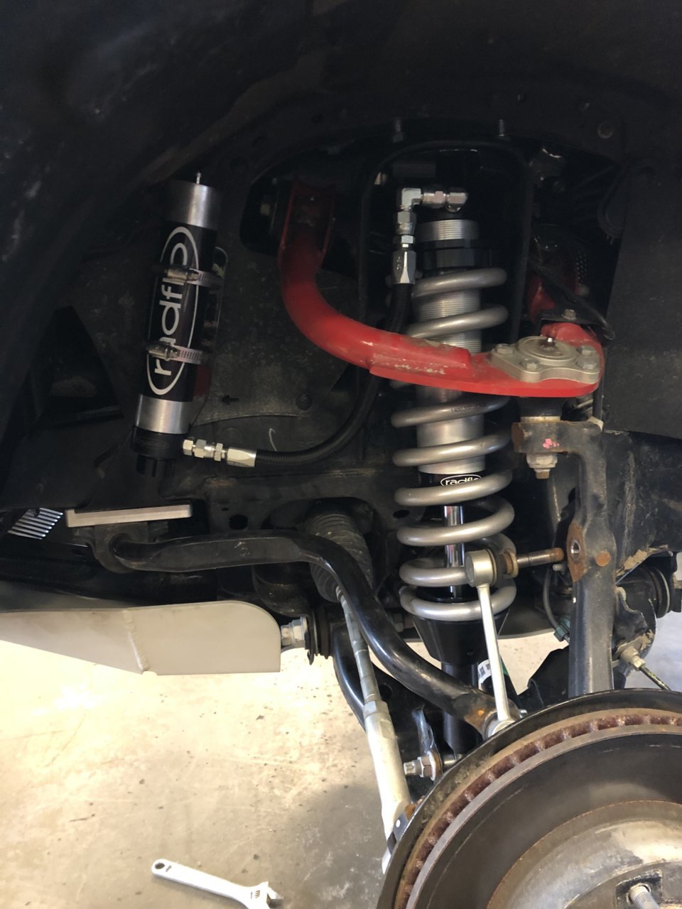

    So, I got the coil overs on today, my rear RXT leaf pack with the @Wheeler's Off-Road Inc u-bolt flip, and super bumps (lots of pics below to show). Overall, I went from 21" in front to 23.5" and still have just over two inches of down travel. Rear went from 22" to 24.5"ish, and I plan on keeping the 1 inch rake. I will say my front end dipped at least an inch after adding the @Mobtown Offroad bumper and winch, so really I netted around 3" of lift. I know it will settle but I am very happy with how it turned out. Right now, in front I am running on about the middle setting for compression. They came on the softest which was very plush but not good for on road and cornering at high speeds. It seems like the range of adjustment is pretty solid. The 650# coils were a very good choice for my build. I have a 3/4" of preload on passenger side and a 1" preload on the

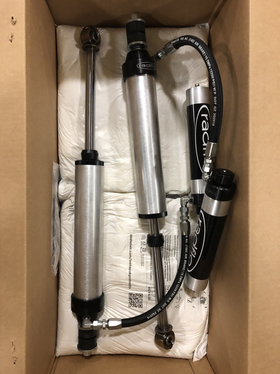

    drivers side. The @Radflo Shocks rears and extended brake lines will be going on at the end of the week.​

    Oh, I forgot to add that overall I am very impressed with the build quality of the @Radflo Shocks. I have run fox and icon and I will say that IMO these are by far superior to their products (I cannot speak to King, ADS, OME, or Ellka which I think are all great). The design is simple and doesn't have all the flashy appeal some of the larger brands may have but these things are solid. With my Icons I had all sorts of issues during install with bolts being cross threaded and things not going together well. These went in very easy and so far have exceeded my expectations.

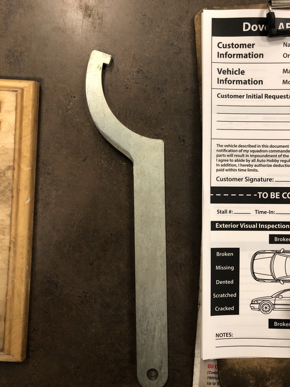

    Last thing to add, hahah. Spanner wrench and the placement of the adjustment slots definitely sucks. Only negative so far.

    Hey it looks great! Are you on ext travel ? It looks like stock ucas painted but cant tell

    I agree with you here- I had to grind the spanner wrench to make it work

    I am running ext travel with JBA HD UCAs. Best UCAs ever IMO. I had TCs on my last truck and they were so damn squeaky.

    I did the same thing haha.

    Truck looks great. I dig the stance with the 1” rake.

    Ok, after driving it for 2 days I wanted to remeasure. The rake was at almost 2 inches so I readjusted. First, I filled up my tank. Going from empty to full dropped the back from 24.5” to 24” so not bad. After that, I adjusted front coils to get me to 23”on both sides. That way my rake will be between 1-1.5”. I still have several inches of down travel in front. I will measure after I get it back from alignment. Below are some pics of the stance now. I have 1.75” of preload on drivers and 1.25” on the passenger.
    For weight reference the
    @Mobtown Offroad bumper = 70lbs
    Engo SR10 = 64lbs
    @Mobtown Offroad sliders = 140lbs

    Rears went on today. Then I took them to some dirt roads and tested the whole set up out. On road I am running compression pretty much right in the middle. Offroad I dropped it to the softest setting and this rig floats. I got up to about 45-50 on some pretty rough dirt roads with washed out areas and potholes all over the place and felt none of it. At of the previous set ups I had (icon and fox) this ride is far better. Granted I took a lot more time and research with this build, and it was worth it. Very happy with @Radflo Shocks so far.
