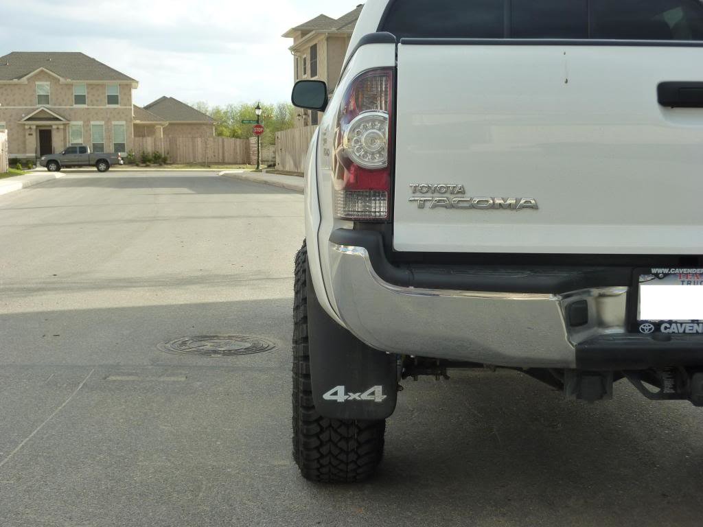

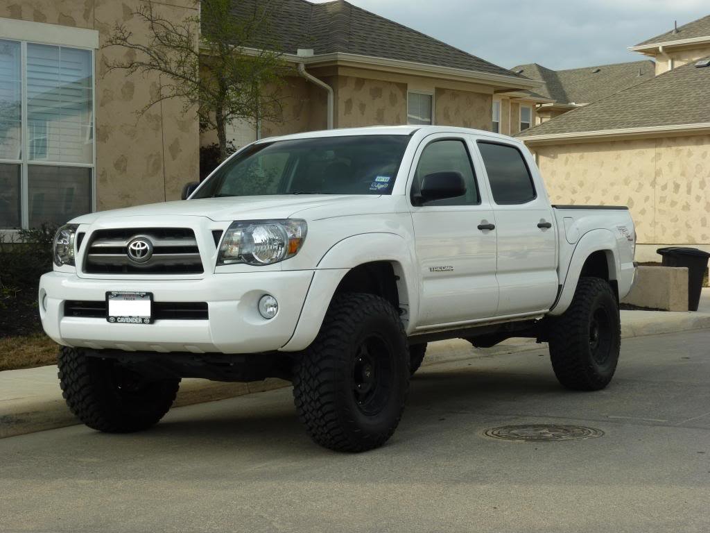

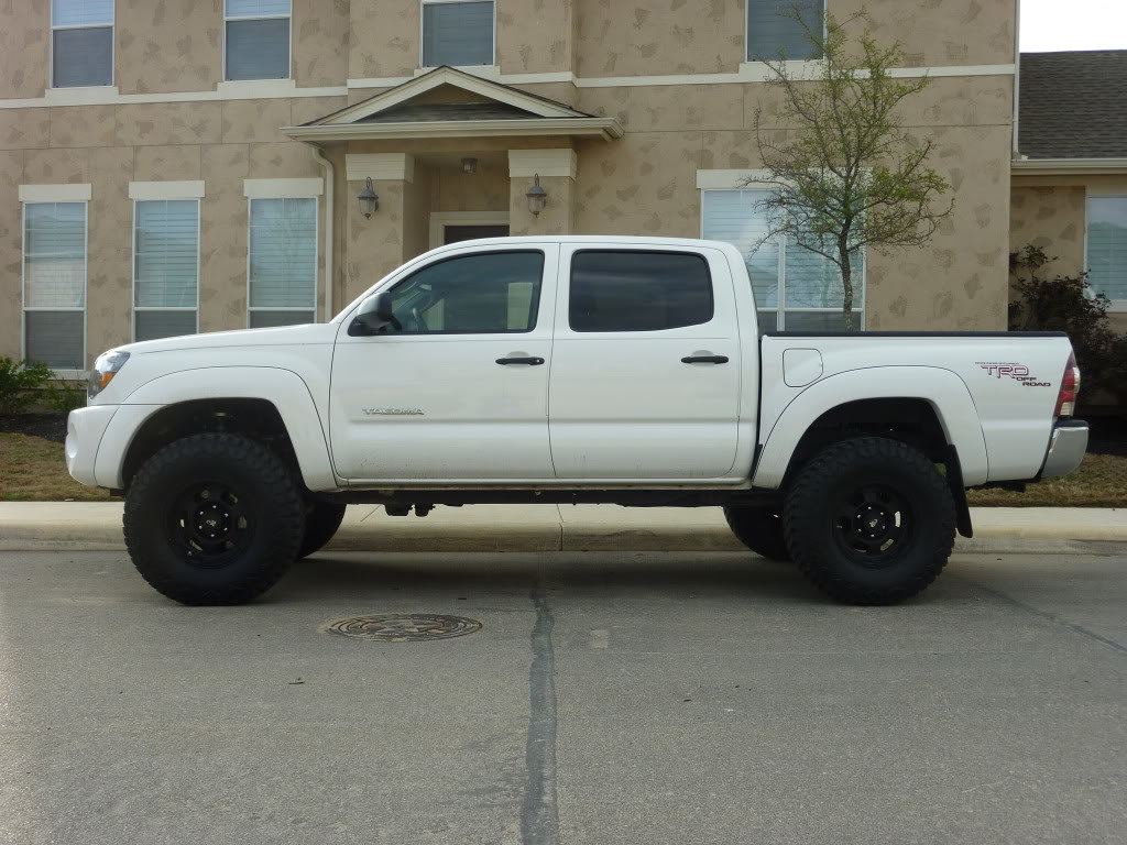

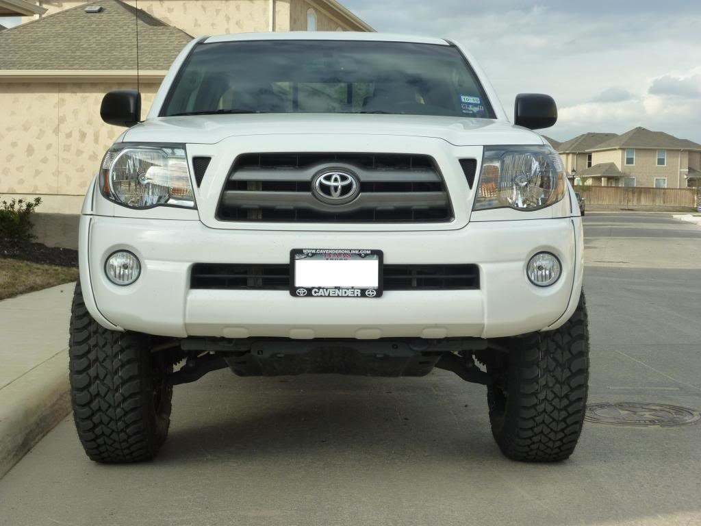

    Finally had the time to install my Radflo CO's and Toytecs AAL. The Radflos are 2.0 non-resi and adjustable, they use a 600# Eibach spring. The ride is firm as expected but very balanced front to rear. I also installed shims and a homemade carrier drop w/ the AAL. The wheels are Procomp 7089's 16x8 w/ 295/75 16 Dynapro Mt's. I know, another white truck w/ black wheels, but it's my white truck w/ black wheels. I love the way it turned out! Sliders and skids are on order and a front bumper is soon to follow. I want to thank you guys, I researched the crap outta this and this site helped in so many ways. Here are some pics.

    Looks nice. Tires rub? Are the 295 just wider than a 285?

    Thanks. On road they barely rubbed on the inner plastic fender at full lock. I do plan on chopping the cab mount because they will rub there when I go off road. The 295 are 10mm wider and stand at about 33.5".
