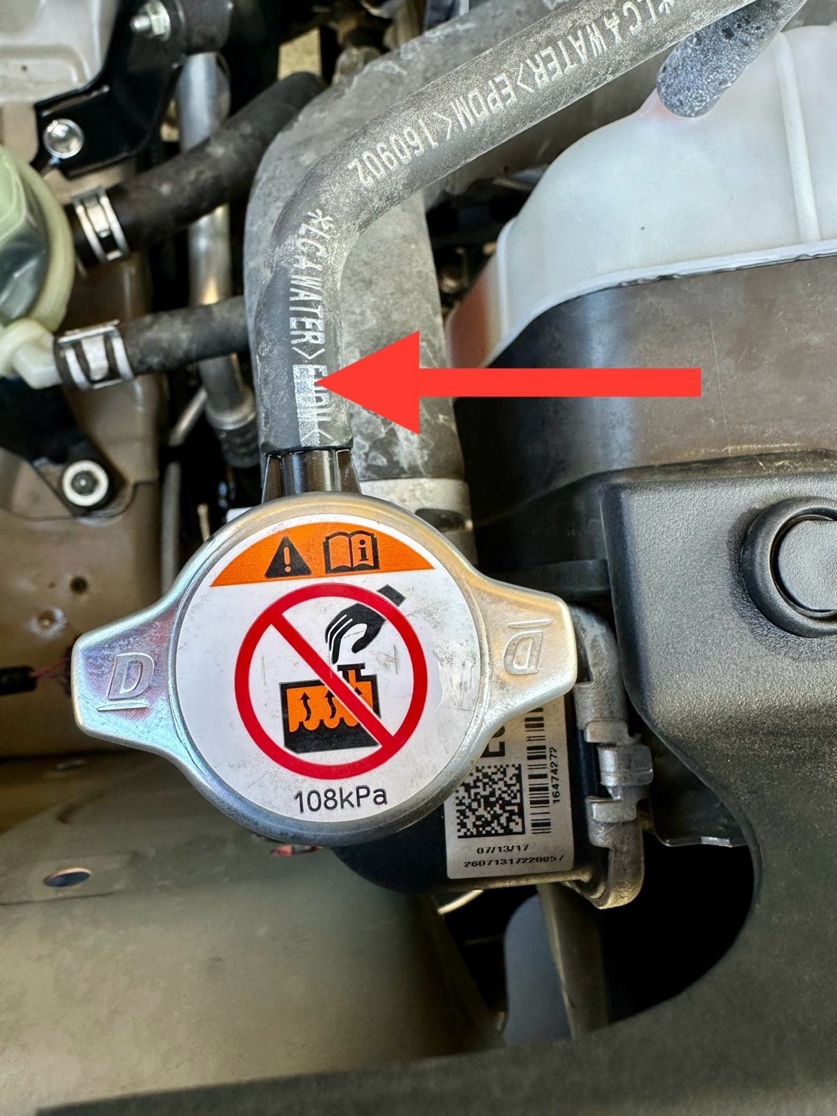

    Weird question, but can anyone with a 2016-2018 post a picture of their radiator cap?
    I recently had my local stealership do a coolant flush. Since then my coolant overflow resi hose has been blowing off the radiator. Causing coolant to shoot all over the engine bay. I honestly have no clue what is causing the excessive pressure buildup. But I’m wondering if they lost my stock radiator cap and just stuck on something that seemed to fit but is causing excessive pressure buildup.

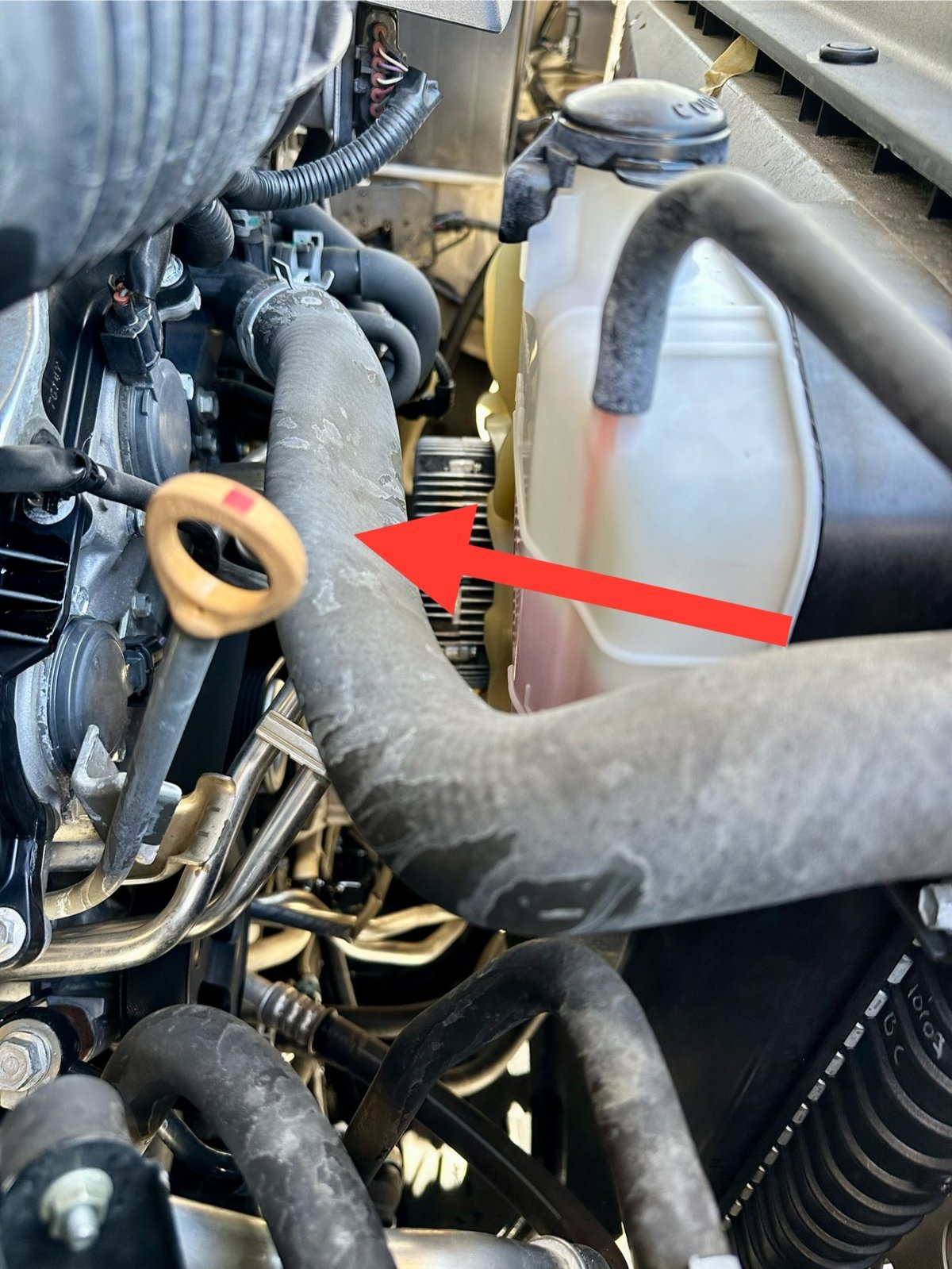

    I’ve also noticed that the top big hose that goes into the engine is going flat when cool. Almost indication suction. Again, no clue if that’s normal.
    Pictures below of my current radiator cap with the overflow hose that’s blasting off. And the best pic I could muster of the ‘flat’ hose that likely shouldn’t be flat.

    Upper hose, collapsing, as generally cost from a bad radiator cap. Order a new one from Bam or another online retailer

    Should there be clamps on both ends of the overflow tank?

    No, and they shouldn't have touched those anyway. Sounds like a tech was distracted or mad that he got a coolant flush (can't make time if they're done properly, lot of line guys avoid them or rush them)

    Nope, it should never be handling any pressure (or vacuum)
    You're saying the same little overflow hose is the getting blown off and collapsing? If yes, there is either a blockage in the hose or the plastic reservoir. Take the hose off and see if you can blow through it. Same with the passage in the reservoir. Something got stuck in there. Like maybe sludge.

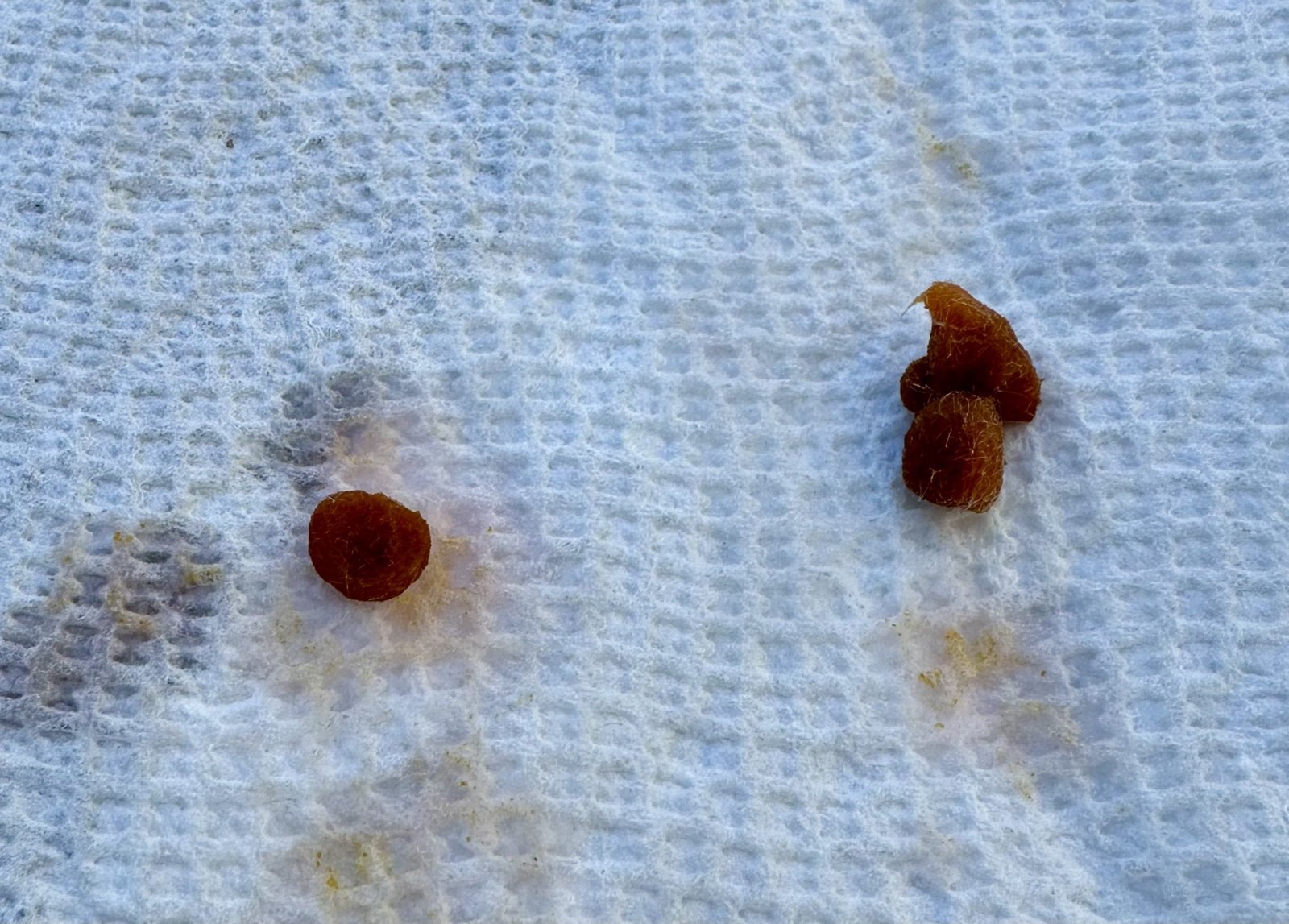

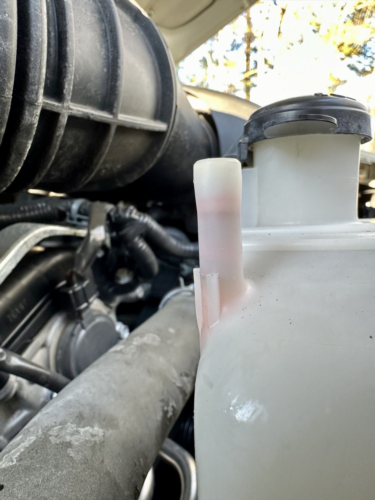

    Already pulled the overflow hose this morning and flushed out this shit. The inlet spout looks clogged too. Who knows where else this buildup probably is…

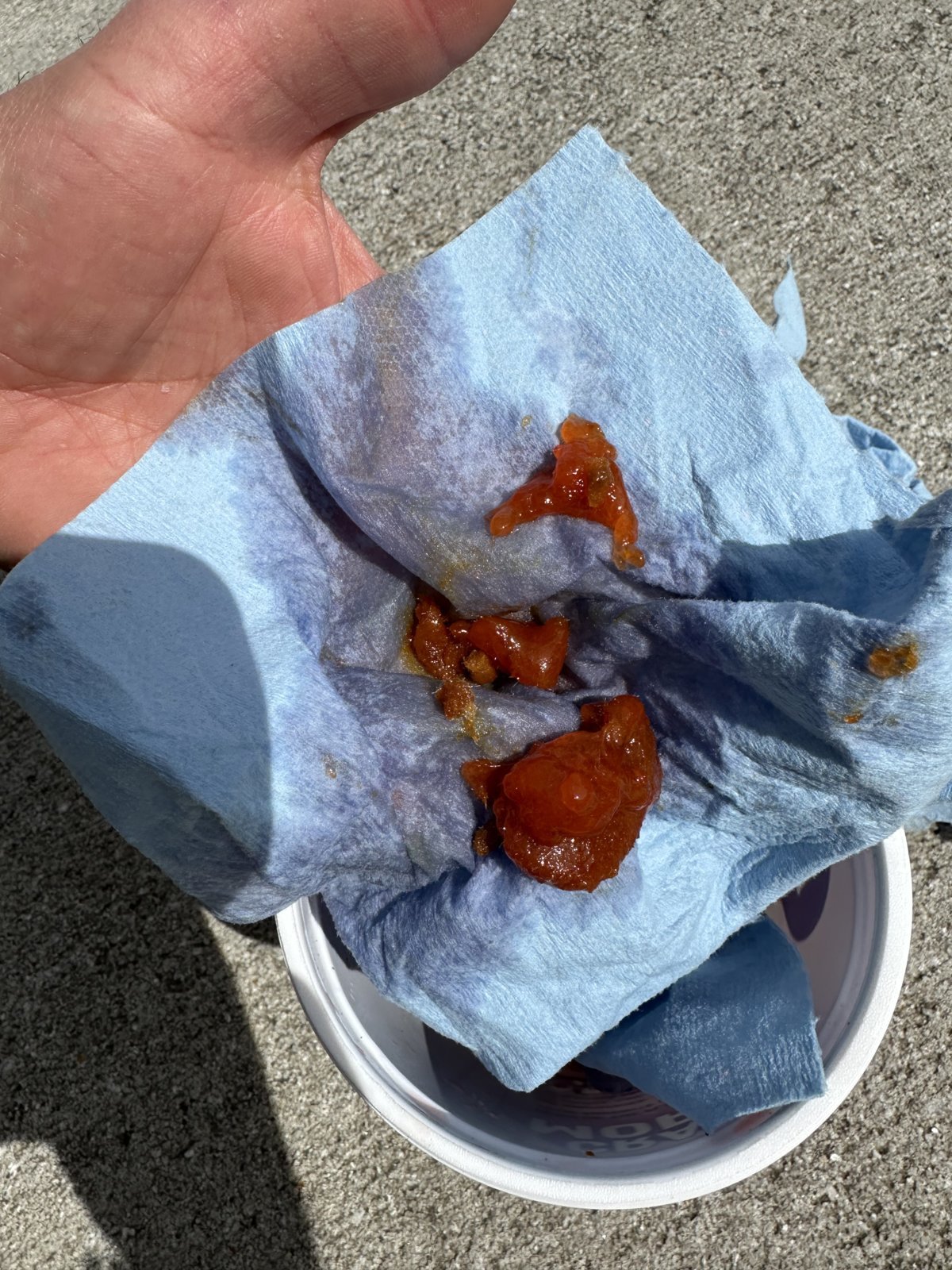

    Here’s the shit I just fished/flushed from the reserve tank. The hose from the reserve tank to the radiator was clogged, as was the reserve tank inlet.
    Lesson learned on the stop leak shit. Hopefully I haven’t future fricked myself…

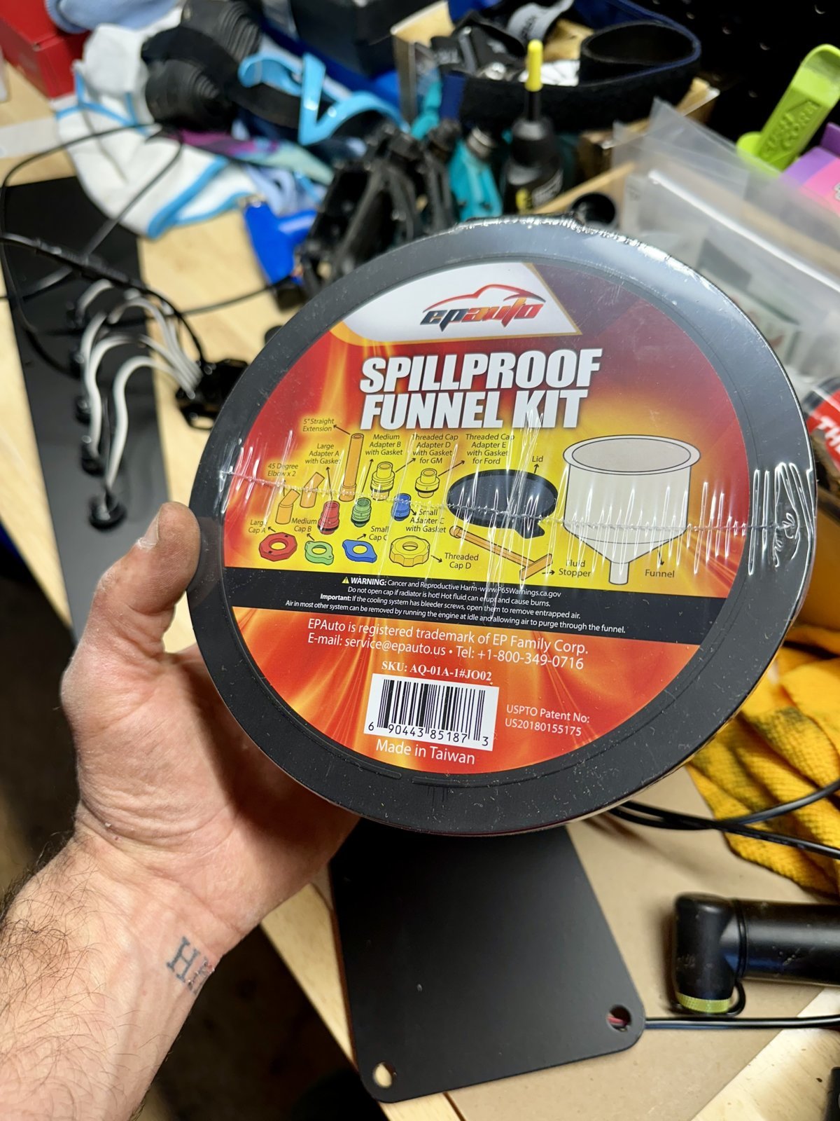

    Thanks for the suggestion. That one looks to be a nicer version of the Amazon special I’ve already purchased.

    You’re good, there are dozens of funnel kits available. I need to buy one, I’ve borrowed one several times

    Hobo freight ones seem to work just fine
