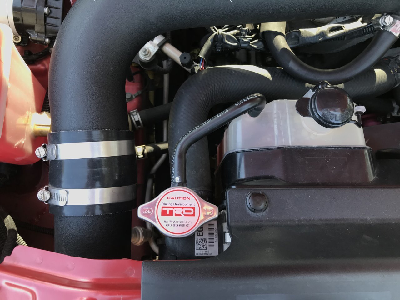

    I'll be following this thread, as I'm over the 100K mark and may need to replace my radiator cap soon just as a preventative but have been eyeballing the TRD rad cap to supplement my system with the supercharger.

    I just put a TRD cap on my 2013 v6. Its purty, but no difference in operating temps. Every little bit of added protection helps though

    This is good to know actually! At this point there are so many manufacturers putting out garbage car parts that don't even work for their intended purpose so it's good to know the TRD one actually holds pressure, it's either between getting a new OE cap or the TRD one. I don't trust other manufacturers now after I've seen so many others defective right out of the box.

    Top notch as far as quality goes!
