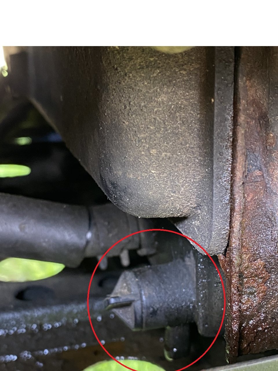

    Hello Tacomaworld,
    Can you help me identify the port that is leaking out of the bottom of my Radiator?
    I think its time for a new Radiator but I was curious if anyone can identify the port in the photo. I am planning to replace the radiator and new houses all around. Does any one have a parts list for this type of repair? or a link to a talk thought!

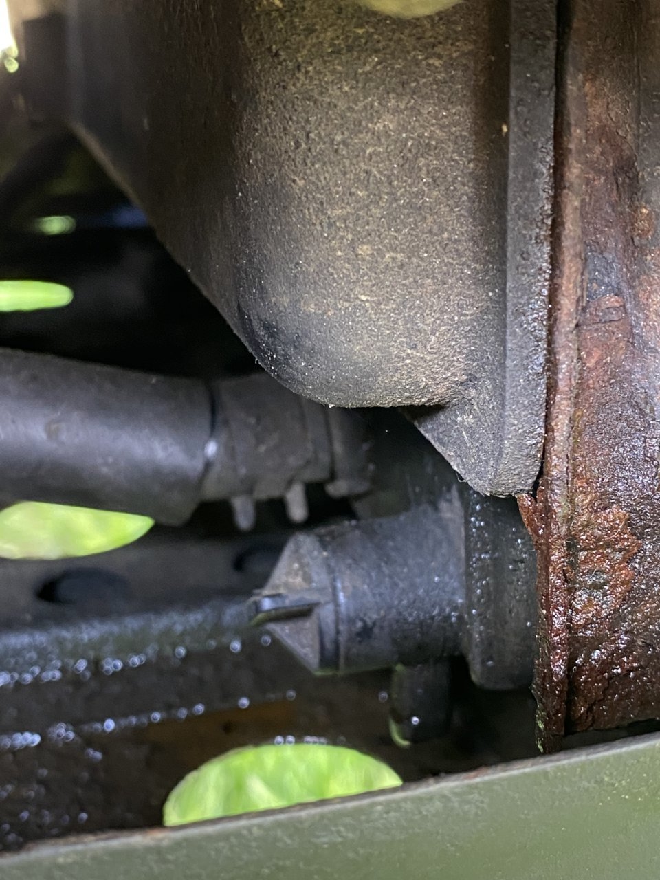

    Upon further self research; this valve "petcock" is probably not leaking but more likely I'm seeing fluid from the rusty radiator, its just collecting on the "petcock".

    Are you talking about the circled area? That's the radiator drain port.
    EDIT: looks like you figured that part out already. Look at the top plastic portion of your radiator and you may see some hairline cracks. That's where mine failed before I replaced it.

    yes what is circled. I tired to move it by hand but Its tight on the treads.

    Being tight don't mean anything. Most radiator manufacturers use oring and over time, they dry rot.

    Yeah this is true! O rings die with time. I am still planning to replace the radiator and upper and lower lines.

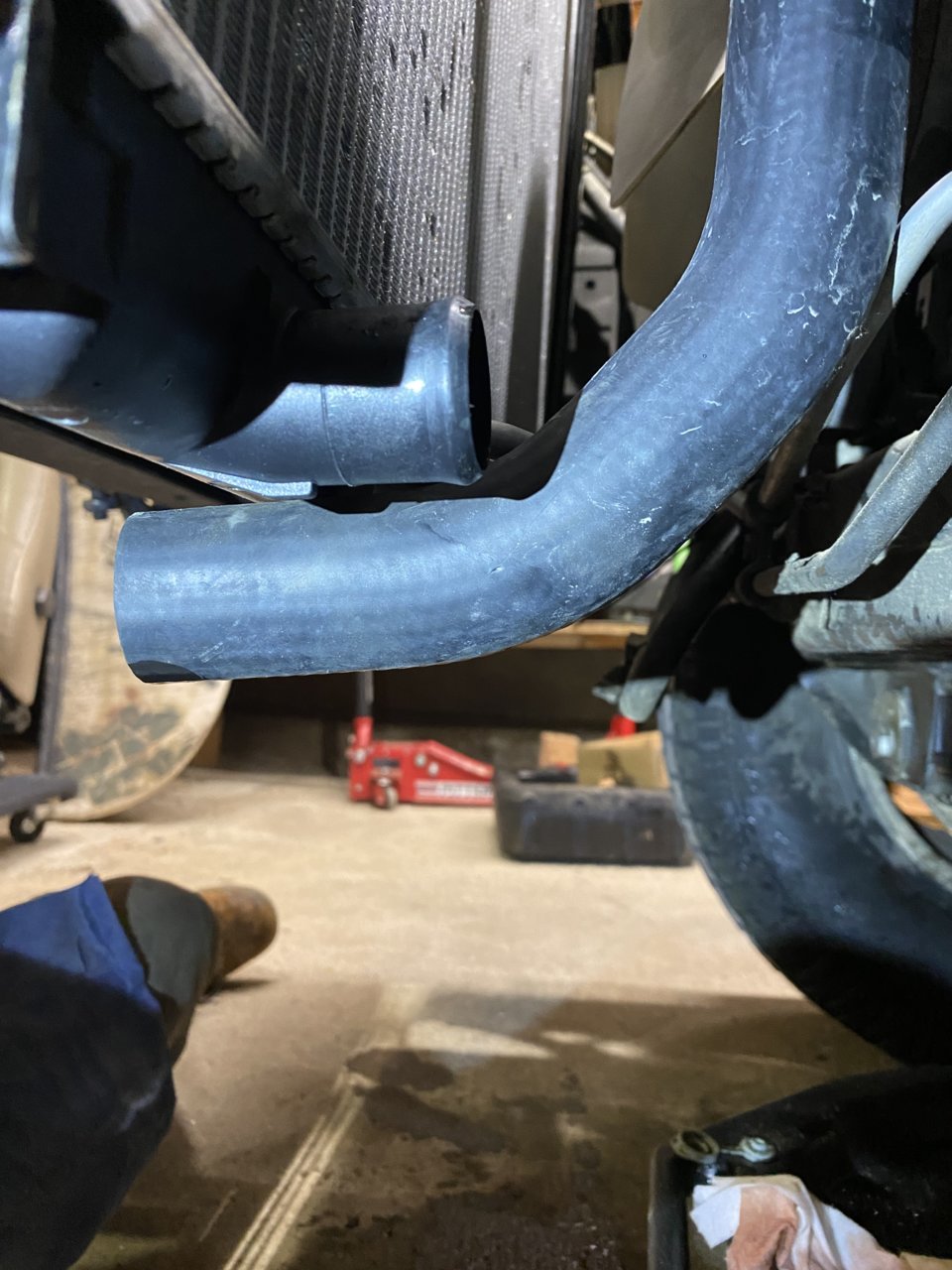

    Well well well, thank you all for your input and some advice! I busted out this radiator swap after work last night and it was not easy but very manageable for a routine repair.
    The hardest part was getting the new radiator to line up with existing holes in the truck. IF YOU HAVE AN ARB BUMPER you will not be able to get your grill off to easily access the radiator bolts. I'm sure this is a non-issue if i went for the OEM part but I needed to get this fix done faster than waiting 10+ days for the parts to come from Camelback Toyota in AZ--- the East coast.
    The Continental upper hose fit like a glove.
    the Continental lower house required some cutting* see image below*.
    Yes I used a red/pink coolant. IMG-8458.jpg
    Glad to have this job behind me and back on the road.
    The above image is about how much you need to cut off with a SHARP razor blade!
    Below: Using extensions to go through the grill. I loosened the grill and popped some clips but could not remove it because of my bumper.

    Awesome feedback. Just as a FYI, I had to swap over my OE side radiator brackets because the new one that came with the Denso rad was off by 1/4". After that, it went in like a glove.
