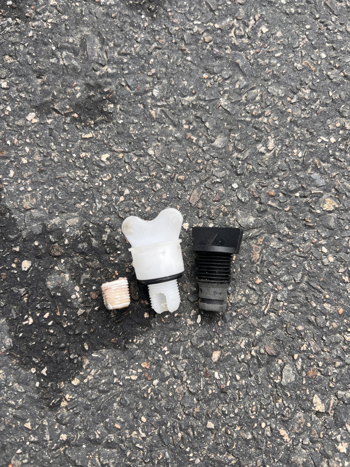

    So the drain plug that was in my radiator broke and I’ve tried every possible way to find a replacement with no luck. The part that is supposed to be for my 2000 Tacoma is the opposite of what it needs. I even looked up the part number on the radiator and it shows the same plug that I already have. What it needs is the type that has the threads at the bottom but the suggested part has the threads up top. If anyone could help it was be greatly appreciated

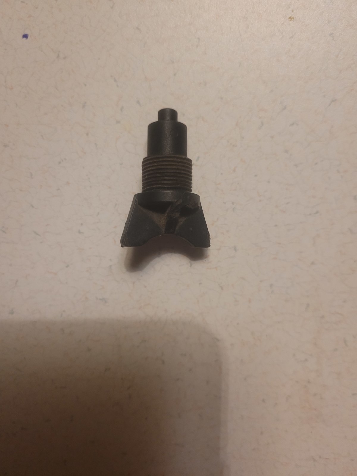

    Try to glue it back together and take a pic, then do a Google search using the Google camera. Or look all over the radiator for a model number molded in the plastic , search that way instead of by your veichle info.

    Thank you but that definitely won't fit.
  8. Jul 1, 2024 at 7:11 PM
    Spunkymonkey63
    Spunkymonkey63 Member
    Mar 27, 2021
    #360752
    10
    1996 Toyota Tacoma
    There is suppose to be a gasket I'm assuming a rubber gasket on the small end. Even if someone has one and can send me a pic so I will know what kind of gasket goes on the end. Toyota isn't any help they have no idea. I've seen the same drain plug on line for a jeep and a 2001 dodge, but no pic of the end where a gasket goes.Very much appreciate anyone and everyone's help.

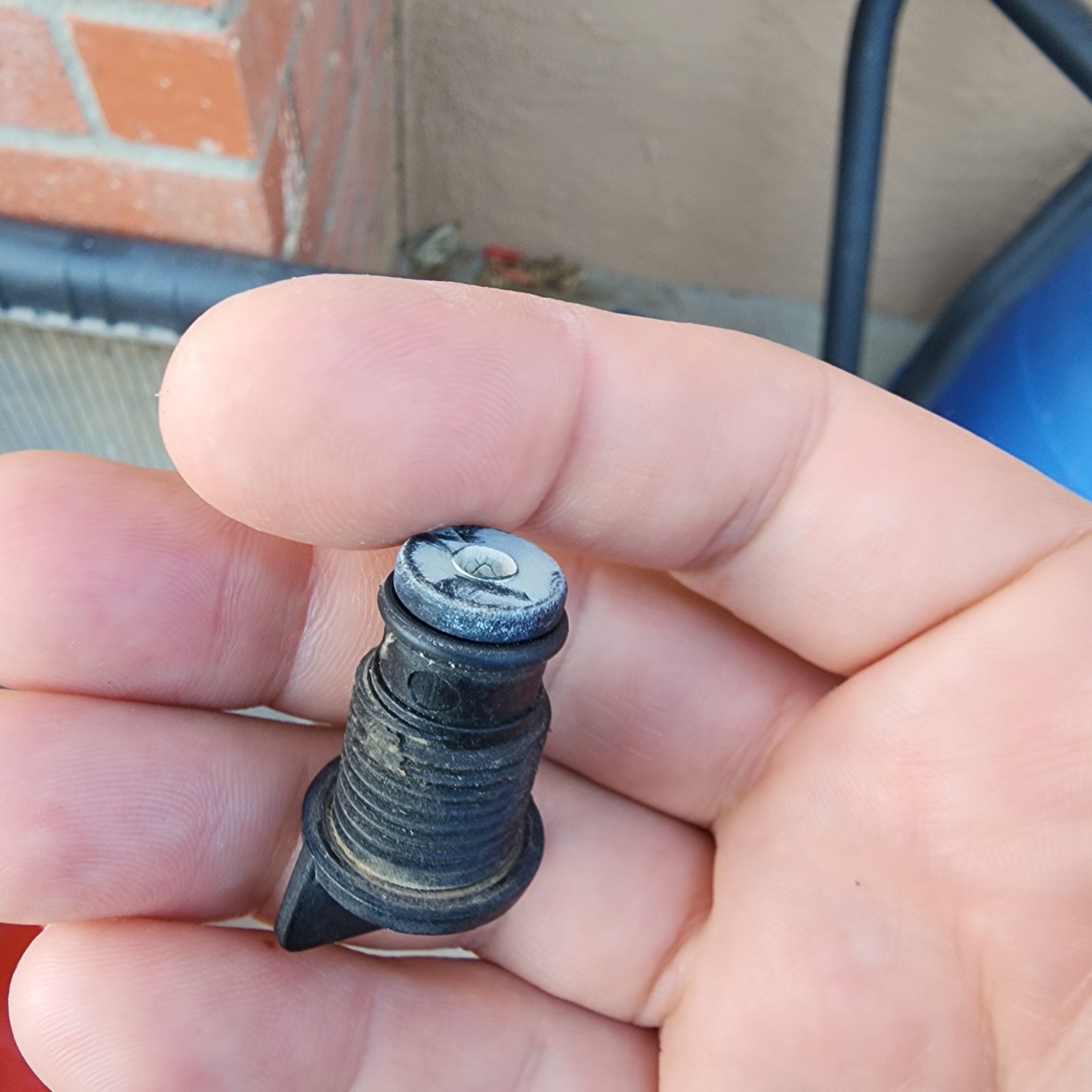

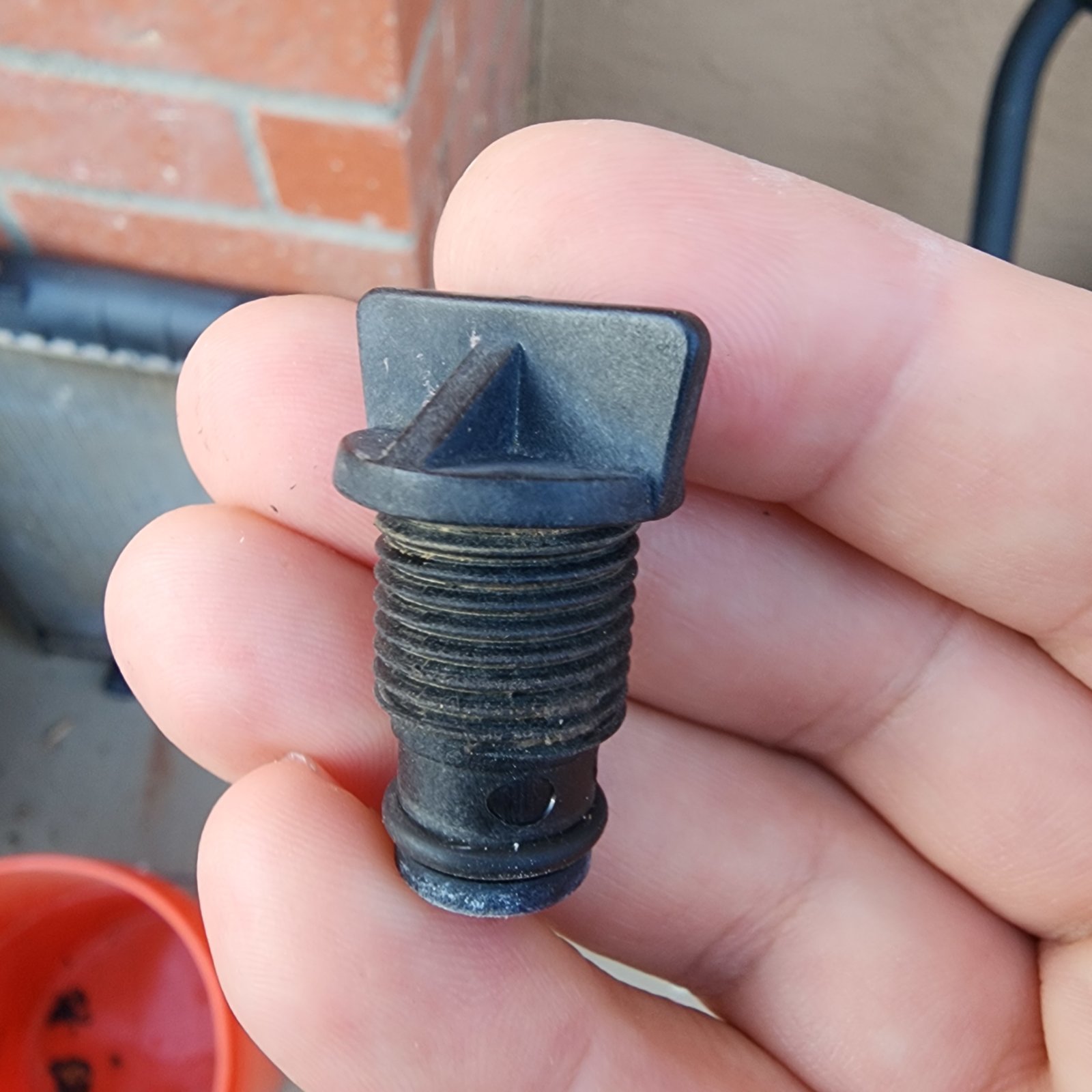

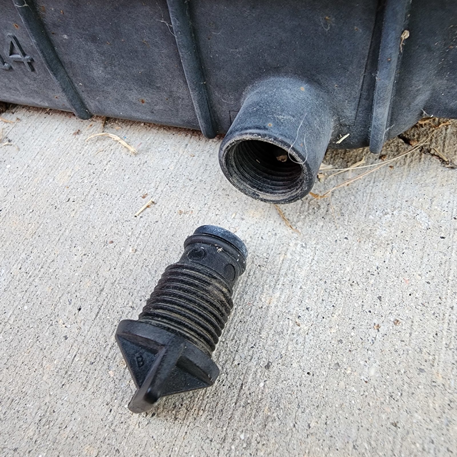

    I know OP is MIA but are you looking for the same thing @Spunkymonkey63 ?
    Lucky for whoever is needing this information I have my OEM radiator off my '02 Taco at the moment so here you go...
    No part# on the plug
