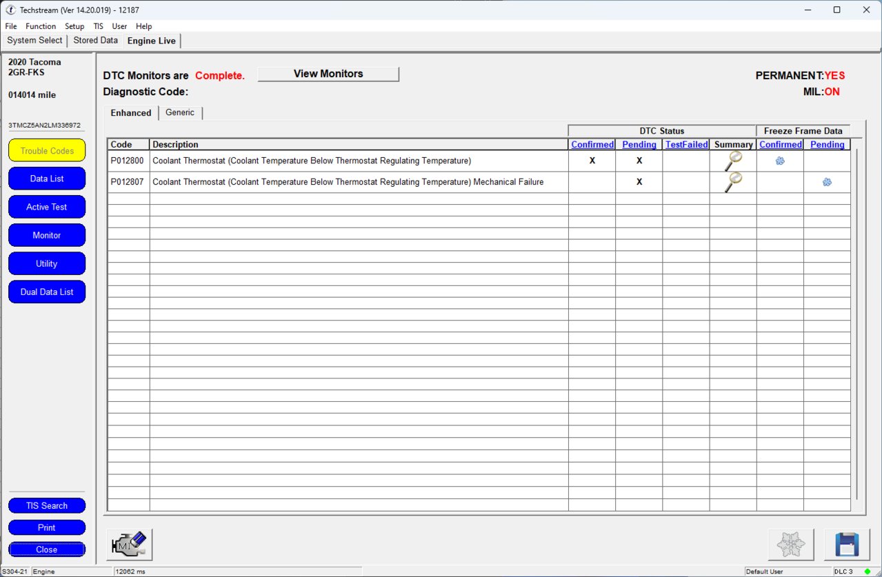

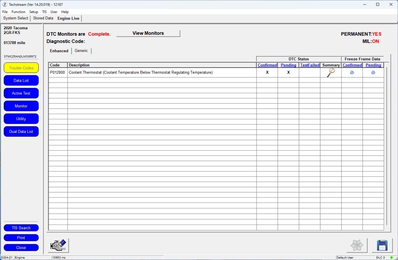

  9. May 14, 2023 at 7:40 PM
    sac119
    sac119 Well-Known Member
    Feb 10, 2019
    #282529
    56
    IL
    2020 MGM TRDOR DCSB 4x4
    Has anyone else ran into this or found a solution? My 2020 just now started doing this. 14k miles and conveniently just out of warranty. :rolleyes:
