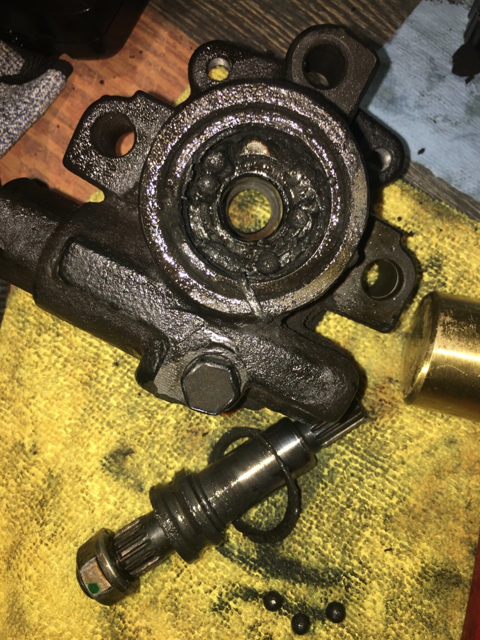

    Okay, I found the point of failure. The bearing is beyond toast, it’s pretty much disintegrated.

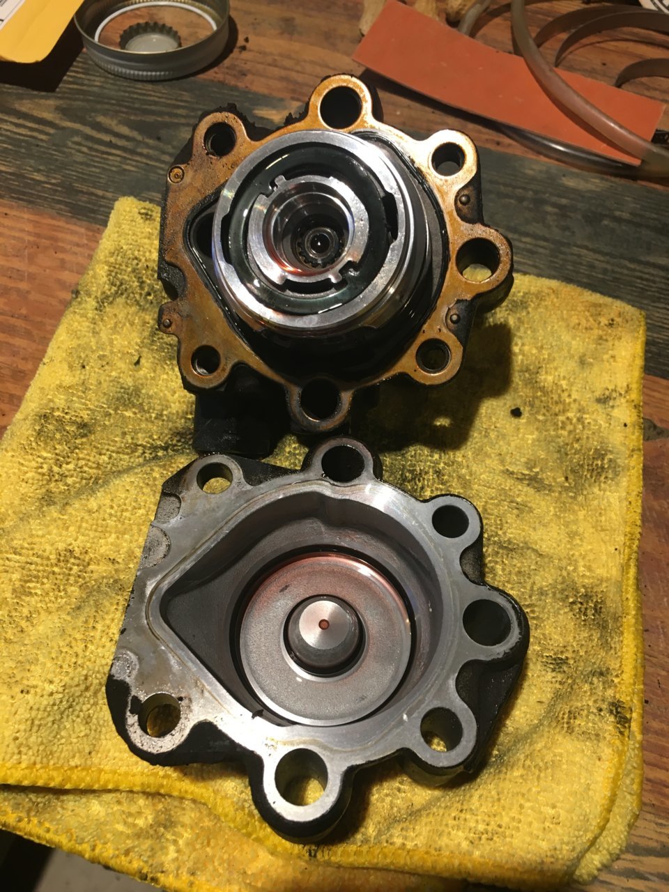

  4. Feb 27, 2021 at 9:25 AM
    #24
    halfbid
    halfbid [OP] Well-Known Member
    Feb 18, 2020
    #319628
    47
    Central Oregon
    1996 Tacoma DLX 2.7L, 5 speed, 4wd
    As to metal in the system….I replaced the fluid last summer as it was overdue and making noise when I started it cold, although the noisiness would abate once it was warm. The new fluid helped quite a bit with the noise, but it was obviously on the march towards failure. When I cracked the housing open the fluid looked clean and new. I didn’t see any hints of metal on the fluid side of the oil seal. I’m hoping this means it’s unlikely I have a metal fragment problem. I’m having a difficult time imagining how any fragments could get past the oil seal.

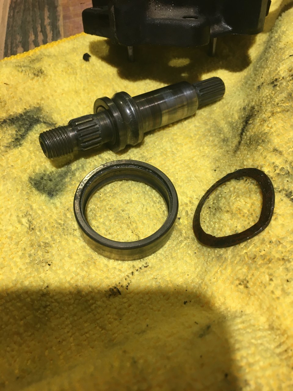

  5. Feb 27, 2021 at 9:42 AM
    #25
    halfbid
    Feb 18, 2020
    #319628
    47
    Central Oregon

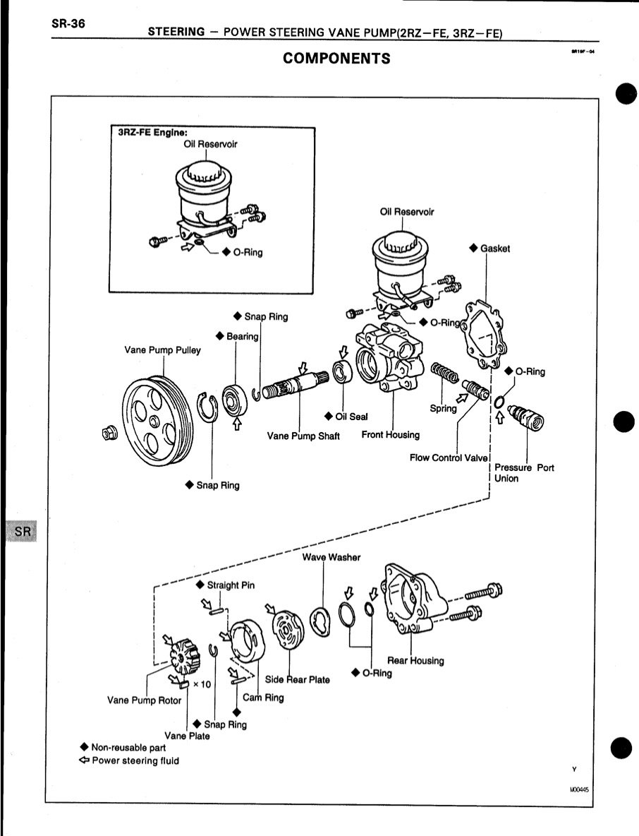

    When I removed the vane pump shaft it came right out, but the bearing had separated leaving the inner part (race?) on the pump shaft and the outer part still in the housing.
    Also, I expected to find a snap ring holding the shaft in place. The schematic shows a third snap ring that didn’t appear to be there. In fact, I didn’t even see a spot for a snap ring where they show the third one (in between the vane pump rotor and cam ring). Without the third snap ring it seems like it would be up to the bearing and its two snap rings to hold it in place.

  6. Feb 27, 2021 at 1:34 PM
    #26
    DrZ
    DrZ Well-Known Member
    Dec 14, 2014
    #144262
    1,459
    Mesa, AZ
    96 2.4L 5-speed
    The repair manual says the shaft needs to be pressed out of the bearing, so I suspected earlier that the bearing had failed since the shaft was so loose.
    halfbid[OP] likes this.
