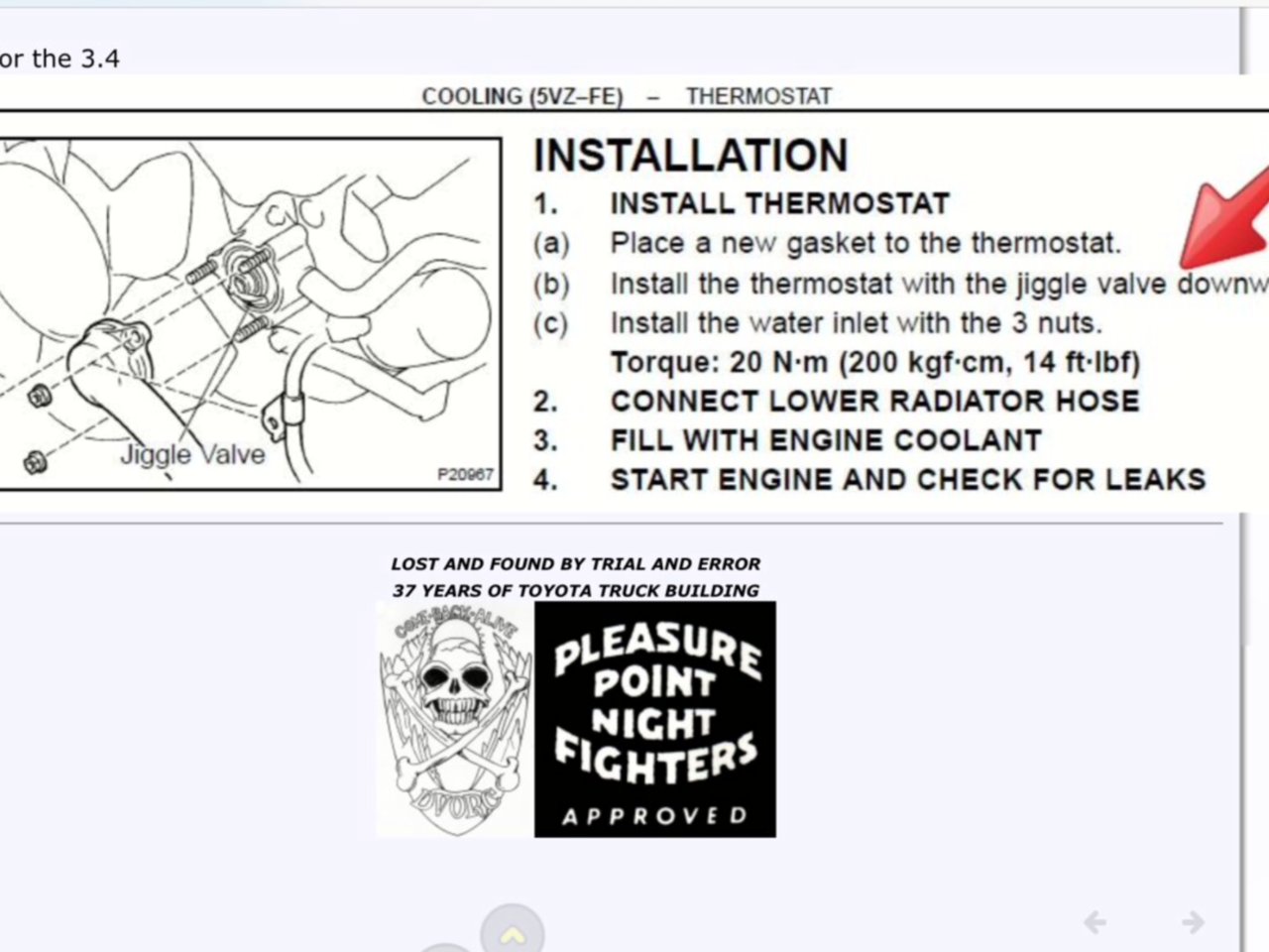

    And remember to install the thermostat jigger valve at 6 o’clock
