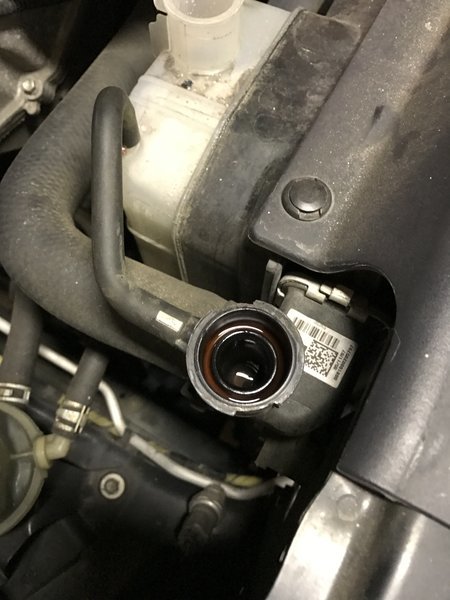

    Okay so today while under the hood I noticed my radiator over flow doesn't have any coolant. I had the dealer do the flush at my 100k mile service interval. There's no leaks in the garage where I park. I know I need to use distilled water to fill it back up. How will I know if it's leaking?

    Radiator Cap taken off, no coolant at the top. Oh, I'm at 120k if that helps

    Can't tell from the pic how low the coolant level is in the radiator. How far below freezing does it get in TN? You can get away with water if there's no freezing temps.
    Only reliable way to check for leaks is with a pressure tester (may be able to borrow one at AutoZone).

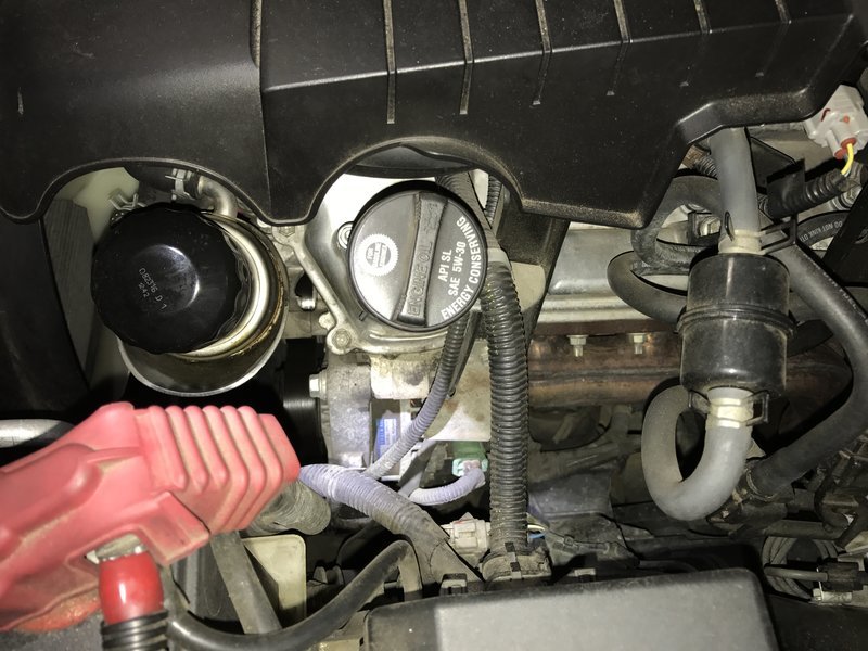

    That's what I was thinking, let me grab some pics and post them on here

  15. Jan 9, 2017 at 5:23 PM
    ZachPrerunner
    ZachPrerunner [OP] Sometimes she goes, sometimes it doesn’t
    Jul 7, 2015
    #158942
    2,963
    Southeast TN
    ‘07 TRD Offroad / ‘19 TRD Offroad 4x4

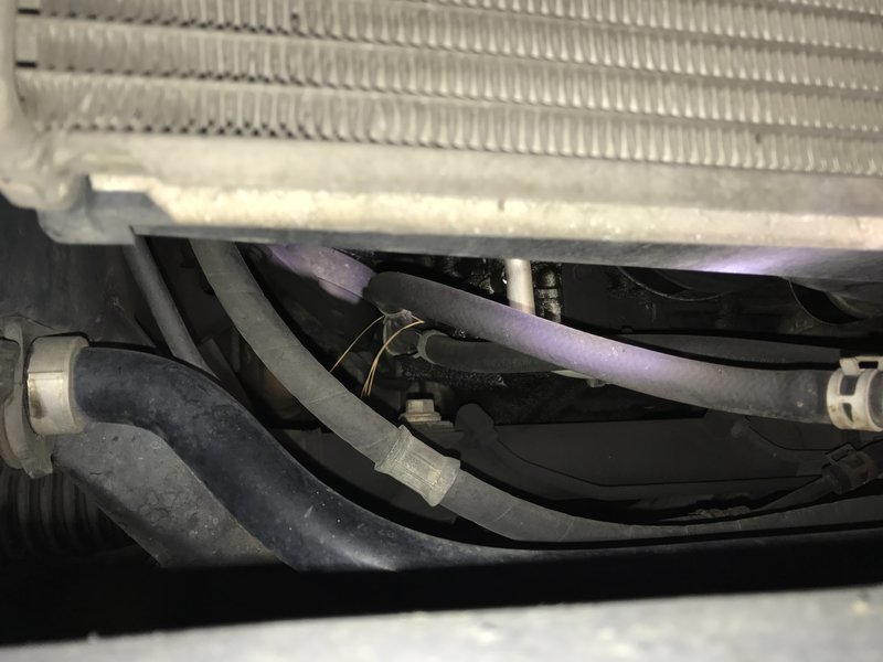

    Here's what I got so far

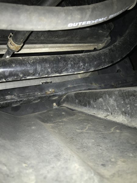

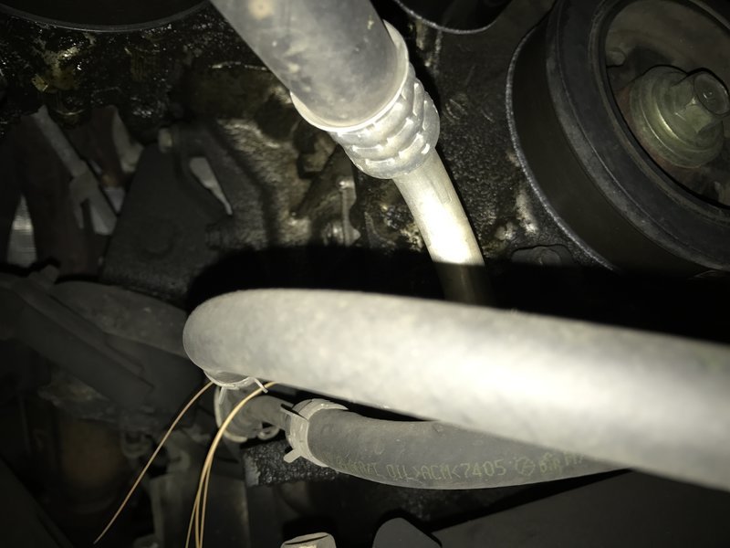

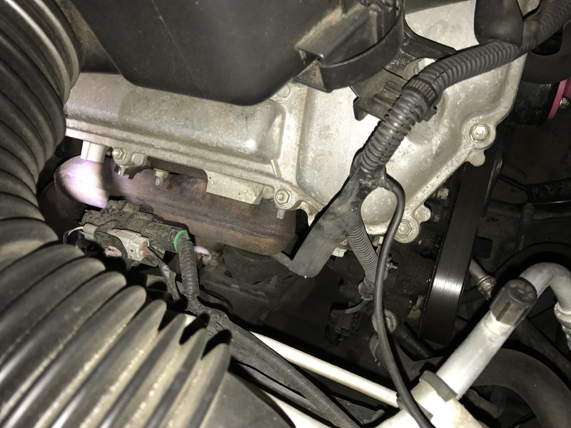

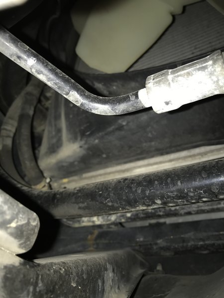

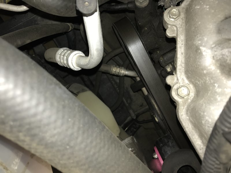

  16. Jan 9, 2017 at 5:25 PM
    #16
    ZachPrerunner
    Jul 7, 2015
    #158942
    2,963
    Southeast TN

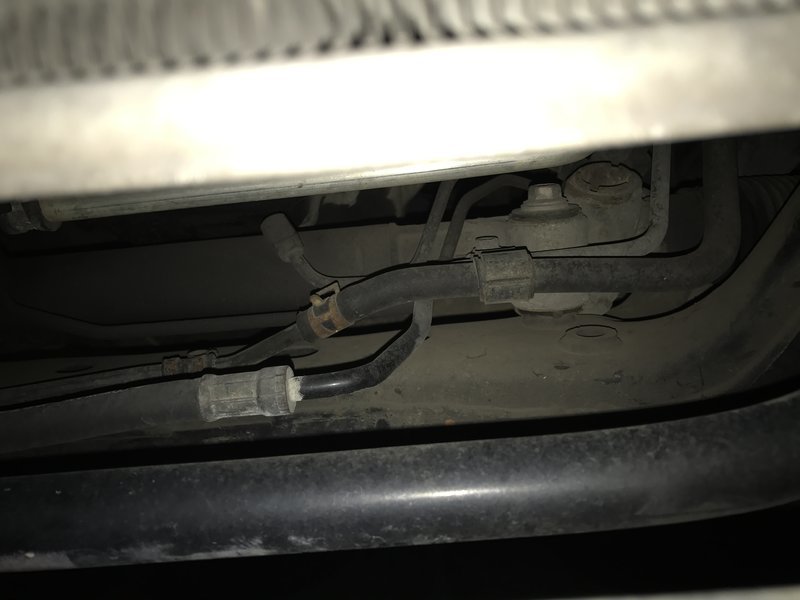

    Some more

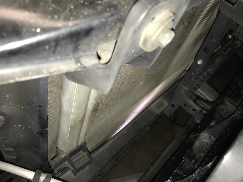

    I don't see shit,

    You mean like you can't see anything because of the pics or you don't see anything wrong? :oops:

    nothing wrong, you can put old newspaper under the radiator area overnight if theres antifreeze stains, but I doubt it. just watch the resovoir see if it continues to go down
