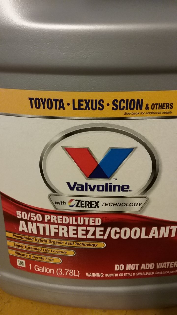

    And for anyone looking for a good alternative to the expensive OE SLLC....check out Valvoline Zerex pink. It's nearly identical to SLLC and is completely compatible with it.
    It's a silicate free P-HOAT formula which is what is recommended for our cooling systems
    Available on the shelf at your local Wal-Mart and half the cost of SLLC at $13 gallon. Premixed and ready to use.
    Been using it for years in all of our family's Toyotas.
