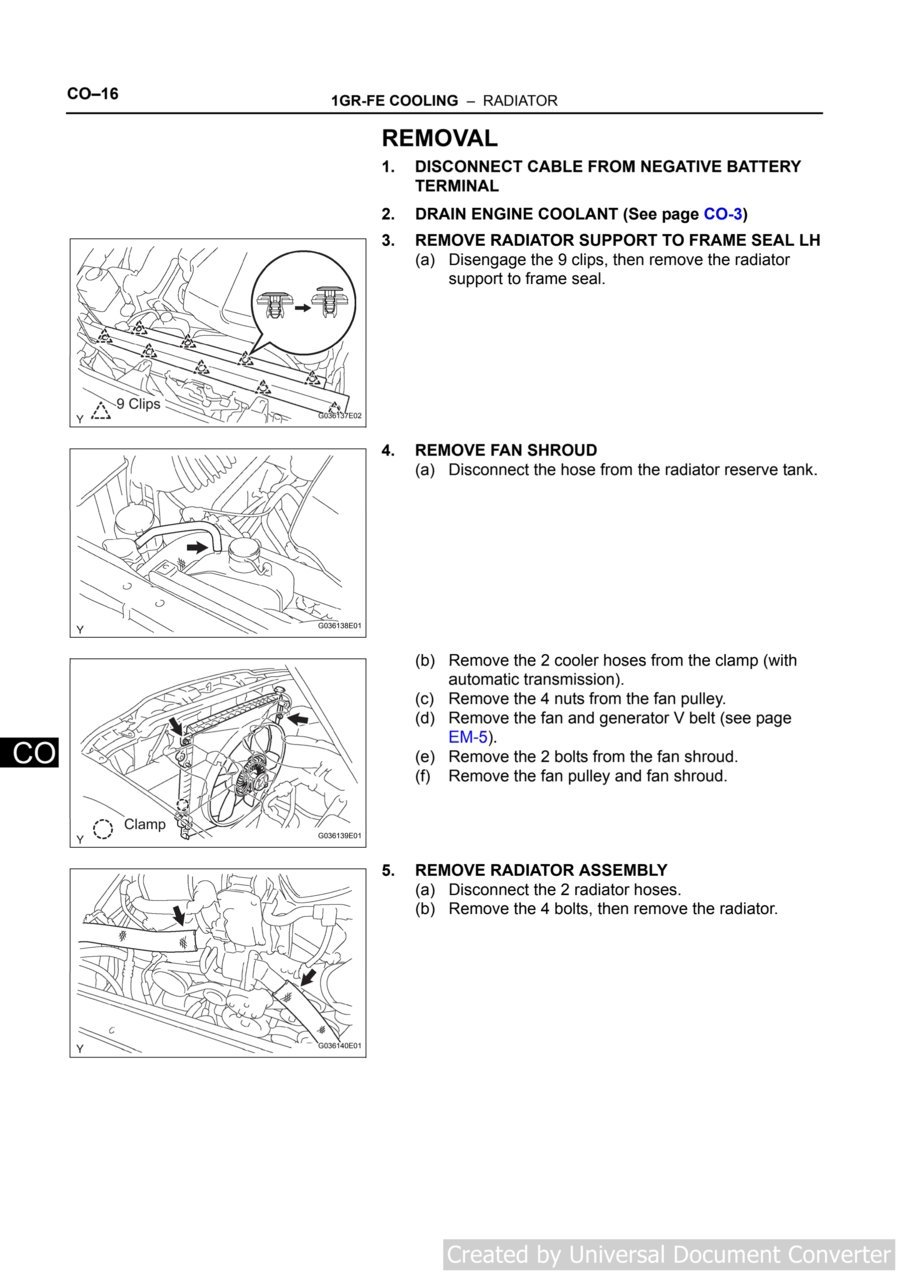

    It looks as if a radiator replacement is coming soon on my 2014. Ive tried google and youtube with little to no results on the 2nd gens.
    Anyone got tips, pics, how-to video or threads? Wondering what all I will have to remove. Primarily the TRD O/R skid plate and the cooling fan.
    Thanks in advance yall

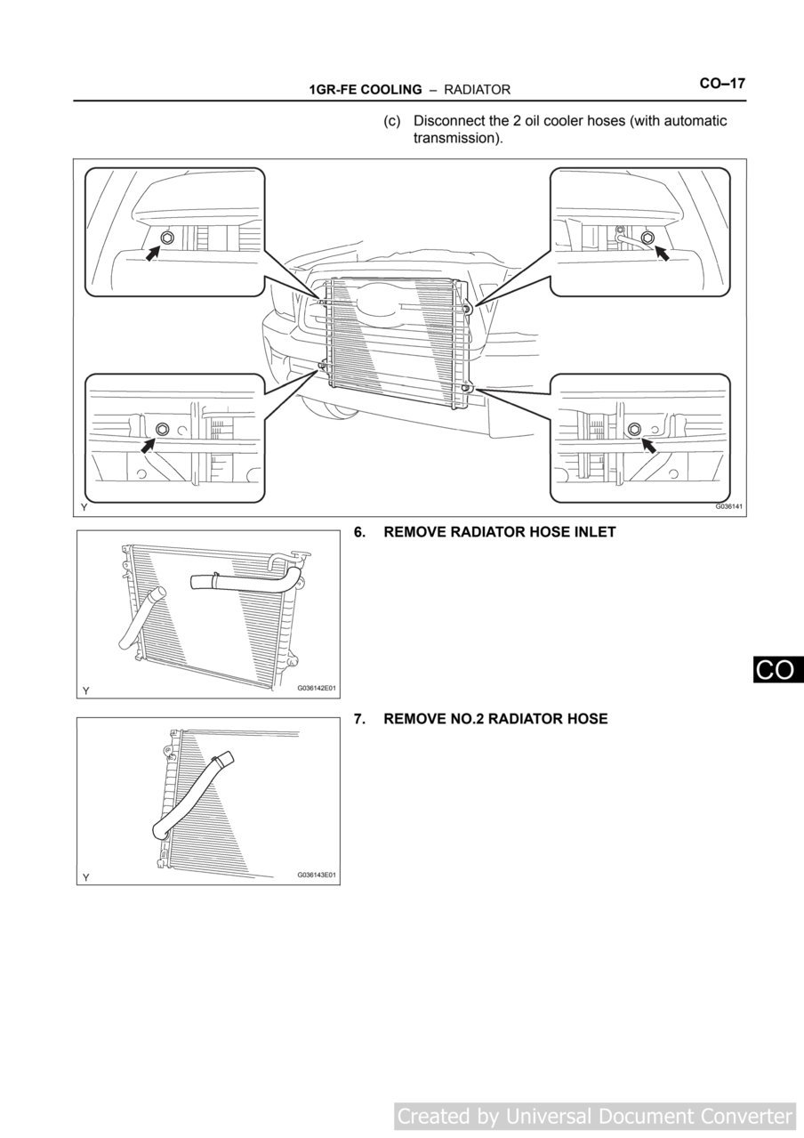

    Just the fan, fan shroud, radiator hoses, and transmission cooler lines. You shouldn't have to mess with the skid plate or the belt although the belt is much easier to change with the fan removed if it needs changing.

    Thanks! That is very helpful.
    Ill probably do the belt while I am there and maybe even thermostat.
