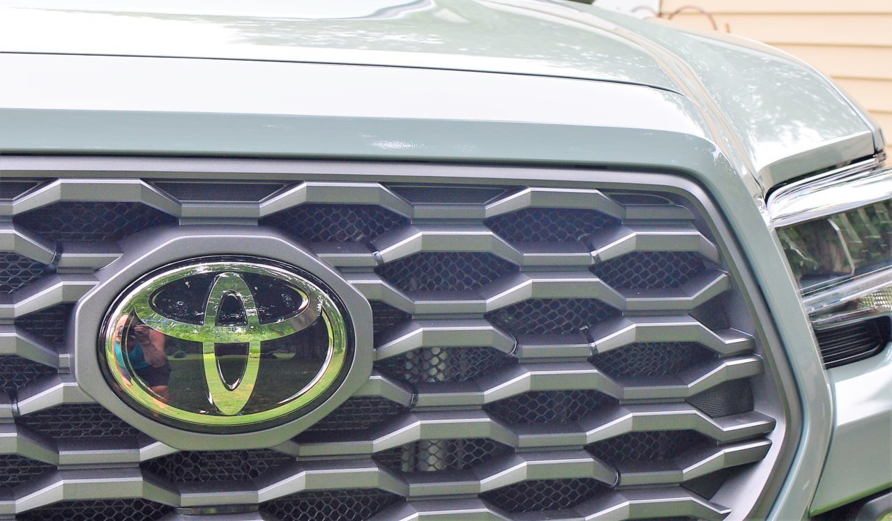

    Sorry this happened to your radiator. AC condenser survived?
    Almost all new vehicles leave too large of openings for road debris.
    All 7 of my vehicles purchased in the past 20 years have received this
    simple mod. Vinyl gutter guard with zip ties.
    The mesh is at least 1/4" and never caused an airflow problem and it will
    catch or slow down almost anything that comes it's way.
    The zips are barely noticeable.DSC_4318.jpg I try to keep vehicles for about 18-20 years. Still have 4 counting wife's and son's.
