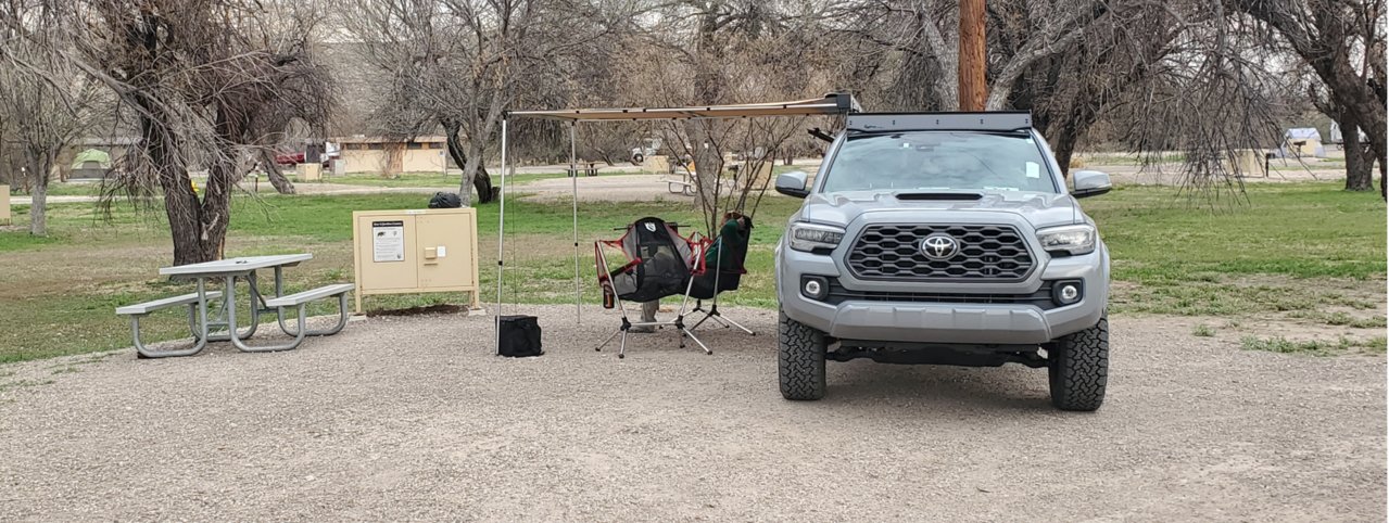

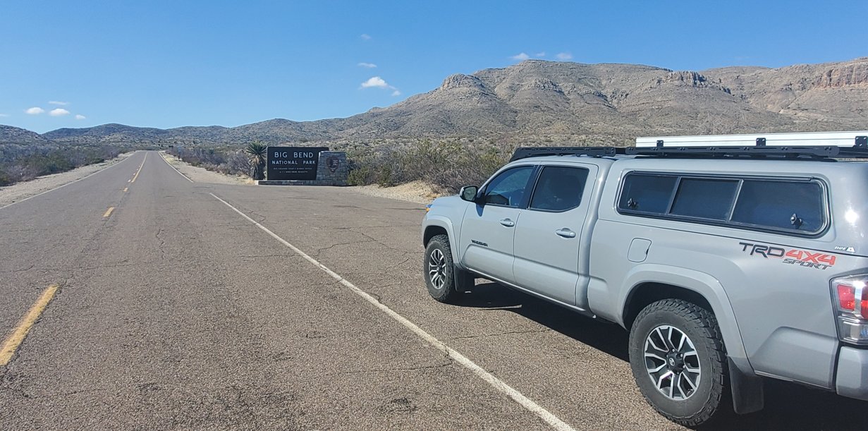

    I have the 8' ARB awning with the aluminum hard case that I mount onto my Prinsu rack for longer trips. I have the Prinsu cab rack and the top rack on the topper. I used one mount on the cab just in front of the passenger door and the other two on the topper. I bolted the brackets directly to the rack with no bushings or spacers. Went to Big Bend NP in Texas last spring with this setup (I'm from Indiana) and did some light off-roading knowing that there may be some flex. Never had any issues. Only two pics I have.
