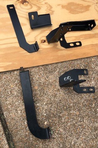

    Okay, I’m finally back with the follow-up and resolution. I’m first going to respond in general to the comments. Thanks for taking the time to leave feedback. I appreacheat it. For those with just negative comments, well I’m not going to spend much time on those. I’ll just say I live in deer country. After seeing a lot of frontend damage to vehicles from deer and having hit one with a prior vehicle I’m sold on the idea of a solid grill/brush guard to prevent other damage. This is a full brush guard, not a bull bar. “Right”, I should have questioned the directions more (a friend helped me install it according to the directions), but I found no issues with the research I did and made the mistake of trusting Toyota’s and Westin’s quality of product. Live and learn. Westin ultimately stepped up to resolve the problem, but I still I’m not happy with the weakness of the body steel Toyota uses. Particularly, for inner supports like this one, on a truck. I’ve had other concern arise with the body medal used, but I get they have to cut weight to meet MPG guidelines. Anyway, so this started in about October of 2019. The long and short of it, Toyota was not going to do anything about it. I contacted Westin to see what they had to say. I really wanted to find out about their research concerning the mounting to the upper crossbar. I sent them all the pictures and a repair estimate at their request. The estimate the dealership had obtain was about $500, the estimate I had obtained from a locate shop was about $300. I called and spoke to customer service about every other week. I really thought they were just blowing me off, which made me mad and left me no reason to not just keep at them. In February 2020 they sent me the new design for the mount they had created. Apparently, there had been a couple of other people with the same issue. The new mount attached to the frame and then to the bottom of the grill, like the old one. Another section of the mount ran up behind the grill and created a place, a bit more than half way up the grill, for another support to bold into, replacing the cross support connection that had caused damage previously. This is a very solid design, much better than the old one. I then keep calling Westin because they said they would send me a check for the body shop repair. Much to my surprise, in June 2020, I received a check that was a full refund for the grill. So thanks to Ray Napoles with Westin Customer Service for eventually getting me taken care of. I wish more people with Toyota were like Ray. I’m still disappoint in the overall quality of what I expected from Toyota and the quality of service from the dealership, but that is another topic. The attached picture shows the new and old mounts. The new is on the plywood. The “J” like brackets are basically the same. They run from the grill to the upper support. You can see on the new mounts that part of the “Y” is longer, that is the piece that runs up to connect to the upper support. The small “L” bracket bolts into the frame next to the mount to offer cantilever support for the mount, since it is now holding all the grill guard’s weight. I’m sure there are other guards out there that function better, but this was the right price for what I want it to do.

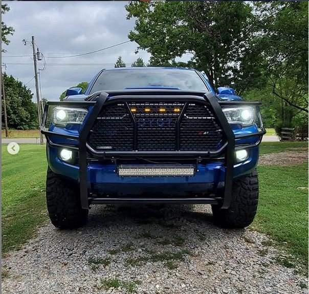

    Man, you got me scared a little bit. I bought a grill guard very similar to your's from Blackhorseoffroad.com It's their "rugged heavy duty" version:
    I bought the truck used, but it came with a Westin bull bar. I'm personally not a fan of bull bars. And like you, live in deer country in rural Mississippi. I've had a couple close encounters. So a grill guard made sense to me.
    For now, mine hasn't been rattling as you described. But I'm certainly going to be listening a lot more. The roads around are fairly decent. But mine does bolt as you described on the cross beam in front of the radiator. I've had to tighten the bolts up once after installing only because the instructions say to after a few hundred miles (which I have put almost 1200 on since putting this thing on).
    I guess either time will tell or the Good Lord will keep me safe. :fingerscrossed::fingerscrossed:

    The fault with the bar lies with Westin 100%.
    Toyota is NOT at fault here, the crap-tastic "engineers" at Westin are.
    The Westin bar was/is attached to the frame AND the rad support with a "solid" mounting system, no flex....
    I wonder if anybody at Westin is aware that the radiator support is mounted to the body.
    The body is RUBBER mounted to the frame and moves (the reason that NOTHING is tied to the frame from the cab/body with a solid mount from the factory) around A LOT on those mounts. On the original mounting system the movement between the body and the frame flexed the rad mounts (something had to give when the two were tied together) to the point of failure. Kind of like flexing a beer can till it cracks.
    The new mounting system is kind of like Harley engineering. If it fails, make it 3 times as big and sell it.
    It WILL fail again.

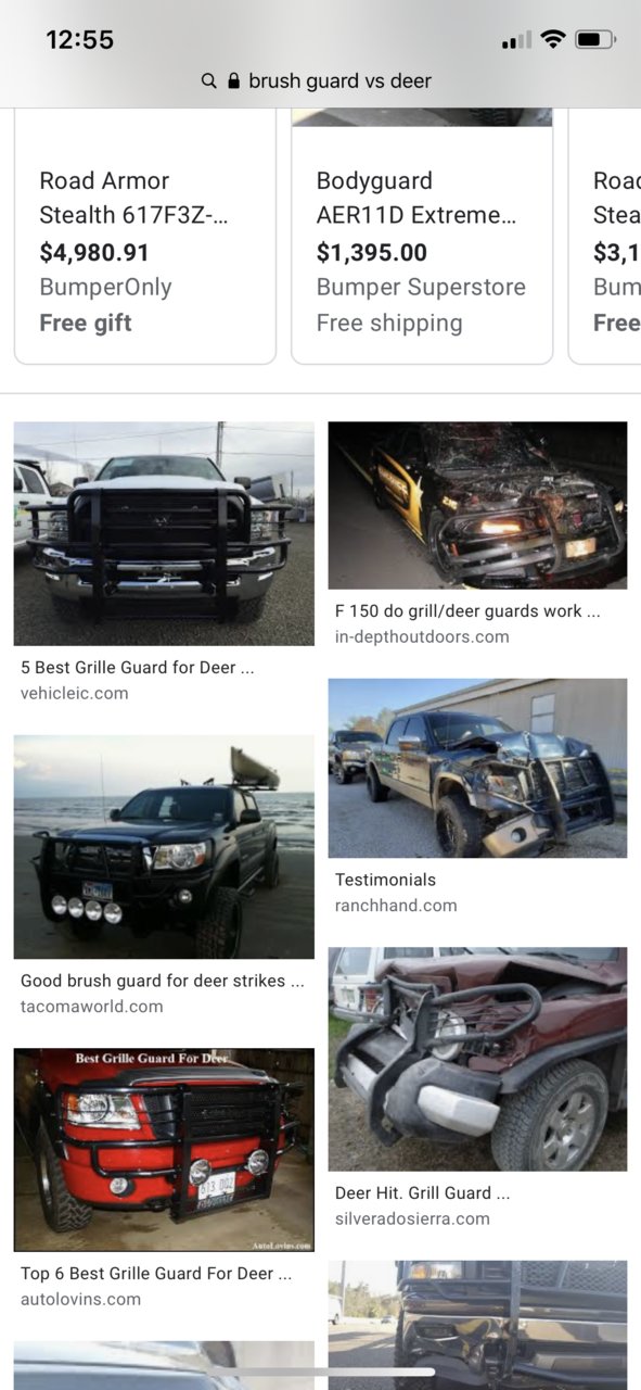

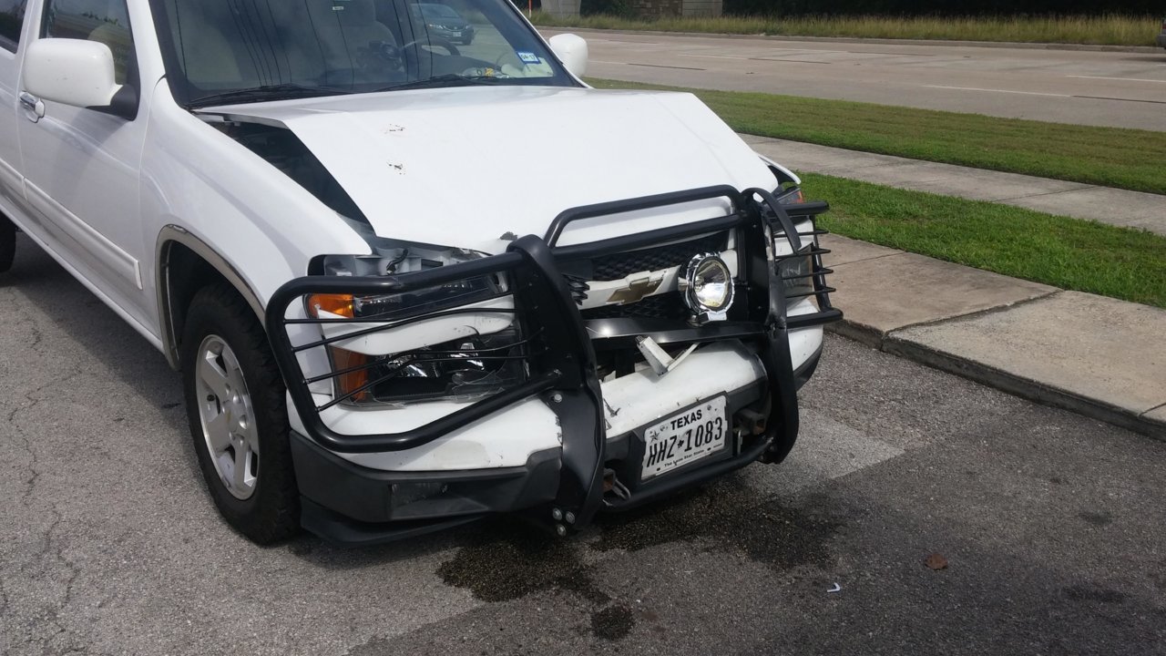

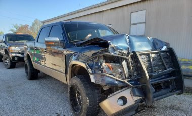

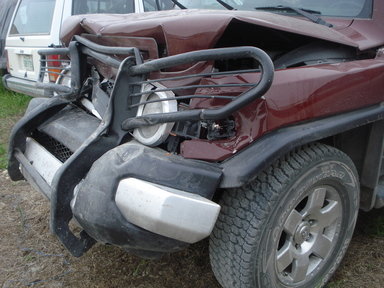

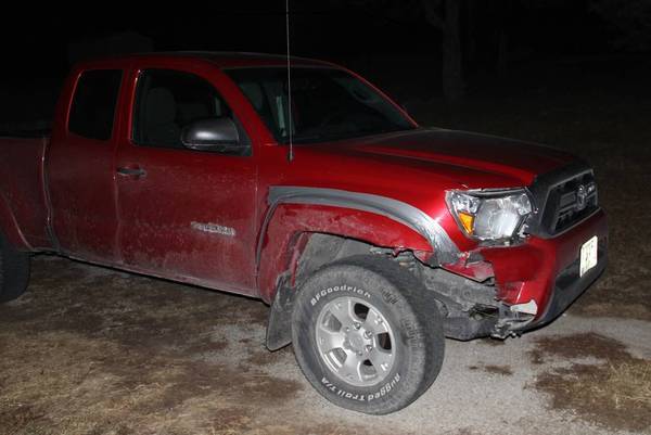

    these are all impacts from a deer. They will not save your front end, most times they create more damage as what their mounted to gets torn and bent in the impact. It’s a “brush guard” it’s meant to deflect light bushes and tree branches. And if you use it to push anything other than a garbage can it’s going to collapse in.

    Deer can do plenty of damage but why lie?
    Blazer hit a Tacoma of all things :rofl:
