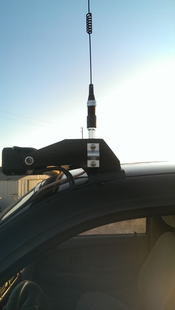

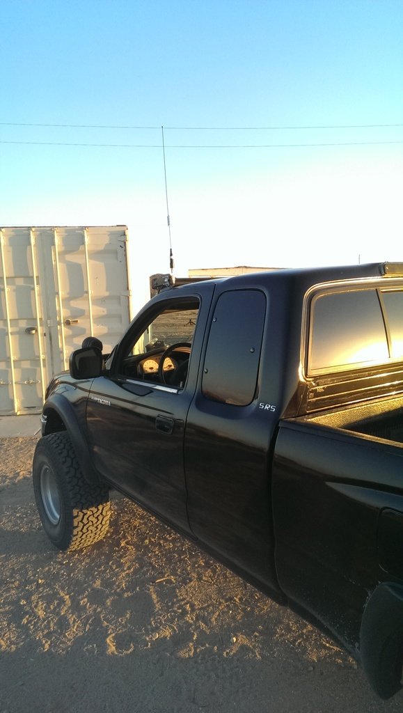

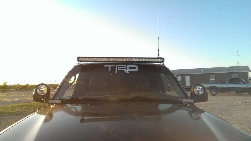

    Welp, finished the cb install. Used the cb/am fm splitter. Not 100% sure on how the cb is doing. Still learning and haven't really tested the transmit. Came back with an 'Rf Power Output fail' but a pass on antenna check.. not sure what that means.. But the splitter does in fact work. I'm receiving on cb pretty good I think. But the radio is receiving with a slightly decreased signal strength.

    It's high enough to do some good. I don't know if that antennae will do well with it. Have you checked SWR?

    Well I've got the cobra 29 lx and its got the built in one. Don't have an swr meter handy. Suppose I could get one. But according to the cb it's tuned in and about 1.2/1.3. Says it should be far left on the gauge. Shows 3 little bars from the left. According to a couple vids I watched that's about right. May be 1.1 Idk. But I also read others say the built in swr isn't very reliable, to use a meter instead... I'll order one up I guess..
    Any input on the rf power output failure?
    Another thing I wondered about, is if I should try grounding it better. But the light bar bracket is bolted all the way through the cab so I'd imagine it's a good ground.. Or maybe the antenna mount itself being aluminum? Not sure if that matters or not. Another thing I read is that bunching up the coax or coiling it up and tucking it in can cause issues.. I just don't know.. ha. I'm debating on whether or not to take it to a cb shop but I have no clue where one would be right now.

    Coax is usually sold in certain lengths. These common lengths will fool your radio into thinking it's got a good antennae system. This is a long running debate amongst CBers that know and don't know. Whatever it may be, just use the least amount needed and you should be fine. A flat 1.0 SWR is a sign that you have issues. I have a about 2' of coax rolled up and tucked under my dash with some ferrite clamps on it.

    Yeah I've got a bit rolled up and tucked under the dash. But I also have that splitter that has 2 inputs. One for the stereo antenna and another for the cb antenna, then the connection to the cb as well. Wondering if this is causing an issue. Or a combo of things. Again I have no clue. And haven't really tested it. Such a noob with this right now. For all I know it may be working just fine. All I know is what it said on the radio check regarding rf power output failure.

    If you don't want the radio antenna down by the rain tray, then I would suggest having a separate antenna on each side of your light bar. Go with a Wilson Trucker for the CB and whatever your stereo. You'll notice an improvement that'll be unbelievable compared to what you have now.

    I suggest really any Wilson base loaded antenna because they're decent quality and readily available. Any interstate truck stop would have a selection of them. Their 5000 series of whichever you choose will have better internals than a 1000 series. Stay away from the Little Wil'.
    There are always other brands available. I definitely wouldn't put a firestik on top. A 108" whip would be ridiculously tall, but would work the best. So the compromise is a base load.
