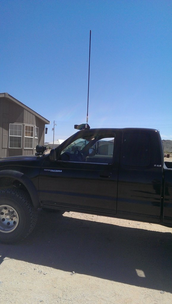

    Acquired this old firestick. Put 'er up top just to test. Checked swr and no change on that. Receive seemed to be just a tad better. Hard to tell.. still can't get any response on a radio check. Tried yesterday in town with the 3'er I had on there and no luck. Think I'll be searching for a cb shop. Might go pick up a swr meter today if my local radio shack has one in stock. Will report back.
