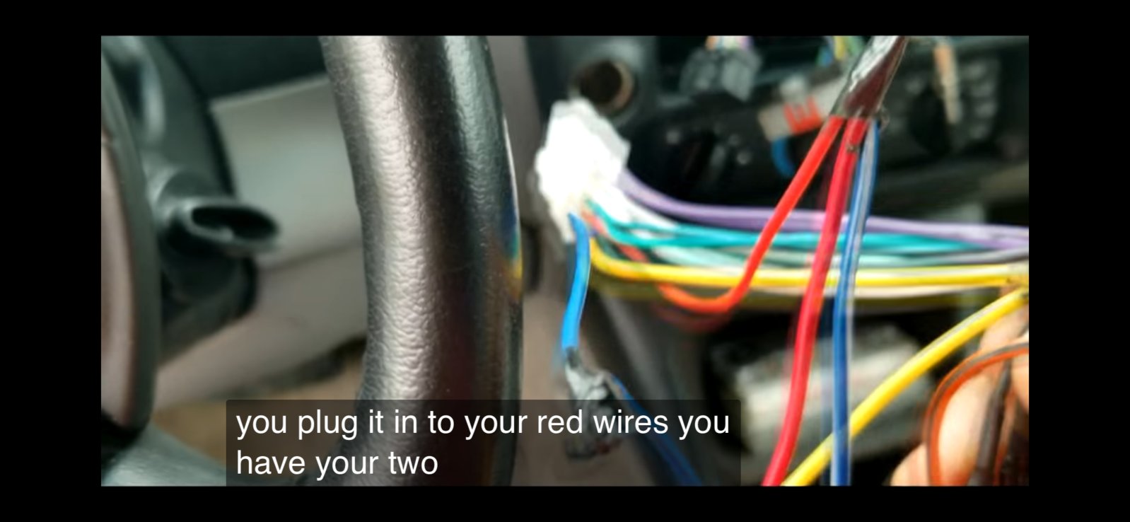

    I looked online and found a video that I will link below where I attached the blue wire with a white strip to the red wires. The radio now works great when driving without any issues but now will turn on after 2-3 min after I turn the truck off and take the key out. I have even pressed and held the power button on the radio till it powered off and then turned off the truck. 2-3 mins later it’s back on without me doing or pressing anything. This has caused it to drained my battery and now needed to be jumped twice. I think it’s an issue with the radio and not the truck but worth a shot for anyone willing to help

    YouTube video on install
    https://youtu.be/nzW8wQQN2iw?si=fTcW_BchOFsDhUx0

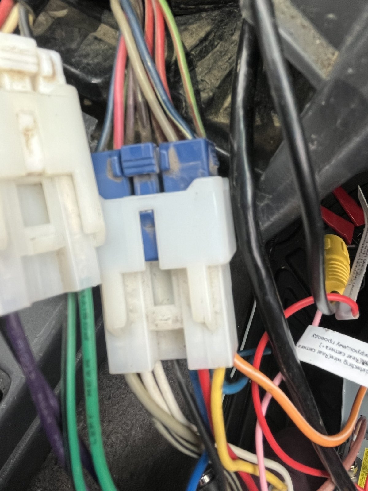

    Attached is what mine looks like. In the video he said not to plug it into the yellow wire because that is constant power and will drain the battery

    That video is specific to the truck shown in the video, the headunit he is using, and the wiring adapters he is using. You can't just assume that his red wire is the same as your red wire and make the connection as shown. You need to understand what each wire is actually for in order to figure out where you went wrong.

    The truck I have, had a single din aftermarket radio already installed with an updated plug adapter. Everything was plugged in right but I think I figured it out. I cut the constant power (yellow) which seams to have fixed the issue but time will tell. The radio works perfectly like I want where the radio powers on only when the truck is on. Thanks again for the help

    I don’t have a remote start but wish I did. At first I thought I wired it wrong but after looking up 1996 Tacoma wiring diagram everything was wired correctly. I have an updated plug adapter that switches the stock wiring to updated colors such as stock grey power to red power and stock blue/yellow to yellow constant power. Following the 1996 Tacoma wiring guide and tracing the lines everything was wired correctly.
    I honestly just think it’s an issue with the aftermarket radio. I google the brand and symptoms and sounds like other people also have been having the issue. No issues for me post cutting the yellow wire so far but will update if something happens. Thanks again
