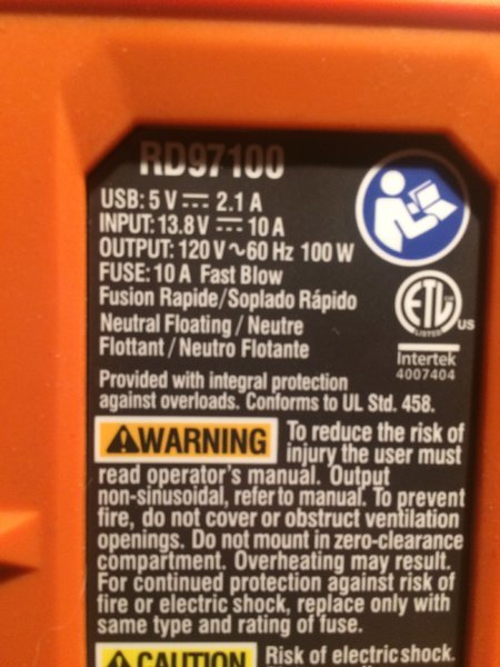

    hey so my boss plugged an adapter into my 2004 tacoma to run a water pump. Now my radio, clock, power outlets and cigarette lighter do not work. I changed out a few fuses in the fuse box in the drivers side as well as some fuses in the engine bay, I also got a circuit checker and it seems like all the fuses are working. I have no idea what I'm doing, this sucks! Help
    Here's the adapter he used
