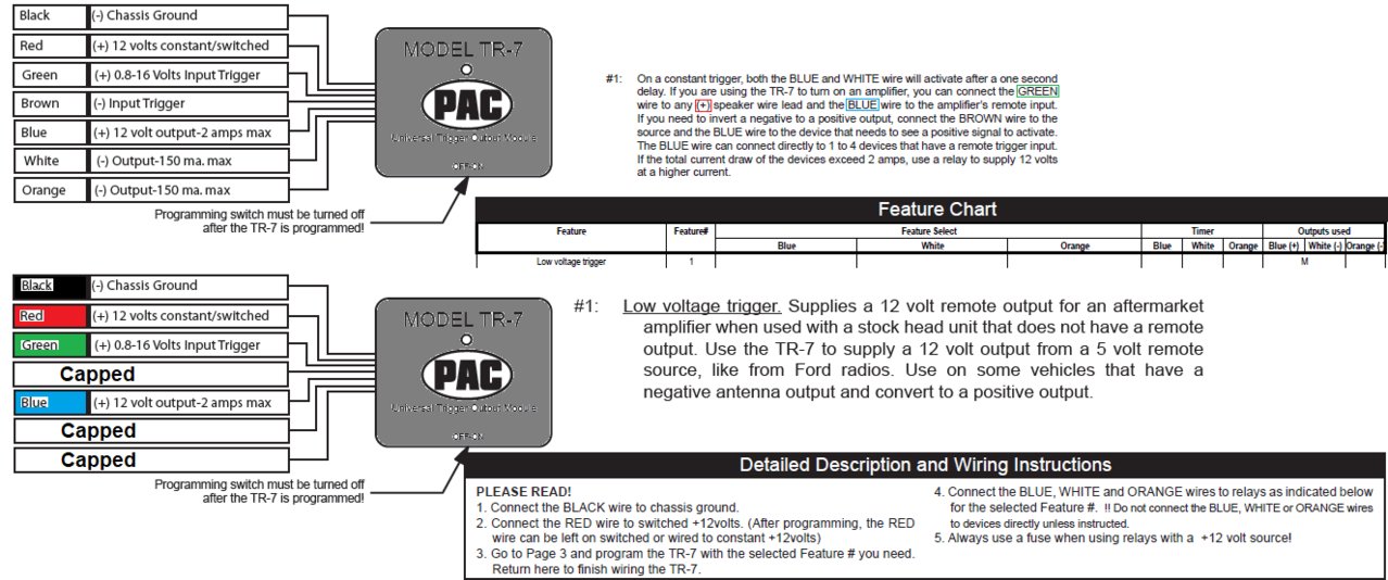

    Already thought about that. But I’m lazy. Lol. That PAC TR-7 seems like it should work for what I’m wanting. Unless you have had bad experience with them or something?

    Nope...they are inexpensive also...

    Yeah. For $15 I’m just gonna go that route.
    Thanks for all of your input on this!

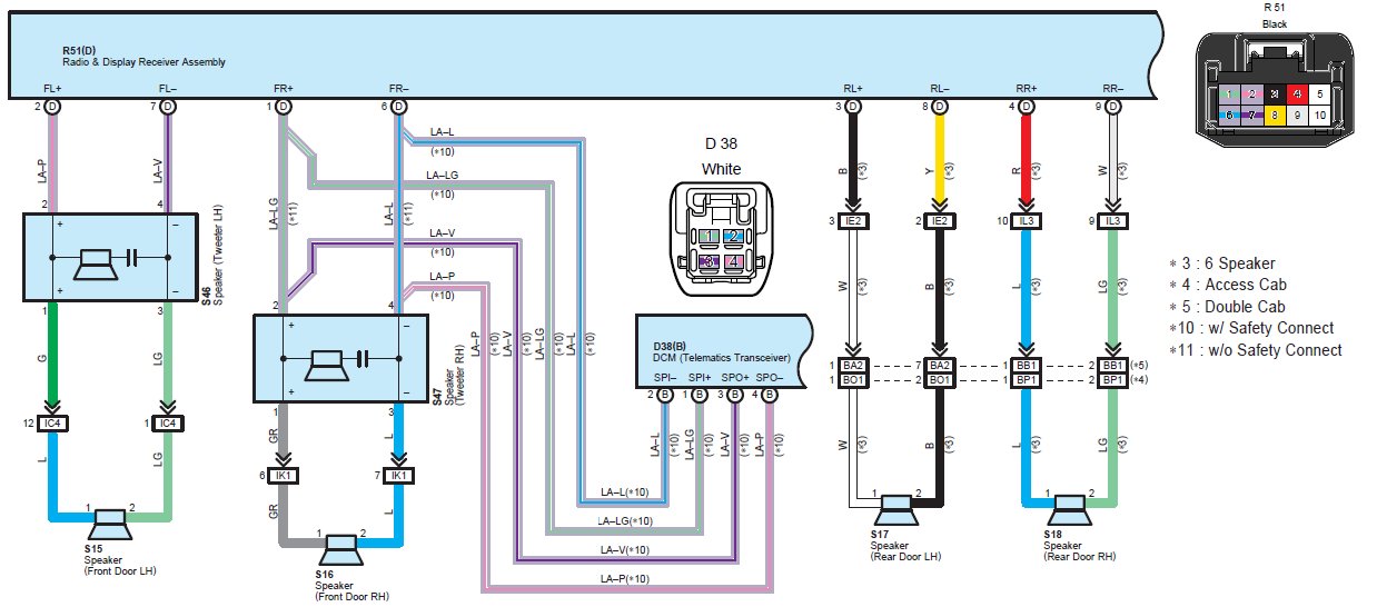

    OP, you might have the D38 connector even if you do not have the DCM module. If it's there, it'll be held in place by tape to the harness on the passenger side near the engine ECU.

    Thanks! I’ll get back there and check it out again!
