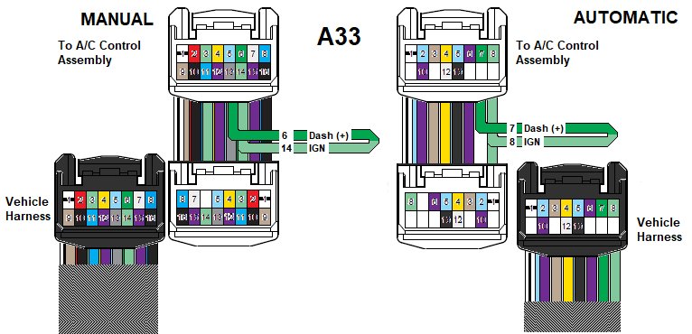

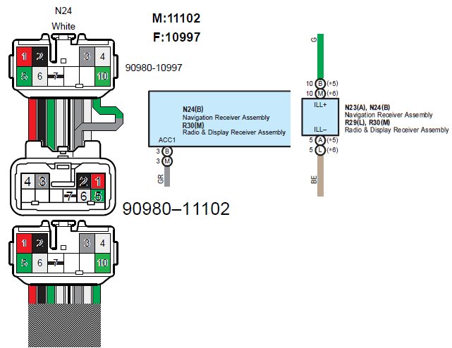

    If you’re prepared to do some wiring, you simply need to fake the headlight trigger wire signal in the back of the headunit so it thinks the headlights are on all the time.
    But I also “thought” they were dimmable with the dashboard dimmer switch, but that’s going to effect all the dash lights.

    You would have to "fool" the circuit, that would require removing the input on each system connector and placing a fused feed tied to IGN. That way the system (Radio & A/C) will be getting the input to behave as if TAILs are always ON (dim).
