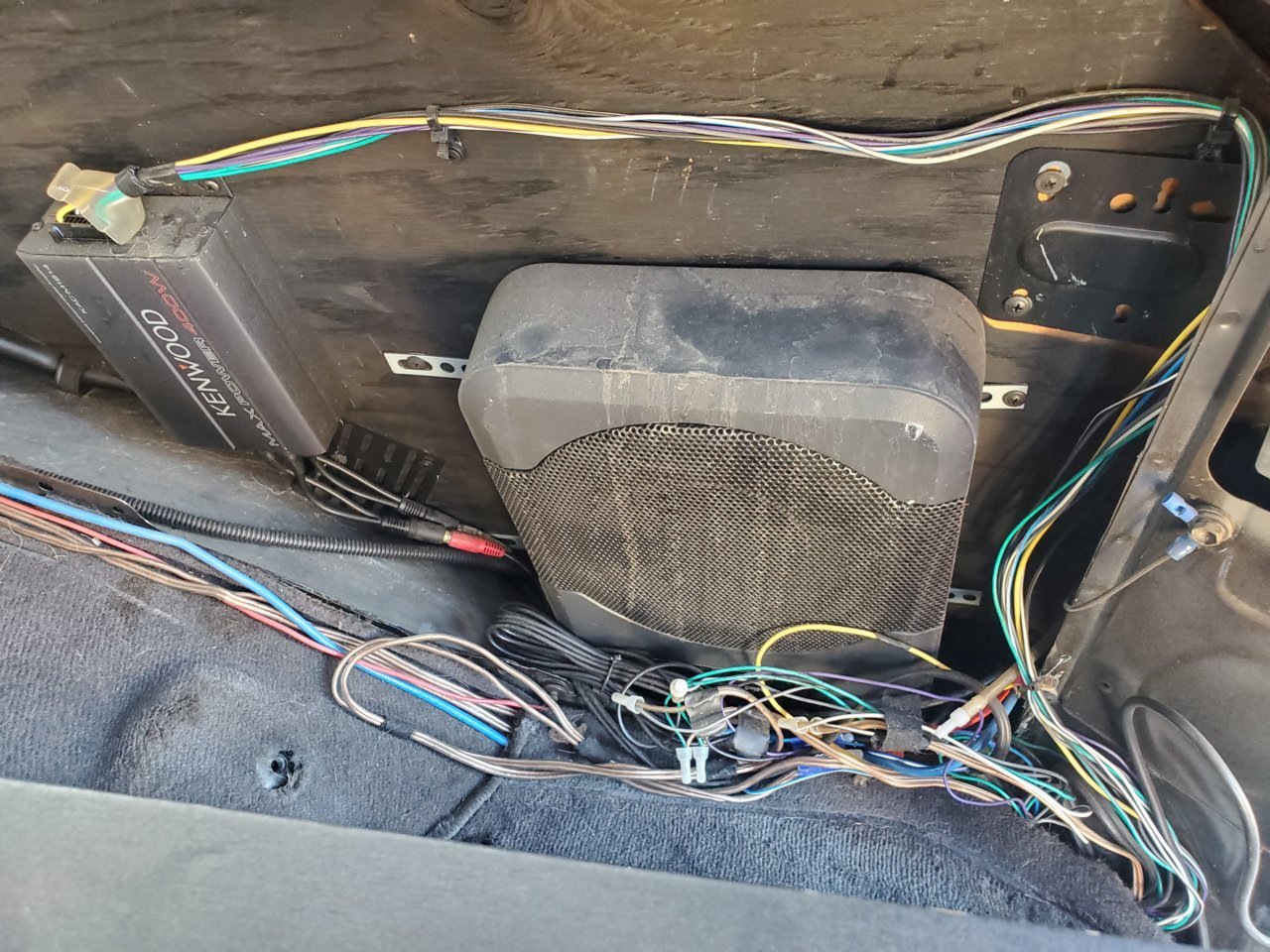

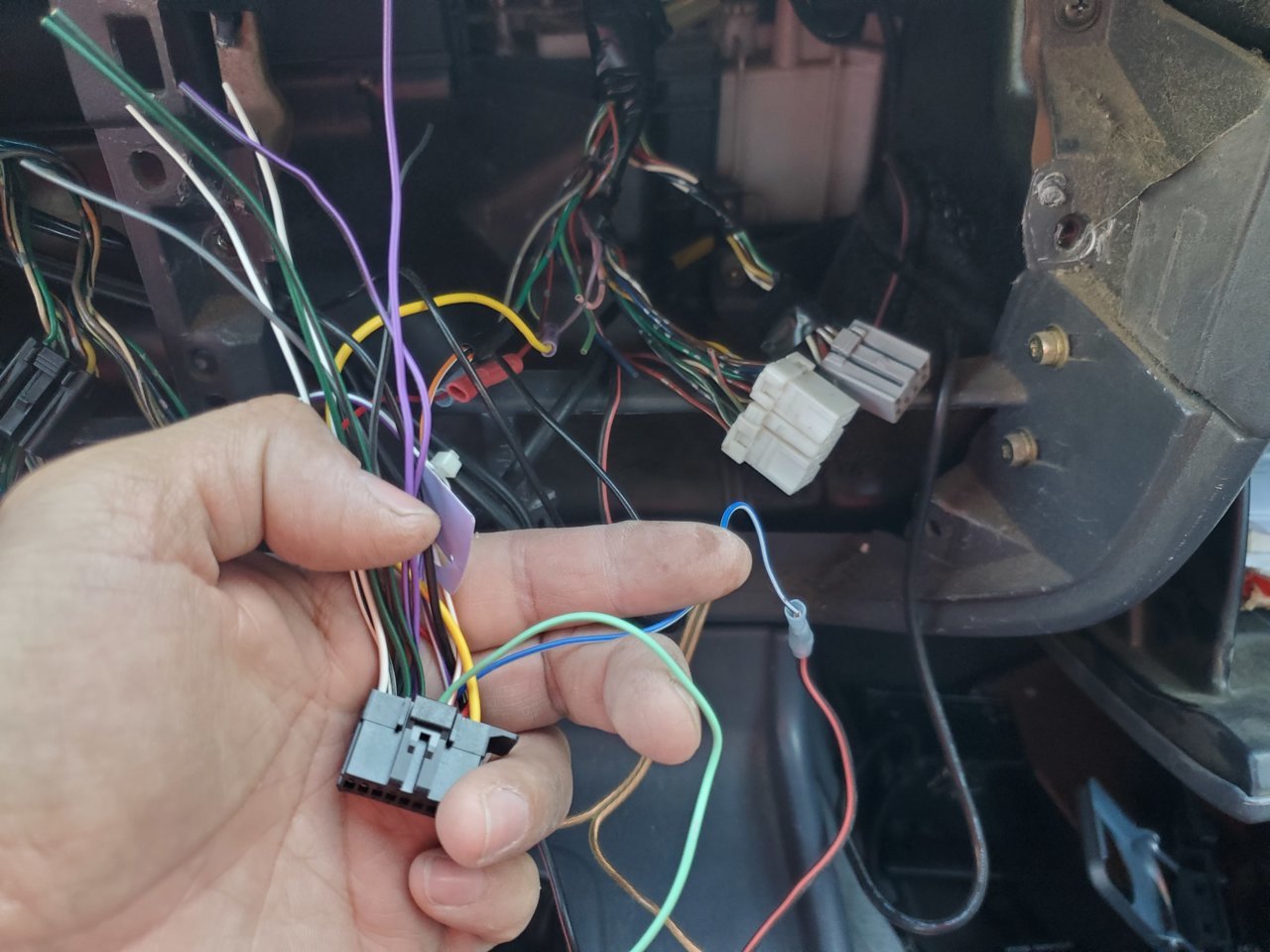

    Here's mine when I was diagnosing why I only got sound from my driver rear and passenger front, remaining speakers didn't work -
    Disgusting hack job. They didn't even care to buy an adapter to connect to the factory wire harness and instead spliced into it :facepalm:

  18. Feb 3, 2022 at 6:16 AM

    I really hate to see that and make things worse by using butt connectors
    When getting the correct adapter is really easy.

    Eww. That’s in the 80?
    I’d be tempted to cut back the factory wires, slap a new connector on, and then build out a harness to adapt it to the radio.
