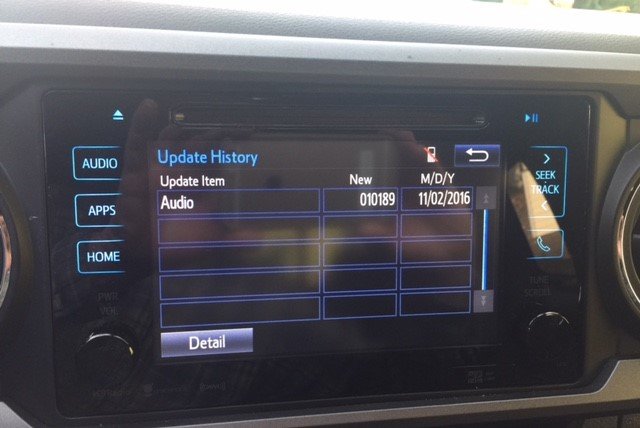

    Went to the dealer for the complementary 6-month check and the software update was performed. RE: T-SB-0106-16.
    Now have new 010189 premium updated software. Maybe no more reboots...

    My dealer had to download the file inorder to complete the T-SB. Nonetheless, I was out of the service center in an hour an a half including the 6mo free service. Just mention that you want the software update to fix your booting problem.

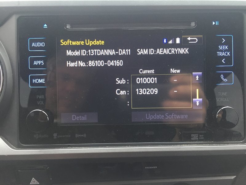

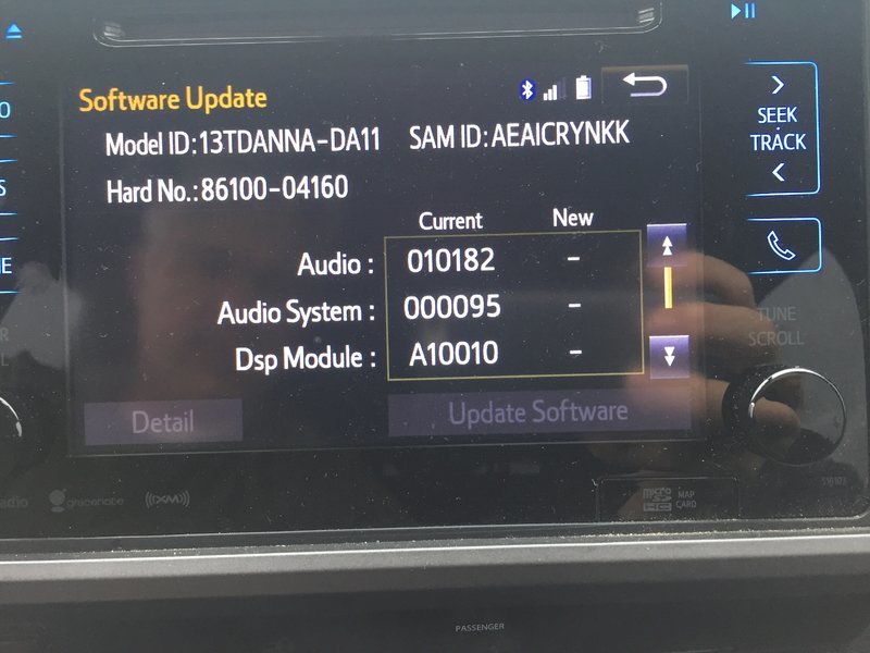

    Raining today. Rebooting constantly. Turned on HD Data Setting 'Enable Data Download via HD Only' and rebooting stopped. I've had it in 4 times for this issue and updated software. Man this is frustrating. image.jpgimage.jpg

    Mine would constantly reboot in the rain until I changed the HD setting as well. Hasn't rebooted for a few weeks now through plenty of rain. I haven't had any update done.

    I update them to correct the issue.. better than dealing with it or disabling features.
