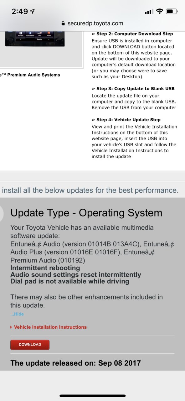

    FE1D5E67-312E-43AA-B845-3BC3E0488152.jpg Anyone do November 2017 release OS update, it’s supposed to fix this

    Possible to provide a link? I cannot find this
    *edit* if this was the OS update that killed off Pandora (grumble grumble), then yes I did that one.

    Okay, followed those directions, put it on a USB, plugged it in, started up the truck, went to the update page, and no option to update, so my truck must have the latest...

    No, it’s not detecting it because you haven’t formatted your usb to fat32, just like with music, Toyota requires fat32 format.
    HU should still detect the update, wether or not you have the latest software

    No, pretty much all USB flash drives are FAT32 format, and yes, I just checked, this one is formatted in FAT32 as well.

    I stand corrected, but the drives I buy are always ntfs format. Anyway, sucks that isn’t the fix
