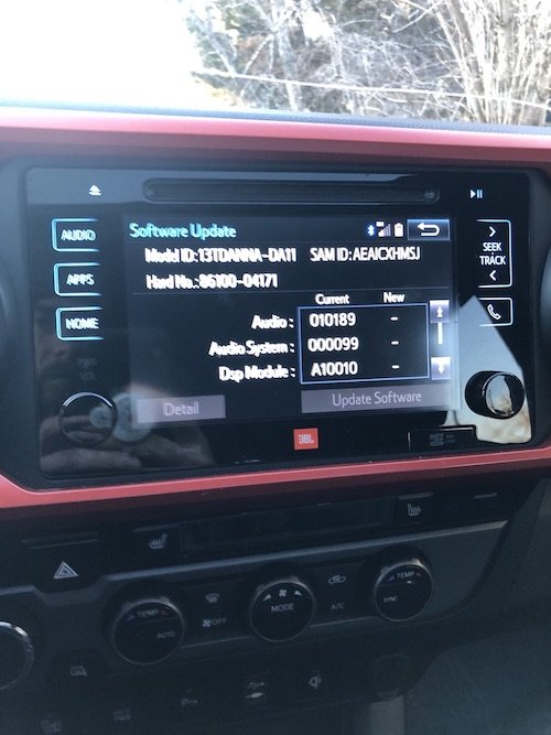

    Just got it back from the dealer, they "updated the software." They told me that the "fix" is unpairing everything and pairing it back. The radio rebooted twice before I left the parking lot.
    I was curious to see if there was even a new software version, and sure as shit, same audio software 10189. Checked updated history, nothing....
    Turned around and went back in. They said they'll try and order me a new headunit. After talking to a decent guy in there about it, I got some more information. Turns out this is effecting a lot of newer Tacomas and 4Runners (including brand new, with Carplay). And the new Siennas are coming back within 1000 miles with the same issues. This seems to be isolated to iPhones currently, as most new updates cause this to happen. But for some reason, not all have this problem.
    Toyota's being really shitty about this IMO. They are aware this is a problem, yet they are dealing with it by throwing in shitty updates that rarely work, and if they do, it's only temporary as each new update will likely cause it to happen again. Instead of at least offering this update to their customers, it'll cost you to fix it if you're out of warranty.

    ??? I think there is an update to the 010189 software for that head unit. one of the threads here has a link to the download - ??? Look for the thread "what is the most recent entune software" the second page has the link for the download.

    Four posts up... That's the software I'm running.

    ??? saw that - 010189 is the one there is an update to (newer version is available per the link).

    I just update mine from 010189 to 010192. No issue with the update - took about 10 minutes to do. Not sure what the "improvements" are but everything works. 010189 was update preformed by the dealer in March of 2017. 010192 was released in September 2019.
