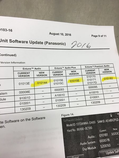

    Check the radio OS version, compare to attached photo.
    If the OS isn't listed in yellow.. get it updated for free.

    What's that from? Do you have a TSB link?

    I'm a tech. It's just a picture of the actual TSB printed out. I keep the USB stick in my toolbox for every 16 Tacoma and Highlander I work on.
    Rebooting is the primary fix for this update.

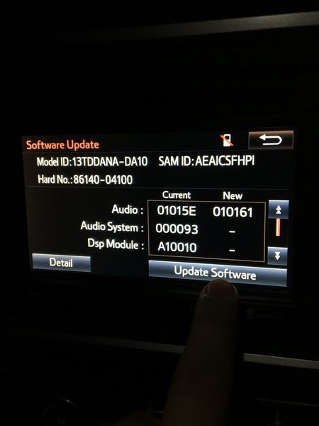

    LOL, awful.
    They revised it. Now there's even newer versions.
    Likely just for the 2017 year vehicles.
    Time to update my USB drive.

    Hopefully they updated with the file off TIS, not the USB drive Toyota sends to the dealers..since that's out of date now.
    What I listed last night is the latest. But that being said, I have replaced HUNDREDS of Toyota radios in my career. It's truly amazing really. I may even be into to quadruple digits.
