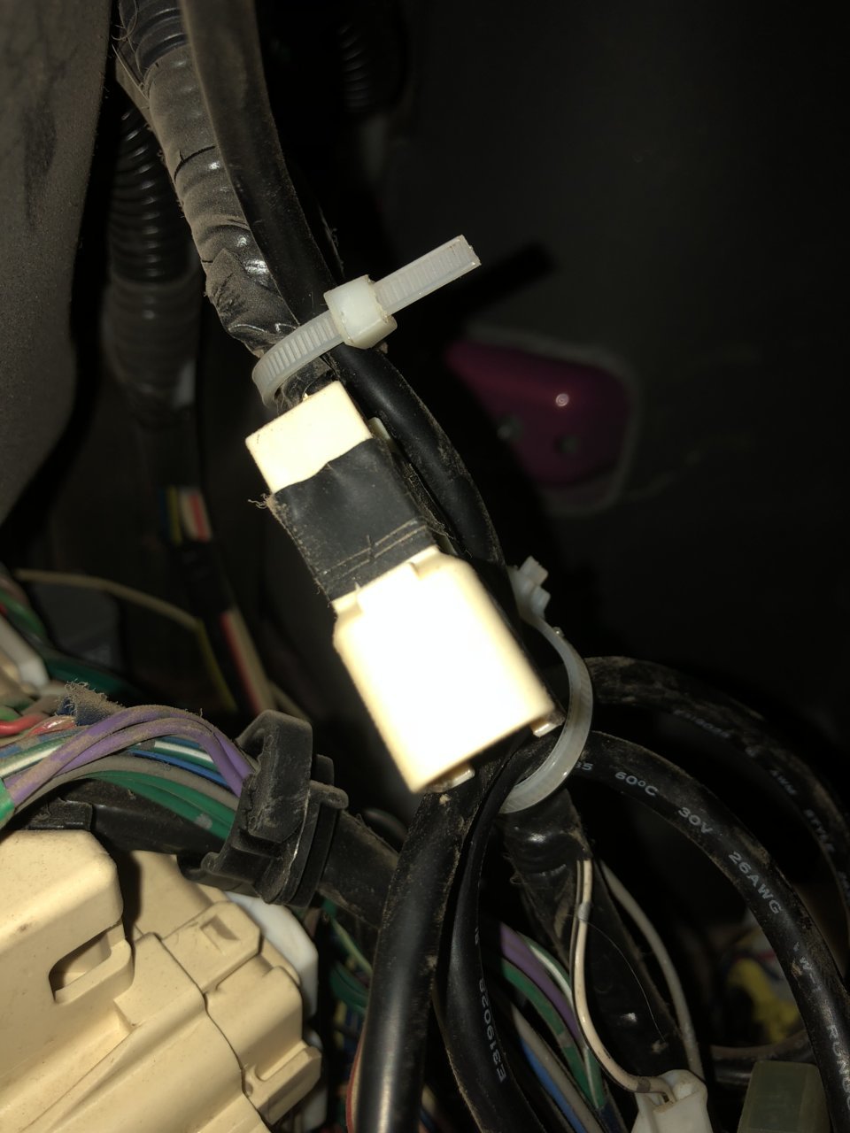

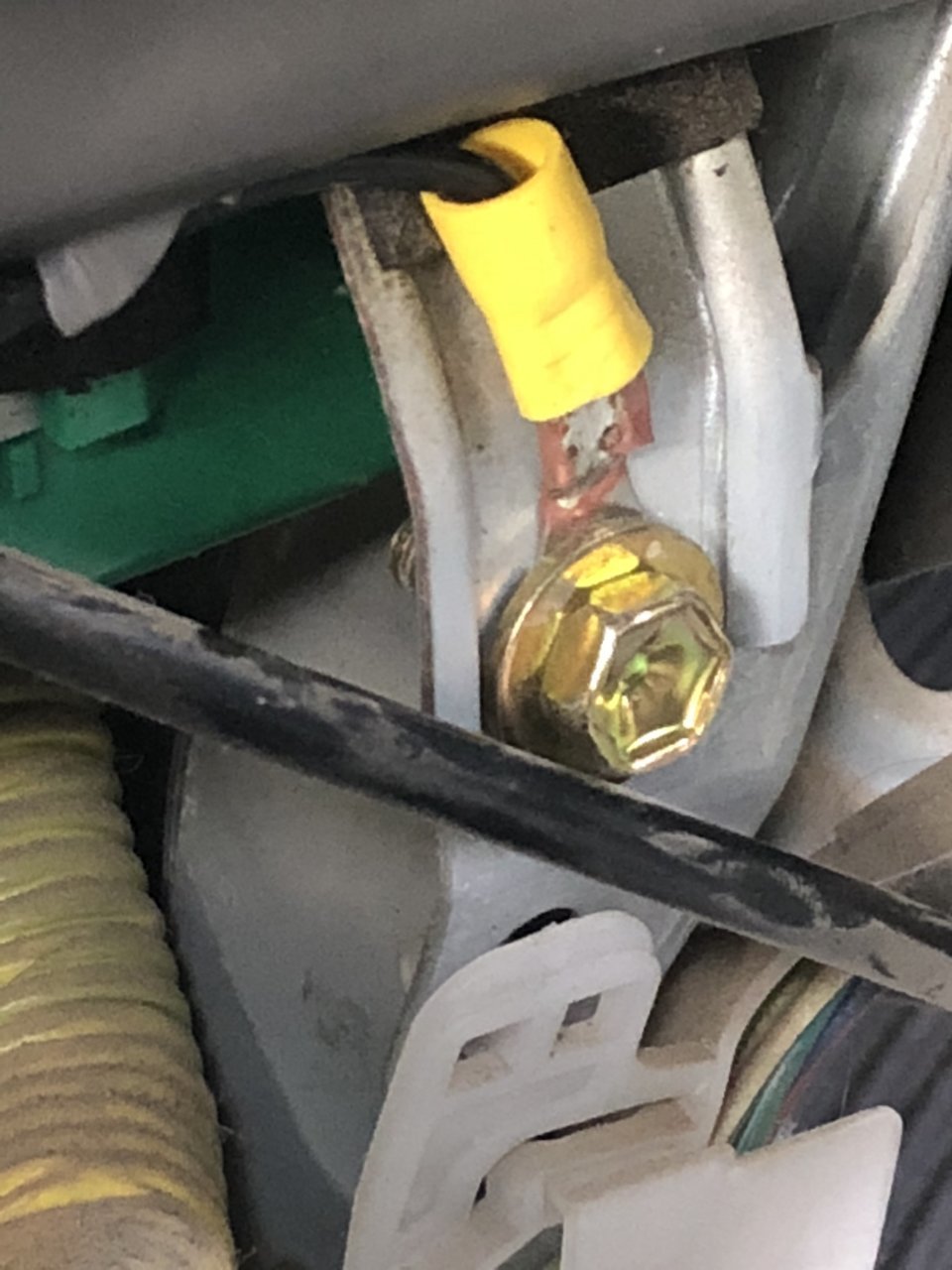

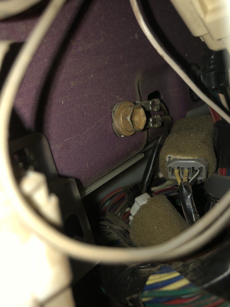

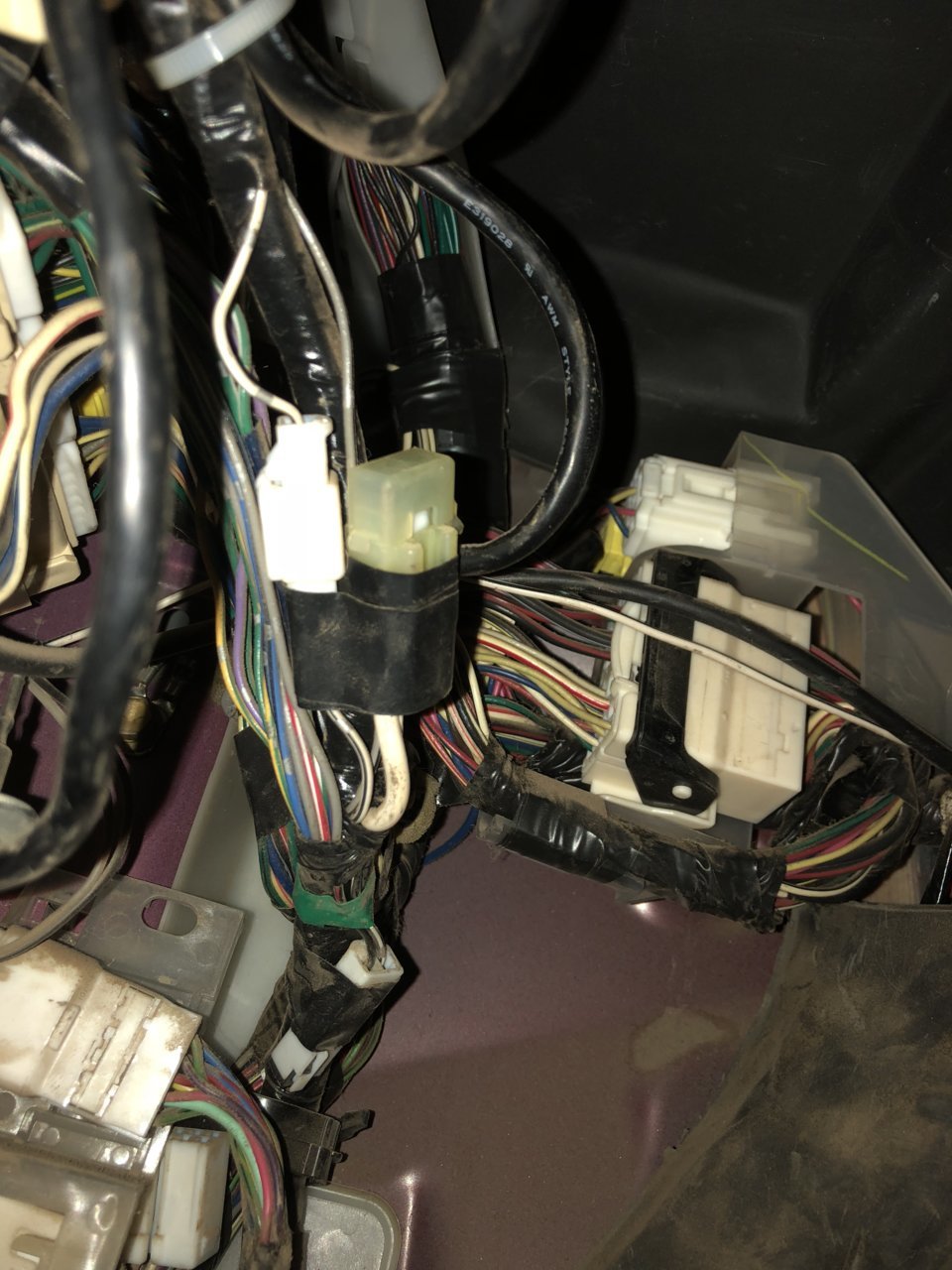

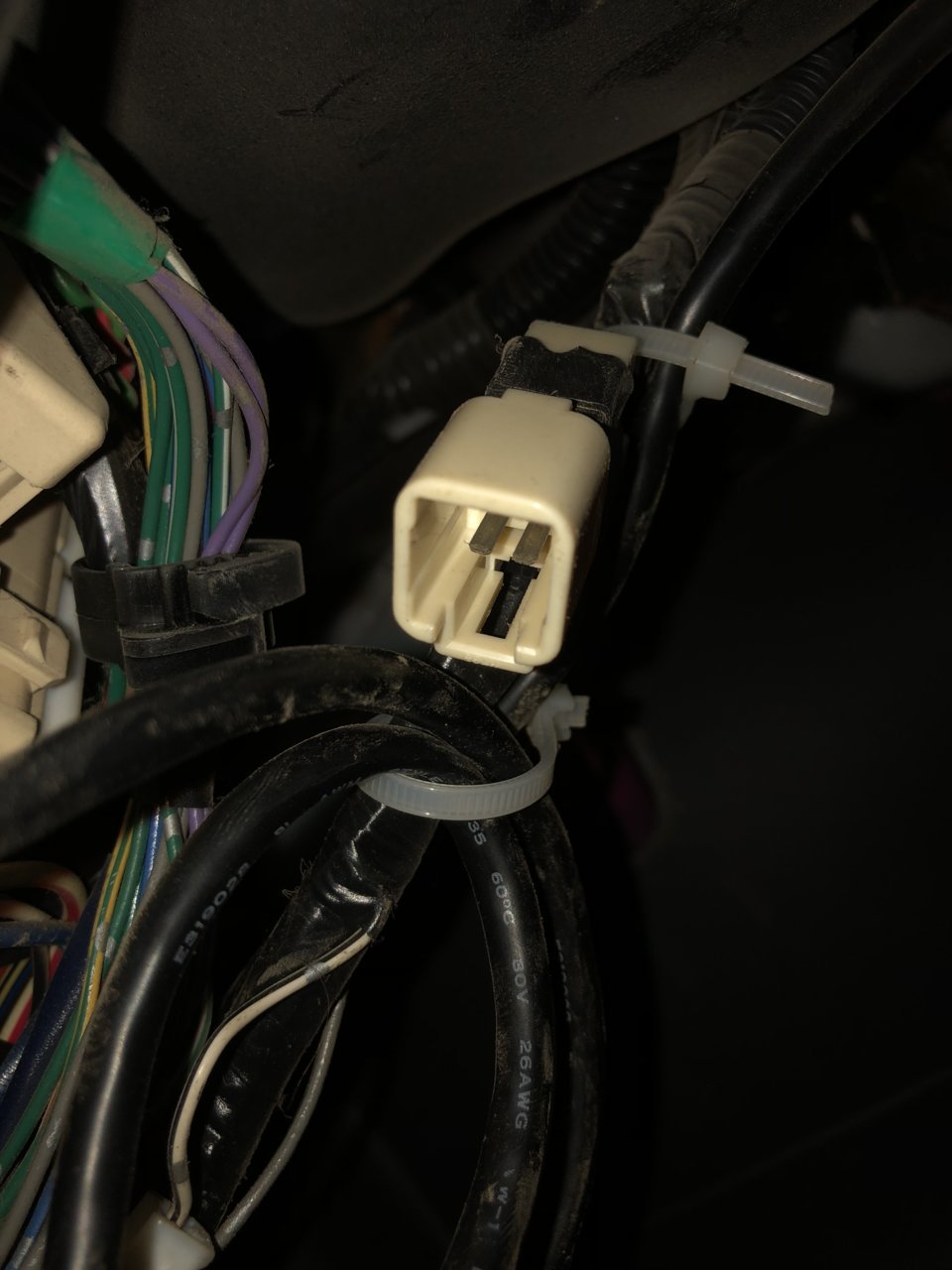

    4296646E-A9D2-4D50-86BD-28C9F9C25FFE.jpg CE53CF5C-2AC7-4AB4-9F5F-2A085B462F85.jpg F85D1C0B-3D98-4671-9D93-3A25A8B28164.jpg 5D175174-292E-4DF2-9C58-217804A02BF4.jpg Found two grounds to the side panels and they look fine. The taped up ground wires looked okay? Check the fuses mixed in with the wires and nothing popped... it is an absolute factory mess down there.
    Only thing is I found a clip with nothing attached on the other side? Think it was for the factory alarm which was replaced by previous owner
    Not sure what the next step is in finding out why this dang thing shuts off for no reason then pops back on

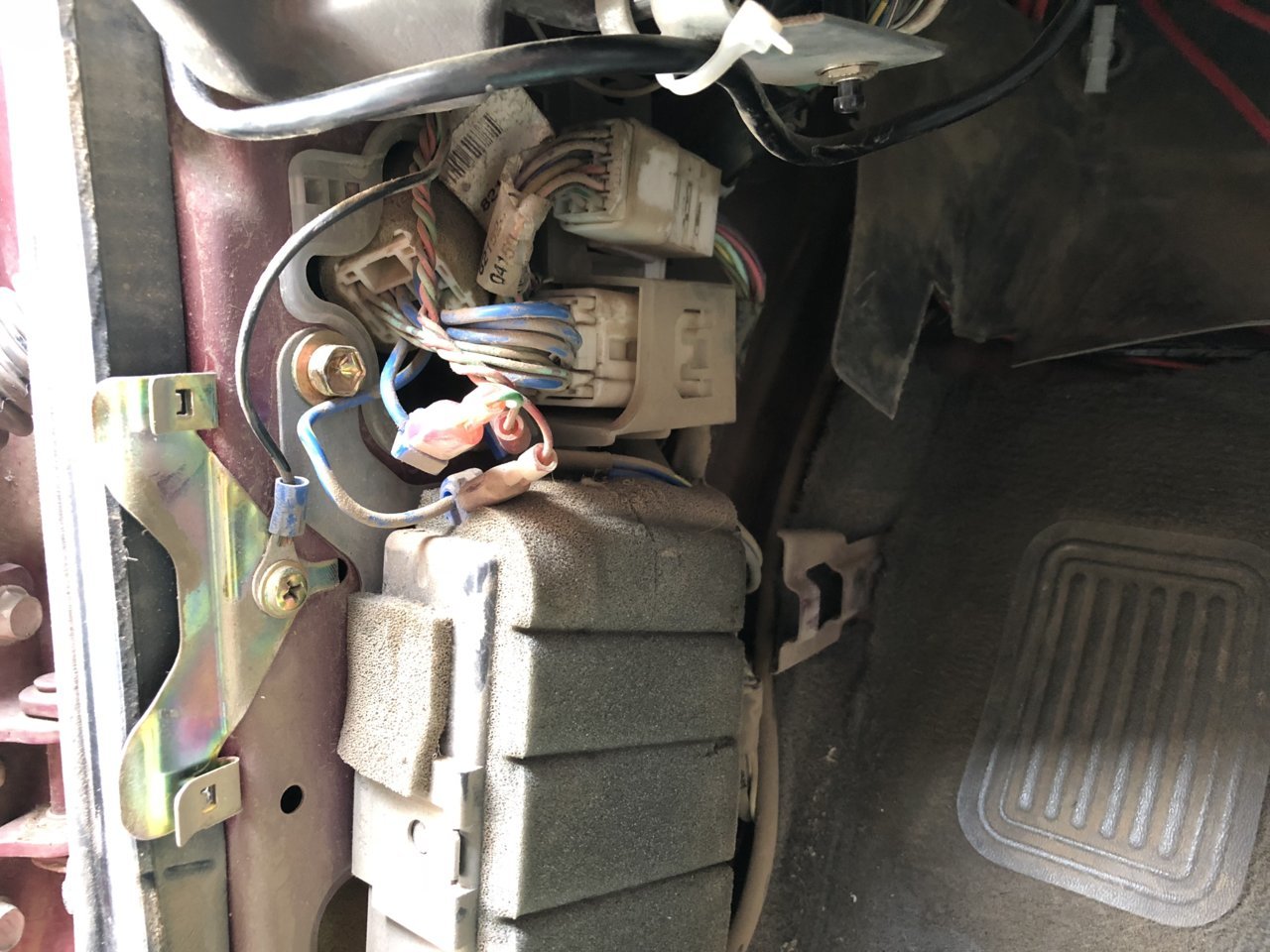

    New ground spliced into factory harness. Everything’s clean and should be a solid connection. End connection was also soldiered and about 12” away from headunit 1CFB9C4A-FC73-4722-B849-F3EF8CC9451C.jpg

    Looks great.
    That's why back to the basics. Wires from power source and see if you still have the problem. Then go fron there. If you feel the ground is sound :rimshot:, then it got to be the power if receiver is good.
