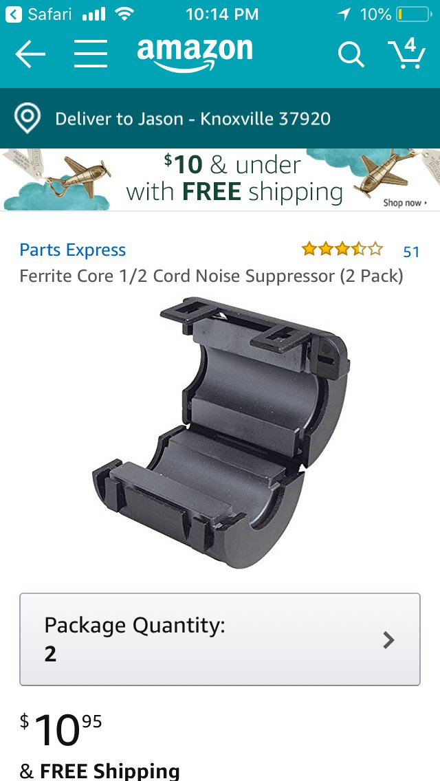

    Get a ferrite ring and wrap the power wires through it. The more wraps the better.
    Tennessee YODA[OP] likes this.

    Bull bar nilight light and light bar grill vision rims replacement grill aftermarket headlights
    This is what I got , is the a specific spot I should use it , before after relays , and just the power wires ?

    Aux back up lights, Bed lights, Re-located trailer plug, Good dooby, a.k.a. jumper cable mod, Heated seats, back up camera,
    Get that as close to the light bar as you can.
    Kk will do first thing tomorrow appreciate the help .
