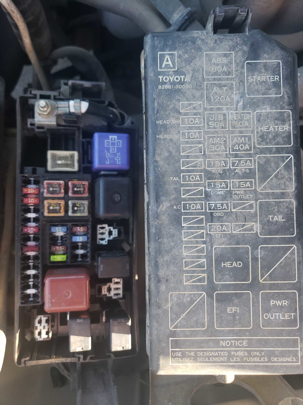

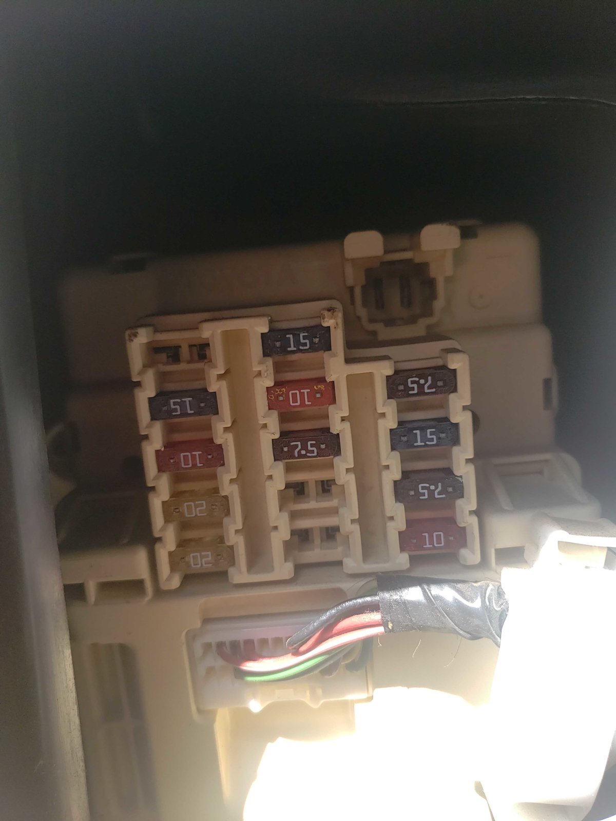

    I checked every fuse and they all seem to be fine. It was sitting a several days after I moved. I started using it again and to my shock the radio doesn't turn on or respond at all. I'm assuming it's a power issue but im not sure. Its a 2002 Toyota Tacoma 5spd manual SR5 Base 2.4L. I pulled every (small) fuse and they were ok. Now I noticed my clock and dome light doesn't work.
    The hell is going on?
    There should be 2 images. This is the first time I posed anything. There should be pics of the fuses. Thx guys.17176305020135037753564764469152.jpg 17176305298702742839115467842990.jpg 17176305499878285664659648423065.jpg

    clock, radio and dome lights i believe are typically all off the accessory circuit
    according to this:
    https://www.startmycar.com/toyota/tacoma/info/fusebox/2002
    in your underhood fuse box, it appears you might have misplaced a 15A fuse. from the top of your picture, and ignoring the left-column of fuses, while paying attention to the 'pairs' it should go:
    empty
    120A
    50A, 50A
    30A, 40A
    15A, 7.5A (left is fog lights, right is charging system)
    15A, 15A (left is for dome/radio/gauges, currently empty, right is for cigarette lighter port)
    7.5A, empty
    20A, empty

    Omg your absolutely right. I have no idea what happend to that fuse

    I have no idea where you getting 8 tracks from. It has a cd player and cassette player as its 2002. Doesn't have aux nor 8 track. The new fuse did fix the issue but my radio still doesn't work so im back at square on.
